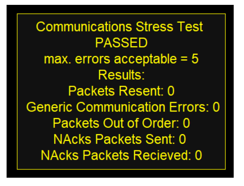

Ok, I think you have a few things confused here… So let’s set them straight:
The first image you show (the big block of text) that is actually a file you run to “stress test” your ethernet connection.
You would load that file like any other G code job and run it. It should produce results like this:
 ![image](https://canada1.discourse-cdn.com/flex027/uploads/avidcnc/original/2X/5/598b303c7d3f5460b856587c3c54d6d1b0b511bd.jpeg)
It looks like what you did here is just load the actual test file in a text editor to look at it.
If your controller does connect, but not reliably I would run this “stress test” properly and see what the results are.
The “report” you have posted here is just a report from your CNC12 software.
If things we’re working before and this happened something had to change on your setup.
If you haven’t tried already fully restart your computer AND the control box and see if it reconnects.
If it doesn’t re-run the PC tuner software and let it re-configure your PC and network card and see if that fixes it.
I would also inspect the ethernet cables themselves. Make sure they aren’t damaged. Make sure you are running the cable that WE provided you and not a third party cable. The cables we provide are shielded unlike most ethernet cables. Also make sure your PC is plugged directly into the controller and you’re not using a hub, splitter or switch.
If none of that works you may want to try a new ethernet adapter. I’ve had very good luck with these: [Amazon.com: TP-Link USB to Ethernet Adapter (UE306), Supports Nintendo Switch, Foldable USB 3.0 to Gigabit Ethernet LAN Network Adapter, Supports Windows, Linux, Apple MacBook OS 10.11 - 12(Driver Required) : Electronics](https://www.amazon.com/USB-Ethernet-Adapter-Gigabit-Switch/dp/B09GRL3VCN?sr=8-19)
I suspect what is going on here is very simple, we just need to figure out what it is.
If the above steps don’t solve your issue please open a support ticket with us and we’ll get you sorted out.
