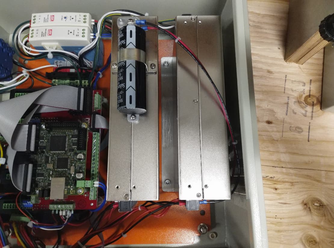

It appears that the instructions for the avid 5th drive upgrade show a different power supply than I have in my system, and include the installation of a capacitor that was not included in my kit. Has anyone here with my same model of machine installed the 5th drive upgrade? I believe I have revision 21.1, released in 2021.
I can wait until Monday for avid support to get back to me, but I was hoping to get my 4th axis running this weekend.
Here is how the control box looks in avids instructions:
 ![image](https://canada1.discourse-cdn.com/flex027/uploads/avidcnc/original/2X/3/303c39d146610c21cb671ef9032e6dc394014275.jpeg)
Here is my control box, note the different power supplies:
 ![image](https://canada1.discourse-cdn.com/flex027/uploads/avidcnc/original/2X/e/e96f58000a0428545b56190e738e9c16dbcb00dd.jpeg)
I am not sure where to put these wires from the motor drive’s phoenix connector:
 ![image](https://canada1.discourse-cdn.com/flex027/uploads/avidcnc/original/2X/f/fbfb0090b892dbe5ada320842172226528d01ef3.jpeg)
I am also not sure if the capacitor is a missing part or if that has been changed in the newer machine version.

The capacitor is unnecessary in newer versions. I believe those wires should go here with the others from your existing 4 drives:
 ![image](https://canada1.discourse-cdn.com/flex027/uploads/avidcnc/original/2X/a/a2accec45d7b8bb12bccdc955326b2c7a3757a45.jpeg)

Thanks, looks like you are correct.
 ![image](https://canada1.discourse-cdn.com/flex027/uploads/avidcnc/original/2X/6/6e5b41856afd56c8357a9dbf0bdc3202d5db06eb.png)
