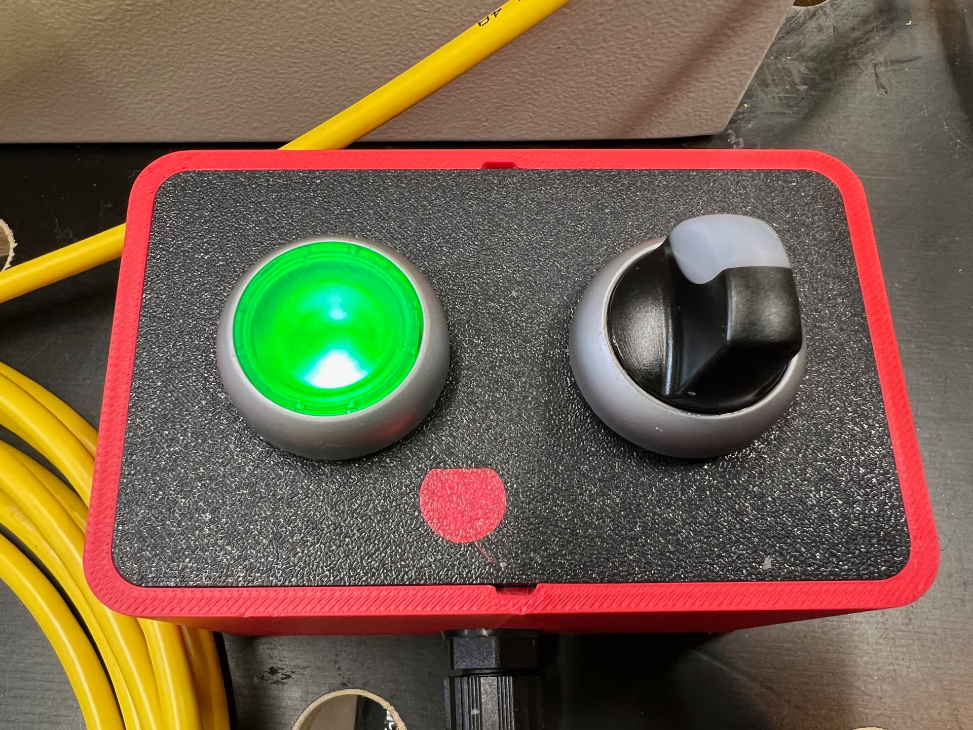

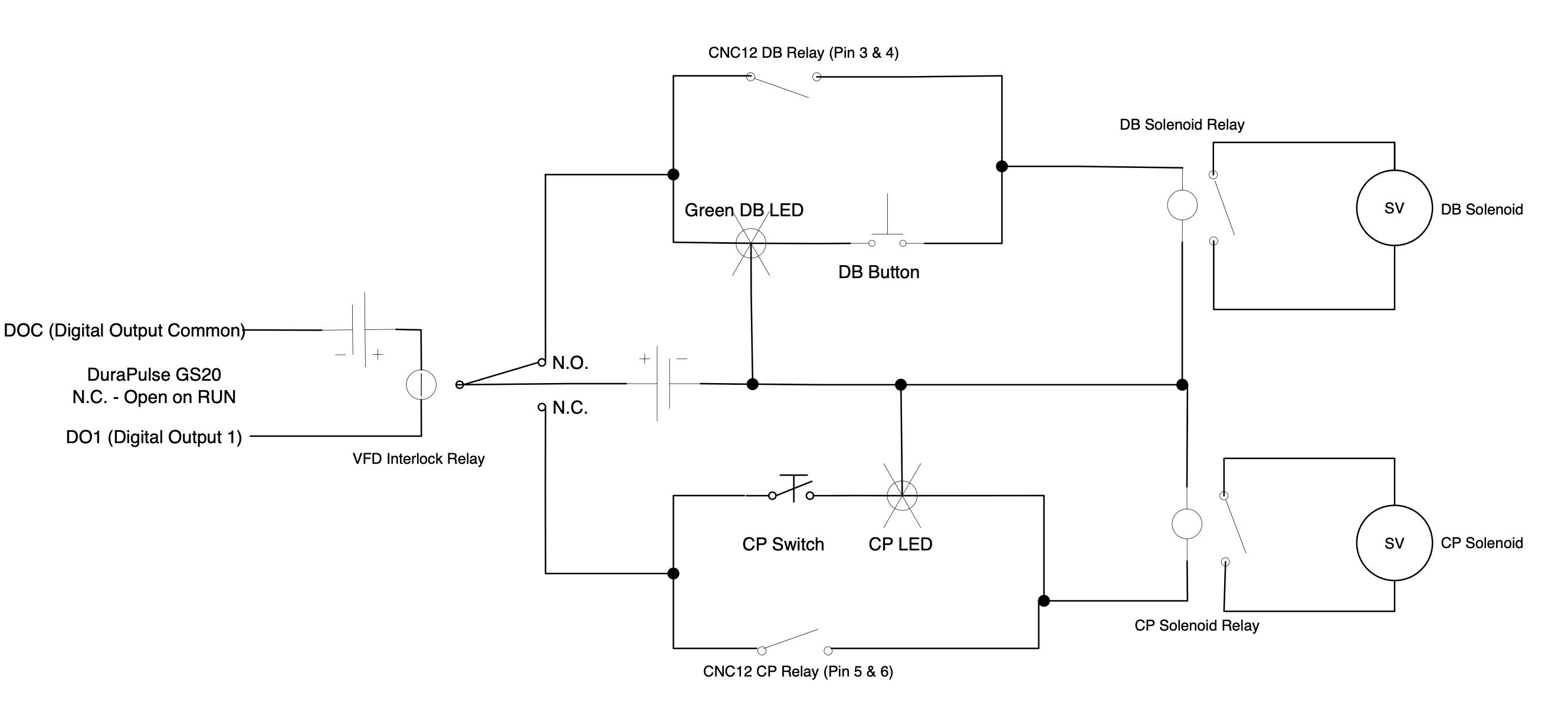

VFD Relay Wiring:
I set the VFD Digital Output 1 to be normally closed and open on RUN. I then wired it to a SPDT relay and did two things, I connected the manual draw bar button on the N.O. side of the relay, and connected the case pressure switch to the N.C. side of the relay.
When the VFD is on but not running, it will close the circuit activating the relay and enabling the draw bar button to be used. As soon as the VFD starts running, it will open the circuit, deactivating the relay and enabling the case pressure switch to be used.
I created a remote control box with a momentary push button and a maintained switch. And because I’m a huge fan of visual indicators, especially with the noise in the shop, I made sure to have appropriate indications for what is happening.
In this case, when the VFD is not running, it will close the N.O. circuit for the draw bar, causing the green light to illuminate, letting me know that I can push the button for a tool change. When the VFD is running the green light will go out and it will no longer be possible for me to do a tool change.
The opposite is true for the case pressure. When the VFD is running, it will allow the N.C. circuit to close and let me choose to turn on the case pressure. When I turn the case pressure switch, it will illuminate letting me know that the case pressure is on. When the VFD is stopped, it will disable the case pressure.

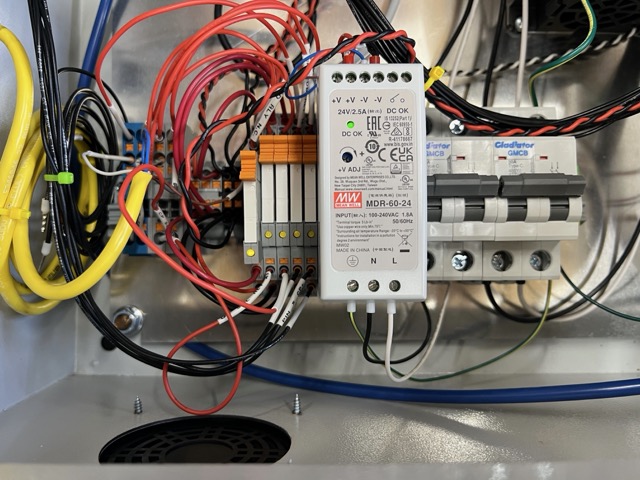

**Author:** ![MichaelR](https://avatars.discourse-cdn.com/v4/letter/m/6a8cbe/32.png) [@MichaelR](https://forum.avidcnc.com/u/MichaelR)\
**Post date:** [July 10, 2025, 6:03am UTC](https://forum.avidcnc.com/t/another-rm40c-cnc-depot-setup/4984/3 "2025-07-10T06:03:58Z")

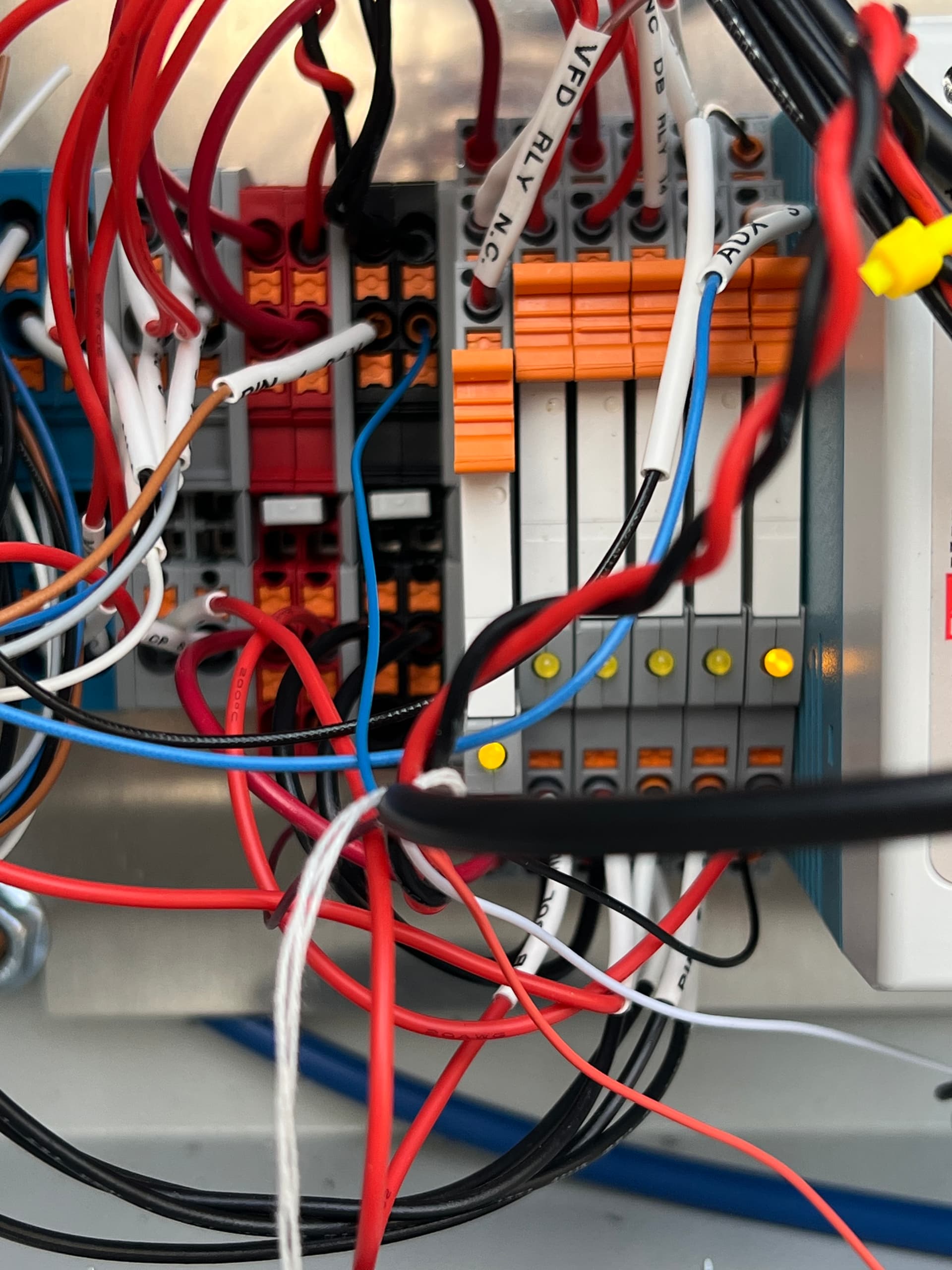

Spindle Control Wiring:
Here is a quick shot of the internal of the cabinet. What started out as only two relays 5V-\>24V to activate the draw bar solenoid and case pressure solenoid expanded in to 5 relays, 4 terminal blocks and 2 power distribution blocks.
 ![CabinetFull](https://canada1.discourse-cdn.com/flex027/uploads/avidcnc/original/2X/9/9b36ccb9a02fe12bb6064713d0fdf28a2340b5b7.jpeg)

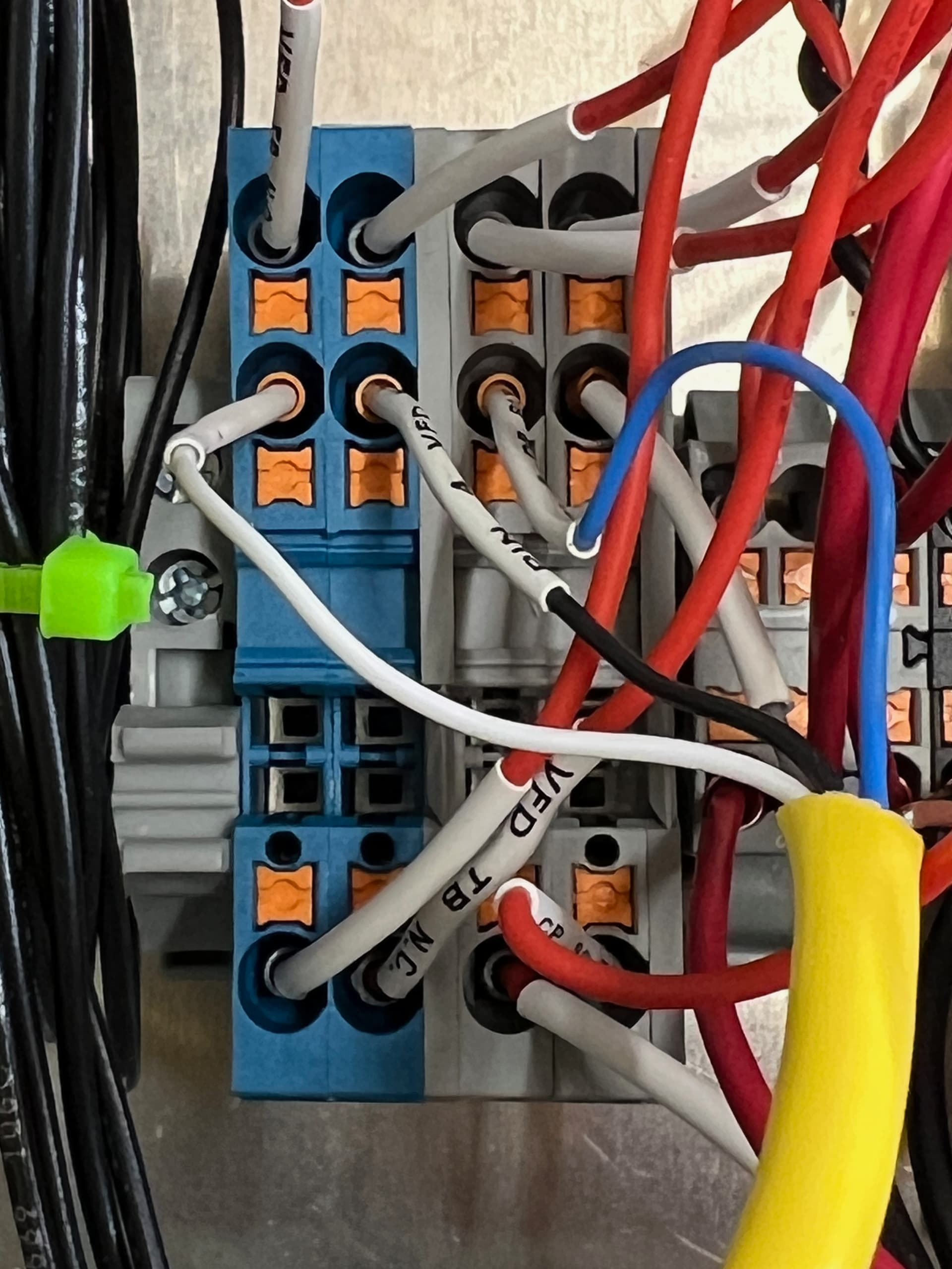

The blue and grey terminal blocks are where I split out and created parallel paths for integrating the external manual control box as well as allowing for the CNC12 to be able to call both. This way once I actually do the full ATC integration, I can still do manual tool changes, or manually turn on the case pressure if I desire, but also be able to have the CNC12 run all of it for me 🙂
 ![TerminalBlocks](https://canada1.discourse-cdn.com/flex027/uploads/avidcnc/original/2X/5/56d6a546238695a86b277ab4612aa95f29e6c063.jpeg)

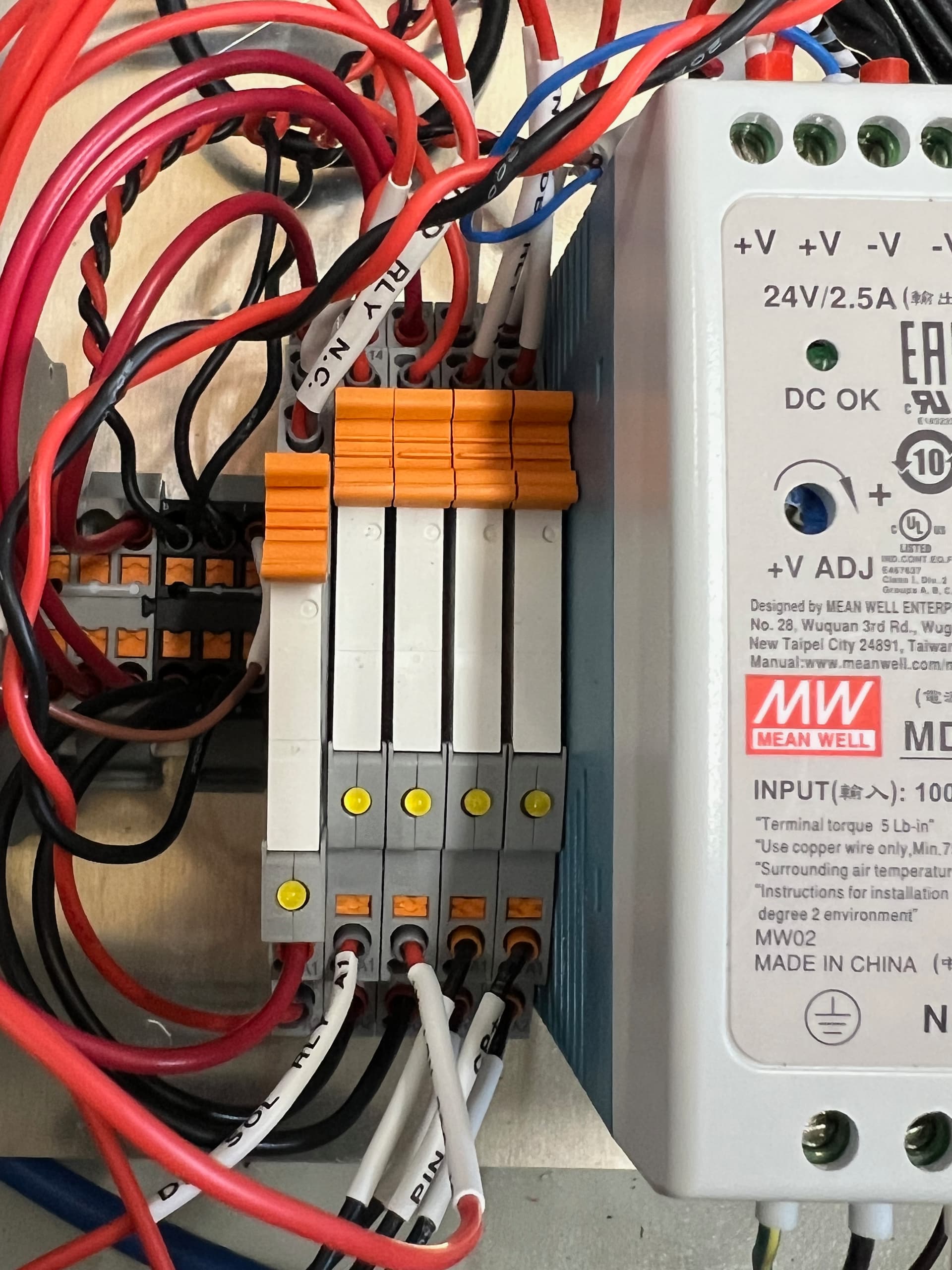

All the magic is happening here in the relays. The left most relay is the SPDT relay for handling the VFD interlock. This is what allows me to activate the the draw bar when the spindle isn’t running, or turn on the case pressure when the spindle is running. The middle two relays are SPST and are for the draw bar and case pressure solenoids. The combination of the terminal blocks and the VFD relay determines which of these relays activate to turn on one of the two solenoids. Lastly, the right most relays allow for electrical separation between the CNC12 and spindle control boxes and support the integration. When it comes time I can connect the pins on the other side of the 14 Pin cable to allow the CNC12 to do all the work for me.
 ![Relays](https://canada1.discourse-cdn.com/flex027/uploads/avidcnc/original/2X/d/dbee2ae6ddfdfa2063373b6c1cdd96394f70dd11.jpeg)
Again, I really appreciate Eric’s time to help nudge me in some good directions and the pieces of knowledge that I picked up from some of the other forum members, especially Corbin!

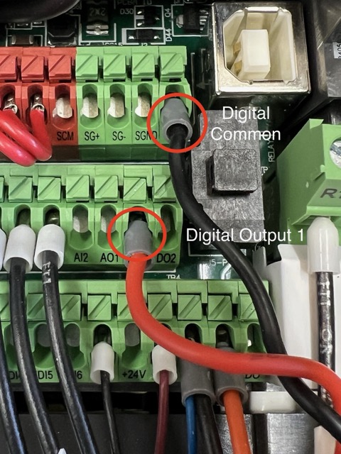

**Post date:** [July 10, 2025, 5:58pm UTC](https://forum.avidcnc.com/t/another-rm40c-cnc-depot-setup/4984/6 "2025-07-10T17:58:12Z")
@Corbin - I’m using one of the Digital Outputs on the GS20. And then the GS20 relay sends the VFD ready to the CNC12. What kind of VFD do you have? Does it not have any digital outputs at all or just the single combined relay/DO?
 ![VFDInterlock](https://canada1.discourse-cdn.com/flex027/uploads/avidcnc/original/2X/f/fc92f66fed71bbeda8a85358df43e7ff9aba817d.jpeg)

Oh wait – I do think I understand it right after looking at your wiring diagram. The VFD interlock relay would activate on RUN. I definitely want to add this in like how you have it, and just turn my case pressurization on when the VFD is set to RUN (currently I use Avid’s Relay 2 for this).
**Post date:** [July 10, 2025, 8:11pm UTC](https://forum.avidcnc.com/t/another-rm40c-cnc-depot-setup/4984/9 "2025-07-10T20:11:33Z")
> Use your VFD’s Relay as a pilot relay to drive an external relay with more contacts. I used to be a controls/software engineer and this was a very common practice to use to overcome a lack of outputs on a PLC or other devices.
I think I misunderstood how the Digital Output signal could be used; I thought I only could use provided Relay Output directly on the VFD, which is setup only for errors. I thought I had to read the digital output signal and interpret it…but it looks like I can use it to directly drive the relay.
**Post date:** [July 10, 2025, 8:47pm UTC](https://forum.avidcnc.com/t/another-rm40c-cnc-depot-setup/4984/10 "2025-07-10T20:47:51Z")
@corbin -
P02.16 - 1 (Indication during RUN)
P02.18 - Bit 3 set to 1 for N.C. - Basically add 8 to whatever this value is currently assuming the value is under 7 - I used N.C. as a safety. If the wire is broken or whatever then the DB relay will be in the open position and you can’t accidentally open the draw bar due to a failure while the spindle is running.
DOC directly connected to 24V-
DO1 connected to A2 on SPDT relay
SPDT relay A1 connected to 24V+
Then I use the N.O. for the draw bar. When the spindle isn’t in Run, it closes the VFD digital output which then closes the N.O.
output on the relay allowing the DB relay/solenoid to be activated.
I use the N.C. on the relay for case pressure. When the spindle is running, it opens the digital output which opens the N.O. output disabling the draw bar, but the N.C. output goes back to closed enabling the case pressure.
Make sure the SPDT relay has input protection. Most of the relays I looked at have an integrated freewheeling diode.

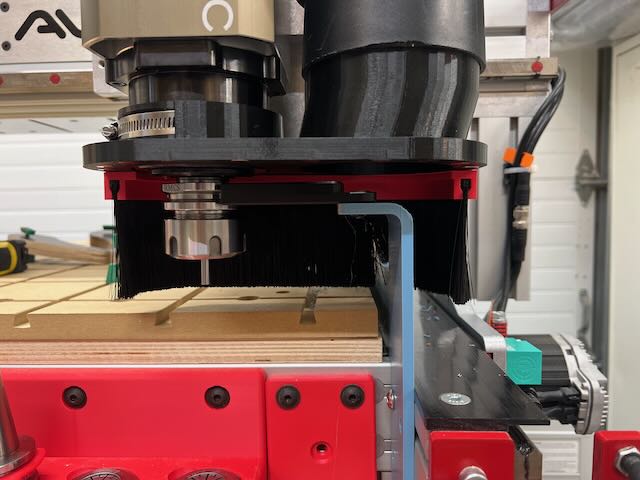

**Post date:** [July 30, 2025, 2:13pm UTC](https://forum.avidcnc.com/t/another-rm40c-cnc-depot-setup/4984/13 "2025-07-30T14:13:41Z")

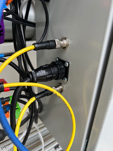

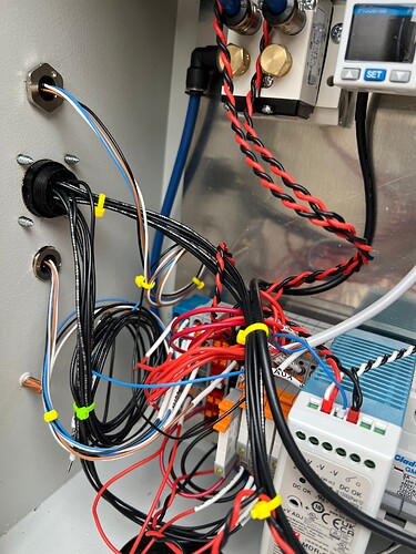

So… I ran into an annoyance.
The air pressure sensor feeds into the VFD and if it’s low it causes an emergency stop on the VFD which can only be reset by power cycling the box or opening the box and resetting the error.
Given where I have my control boxes, this is super inconvenient if I forget to start up the air compressor or I power the spindle control box too soon before the air pressure comes up to 90PSI.
So I decided to add a new M12 and relay and have the pressure monitor feed the status over to the EX controller. I still have it configured to stop on low air, but it’s way easier to reset if I forget something.

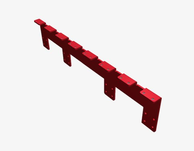

**Post date:** [July 31, 2025, 4:06am UTC](https://forum.avidcnc.com/t/another-rm40c-cnc-depot-setup/4984/15 "2025-07-31T04:06:35Z")
I’m super happy with the spindle in general. It’s so quiet and such a piece of cake to swap tools.

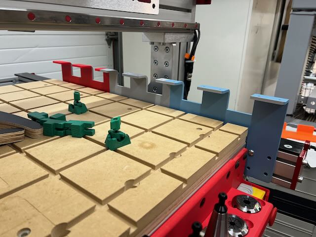

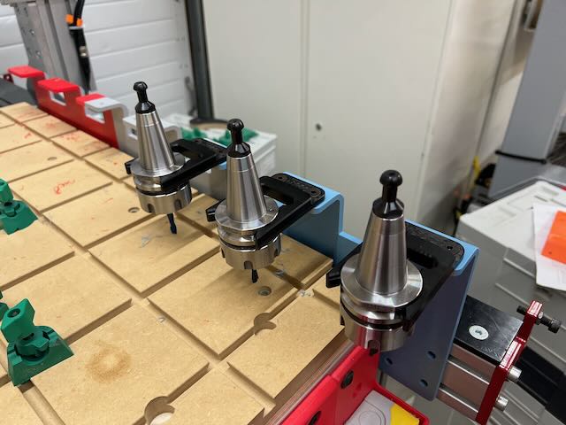

Now I’m struggling with waiting until AVID comes out with their pneumatic tool rack or putting in my own rack.
For grins I modeled up a rack in fusion and did a 3D printed mock up. I already have it in my SendCutSend account, but I’ve been hesitant to pull the trigger yet waiting to see what AVID is going to do.

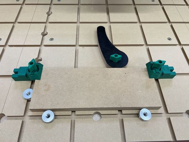

**Post date:** [July 31, 2025, 10:59am UTC](https://forum.avidcnc.com/t/another-rm40c-cnc-depot-setup/4984/17 "2025-07-31T10:59:22Z")
How do you like that Microjig setup spoilboard? Im on the verge of getting rid of my T-track and doing the same thing. I have all the stuff, just need time.
**Post date:** [July 31, 2025, 4:12pm UTC](https://forum.avidcnc.com/t/another-rm40c-cnc-depot-setup/4984/18 "2025-07-31T16:12:18Z")
I went back and forth on a lot of spoil board options and finally decided on this one because it’s easy to make my own clamping tooling, it’s quick to remake it once I’ve destroyed it, and I can have Home Depot precut what I need and throw it in the car to bring it home.
My AVID is 5’ wide and 3’ deep. I have a 60x30 sheet of 18mm baltic birch as a base with threaded inserts on the underside. I then have HomeDepot cut a 4x8 sheet of 3/4 MDF into 4@ 2x4 sheets, I cut them on my saw to 30x20 and screw them into the BB base. From there I have a set of operations that I run to cut dog holes, make the relief cuts for the dovetail bit and cut in the dovetails. Including the time that it takes me to go to Home Depot I can have a new spoil board ready in less than 2 hours.
Just as an example, here’s a home made cam clamp with MicroJig hardware, combined with two of their hold downs and some bench dogs.
