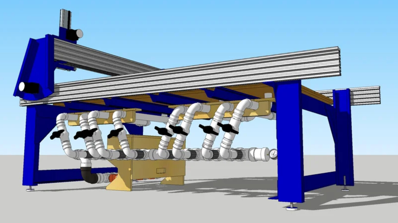

**Post date:** [October 16, 2025, 8:50pm UTC](https://forum.avidcnc.com/t/avid-good-for-processing-sheet-goods-need-atc-need-vacuum-table/4258/12 "2025-10-16T20:50:12Z")
I made a vacuum table back in the day using similar motors:
 ![image](https://canada1.discourse-cdn.com/flex027/uploads/avidcnc/original/2X/a/a69ac2eef731a5b6f94ceac6666c707c93df13f6.jpeg)
That was an 8 zone table on a 4x8 machine. I ended up getting the black box because I had a motor fail (And spark) in that wooden box I made. The Black Boxes are all metal which is nice.
