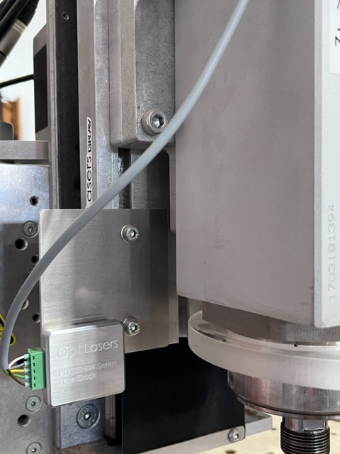

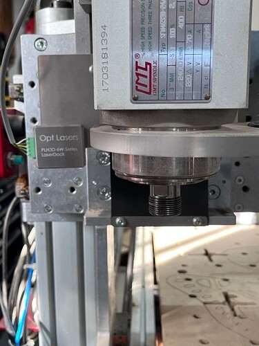

I recently added a 6W Opt laser to my PRO4848. I think the 15W version is designed to replace the spindle. I machined a simple bracket to mount the 6W adjacent to the spindle. Still working through the laser material settings but I think I have the post-processor worked out. I am also using UCCNC with an added CNCdrive UC300ETH motion controller. Happy with the laser so far. Size will ultimately depend on what materials you expect to engrave/cut.
 ![front-dock](https://canada1.discourse-cdn.com/flex027/uploads/avidcnc/original/2X/e/e3564fd12f4c034539850780a8192c7289f0ac44.jpeg)
 ![front-laser](https://canada1.discourse-cdn.com/flex027/uploads/avidcnc/original/2X/0/09ce8f91d3c089331183c42f1b3ce7e5cd8bcb70.jpeg)
 ![side-dock](https://canada1.discourse-cdn.com/flex027/uploads/avidcnc/original/2X/d/d8b65dbebfc55da20e939bcf6408b5f95fddcac0.jpeg)
 ![side-laser](https://canada1.discourse-cdn.com/flex027/uploads/avidcnc/original/2X/5/598228d7d3bfd4f370ca405ba625224954db558e.jpeg)
**Post date:** [February 11, 2023, 7:47pm UTC](https://forum.avidcnc.com/t/avid-opt-laser-or-dedicated-laser-setup/1648/15 "2023-02-11T19:47:01Z")
That looks great. What are you intending to make with it it? Also, did you order it from them direct (international?) or did you find a distributor located here stateside?
-Kenneth
**Author:** ![Samarah](https://yyz1.discourse-cdn.com/flex027/user_avatar/forum.avidcnc.com/samarah/32/1276_2.png) [@Samarah](https://forum.avidcnc.com/u/Samarah)\
**Post date:** [February 11, 2023, 8:09pm UTC](https://forum.avidcnc.com/t/avid-opt-laser-or-dedicated-laser-setup/1648/16 "2023-02-11T20:09:56Z")
I plan to engrave and cut mostly wood, but I’m sure I’ll try different materials as well.
I ordered direct from Opt. Shipping was quick. The biggest issue was FedEx custom clearance. It was held because of the radiation-emitting designation. That added probably a week. Mostly because the FedEx rep was not very responsive. If you go with Opt, I recommend the dock. I ordered the AvidCNC upgrade kit. They had a special that included the air-assist kit free at that time.
Good luck.

**Author:** ![grossmsj](https://yyz1.discourse-cdn.com/flex027/user_avatar/forum.avidcnc.com/grossmsj/32/4903_2.png) [@grossmsj](https://forum.avidcnc.com/u/grossmsj)\
**Post date:** [October 11, 2023, 5:37pm UTC](https://forum.avidcnc.com/t/avid-opt-laser-or-dedicated-laser-setup/1648/19 "2023-10-11T17:37:09Z")
Looking at what you did, it looks like you machine a piece of aluminum that has the bolt hole pattern for the OPT magnetic mount on one side, and a couple holes to fit the slot on the spindle mount. Is that correct?
