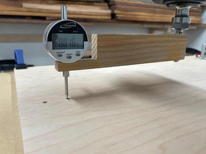

### Author: ![Jaybird64](https://yyz1.discourse-cdn.com/flex027/user_avatar/forum.avidcnc.com/jaybird64/32/4973_2.png) [@Jaybird64](https://forum.avidcnc.com/u/Jaybird64)
#### Post date: [May 19, 2025, 1:38am UTC](https://forum.avidcnc.com/t/conceptual-gd-t-spindle-setup-set-it-and-forget-it-use-tramming-as-a-final-check-only/4766/5 "2025-05-19T01:38:08Z")
I’m well aware about the traditional method. I don’t have this dual dial indicator, but I had a single digital indicator that I used with a jig I created and I got it pretty close. However, when I tram in the Y-axis, the right side is a little deeper than the left side. I still have a little adjusting to do before I feel comfortable creating my spoilboard.
My indicator is set 9" from the spindle. I used it for my drill press to set the table level years ago and reused it for this purpose. My test board was .06" off on the right side but I got it down to .016" in a span of 18", so far. Not sure how close it should be but I think between .005-.010 for my purpose might suffice.
 ![IMG_8404](https://canada1.discourse-cdn.com/flex027/uploads/avidcnc/original/2X/a/ae4e95a407569d8e3ed1eae223ae5f268c68b81d.jpeg)
Just for a sanity check, I used my digital cube on the vertical side of the spindle tramming plate and even though is shows 0 deg, obviously the spindle itself is off.
 ![IMG_8405](https://canada1.discourse-cdn.com/flex027/uploads/avidcnc/original/2X/4/42f730b2d17ffcd6feae34f8c0c27d1ab3288e89.jpeg)
> [@sehast](#):
> A beefer jig that some how holds the spindle firmly in place while the spindle bolts are tightened might also work but I don’t think you can just count on the weight of the spindle to do it.
It doesn’t have to be any beefier to hold the spindle. The tensile strength of the rod itself is more than enough to hold and balance the spindle, even if it wasn’t attached to anything.
