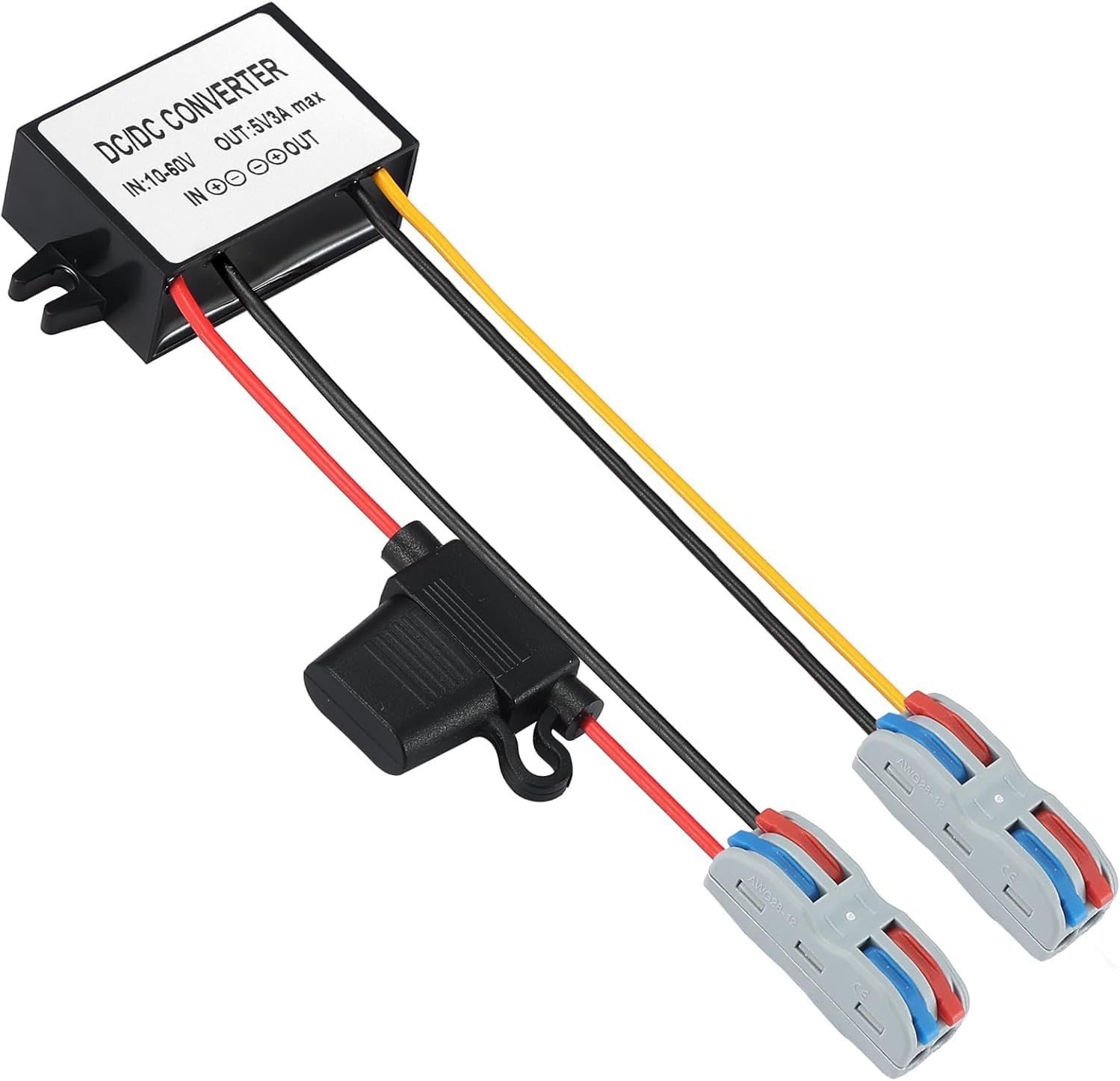

Here’s the inexpensive buck converter I was looking at, based on the step-down voltage requirements of 24V output to the laser device which operates at 3-6V DC. Just making sure it will work before I hit the buy button.
> **[Amazon.com: YABOANG 10-60V to 5V DC/DC Buck Converter, 12/24/36/48/60V 5V3A 15W...](https://www.amazon.com/YABOANG-Converter-Voltage-Transformer-Waterproof/dp/B0DQPG771W)**
> 10-60V to 5V 3A 15W DC Voltage Converter Product parametersInput range: 10-60VRated input voltage: 12V/24V/36V/48V/60Vtransfer efficiency: 95%input line: 15-16CM (R+ B-)output voltage: 5Voutput: 3A MAXMaximum output: 15W MAXNo-load adjustment rate:...

**Post date:** [October 11, 2025, 2:01am UTC](https://forum.avidcnc.com/t/ex-controller-free-5v-dc-power-source/5315/11 "2025-10-11T02:01:44Z")
> [@BlueLineCNC](#):
should work.
