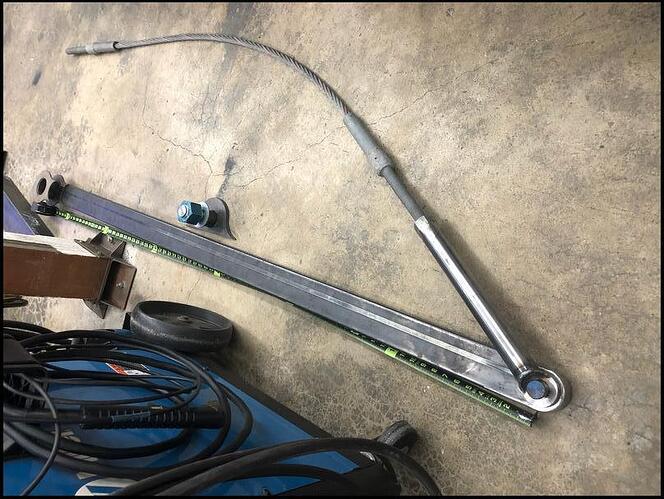

One of my neighbors wanted to make a floating retractable staircase/drawbridge. This was a bigger project that he planned / gathered materials for and worked on, off-and-on over a couple years. A handful of times he showed up with various pieces of material, plate and structural steel to CAD up and cut on the AVIDcnc plasma table. Some parts came along with an oral description of what shape he wanted and other parts came with cardboard cutouts to describe the shape.
Because some of this work had to be designed around existing materials saved from scrap bins over the years, there were a good number of layout steps to check / re-check along the way. It isn’t like we were going to just go replace 1&1/4 braided stainless steel cable with these kinds of end buckle terminations installed. 🤣

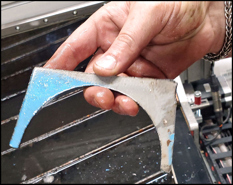

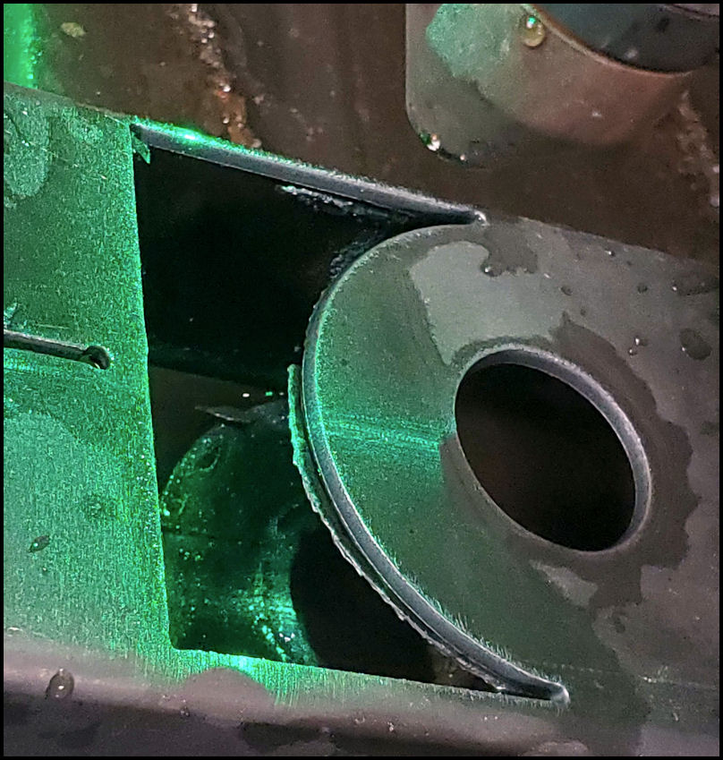

Some of these parts we nested together a bit to fit the various small ends and pieces of steel we had available to us. This material was recycled out of an old assembly. We had to take an angle grinder to get though the paint to ensure ohmic touch off in a few places. The dual laser line generator / cross hair system allows one to dry-run and ensure everything is going to fit, or drive right down, just inside the edge of a piece of steel.
 ![q20200904_233344](https://canada1.discourse-cdn.com/flex027/uploads/avidcnc/original/2X/f/ff081dc63af9fc12bc306bf843b75699877e2664.jpeg)
 ![q20200904_233758](https://canada1.discourse-cdn.com/flex027/uploads/avidcnc/original/1X/d33c2bcd73201089bb94bb54ba4b89190bfe7b75.jpeg)
 ![q20200904_235157](https://canada1.discourse-cdn.com/flex027/uploads/avidcnc/original/2X/c/c0b2aad0d479559cf03e3e97adbf8682050f2e43.jpeg)
These parts are 3/16in thick. I’ve cut slits into material that I needed to bend around an odd sized curve on a few different projects. It works pretty well and can add an interesting visual dynamic, or the slits can easily be welded up afterward. In this case we went with over-sized slits for the look.
