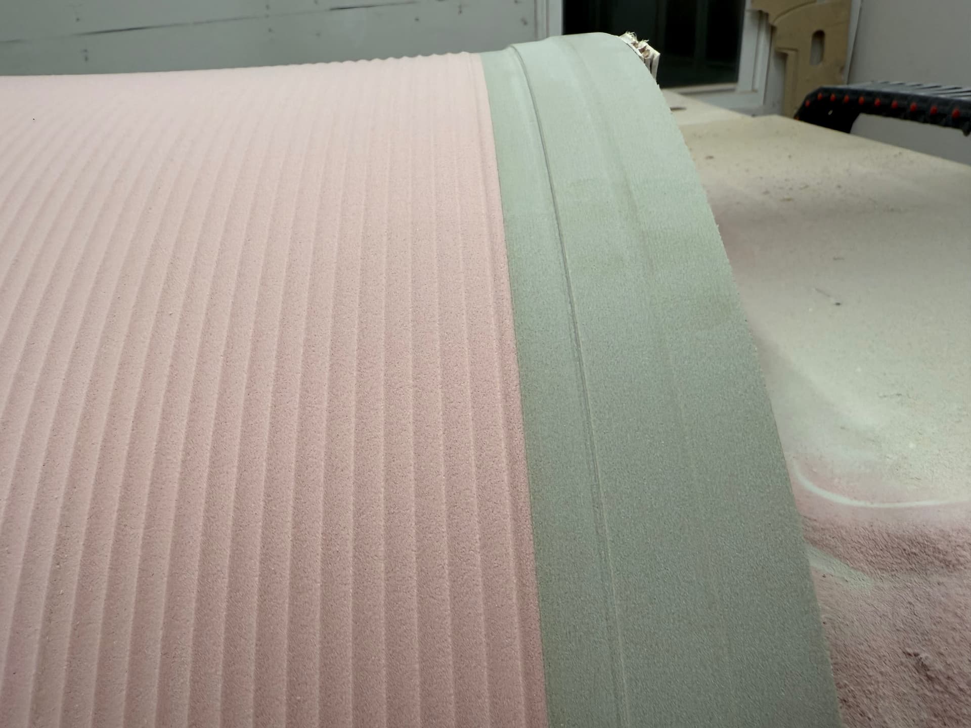

**Author:** ![greg.obj](https://yyz1.discourse-cdn.com/flex027/user_avatar/forum.avidcnc.com/greg.obj/32/2807_2.png) [@greg.obj](https://forum.avidcnc.com/u/greg.obj)\
**Post date:** [May 27, 2025, 7:04pm UTC](https://forum.avidcnc.com/t/jerky-rotary-axis/4800/25 "2025-05-27T19:04:12Z")
I have also noticed that parallel finishing passes on these bowls are slightly more accurate when cutting along X vs around A. Not sure why this is, might be the same thing you are seeing.
I also use cnc12 and fusion and run them in “precision router” as this pattern ends up with stair-stepping in the valleys with the less precise smoothing modes.
 ![image](https://canada1.discourse-cdn.com/flex027/uploads/avidcnc/original/2X/7/7097db62002ef01ab98ca887f35d1e1a9eae0482.jpeg)
