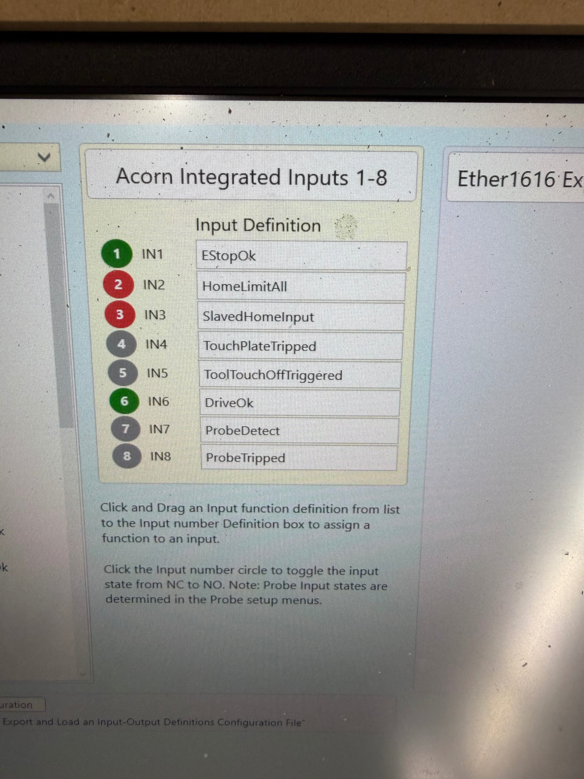

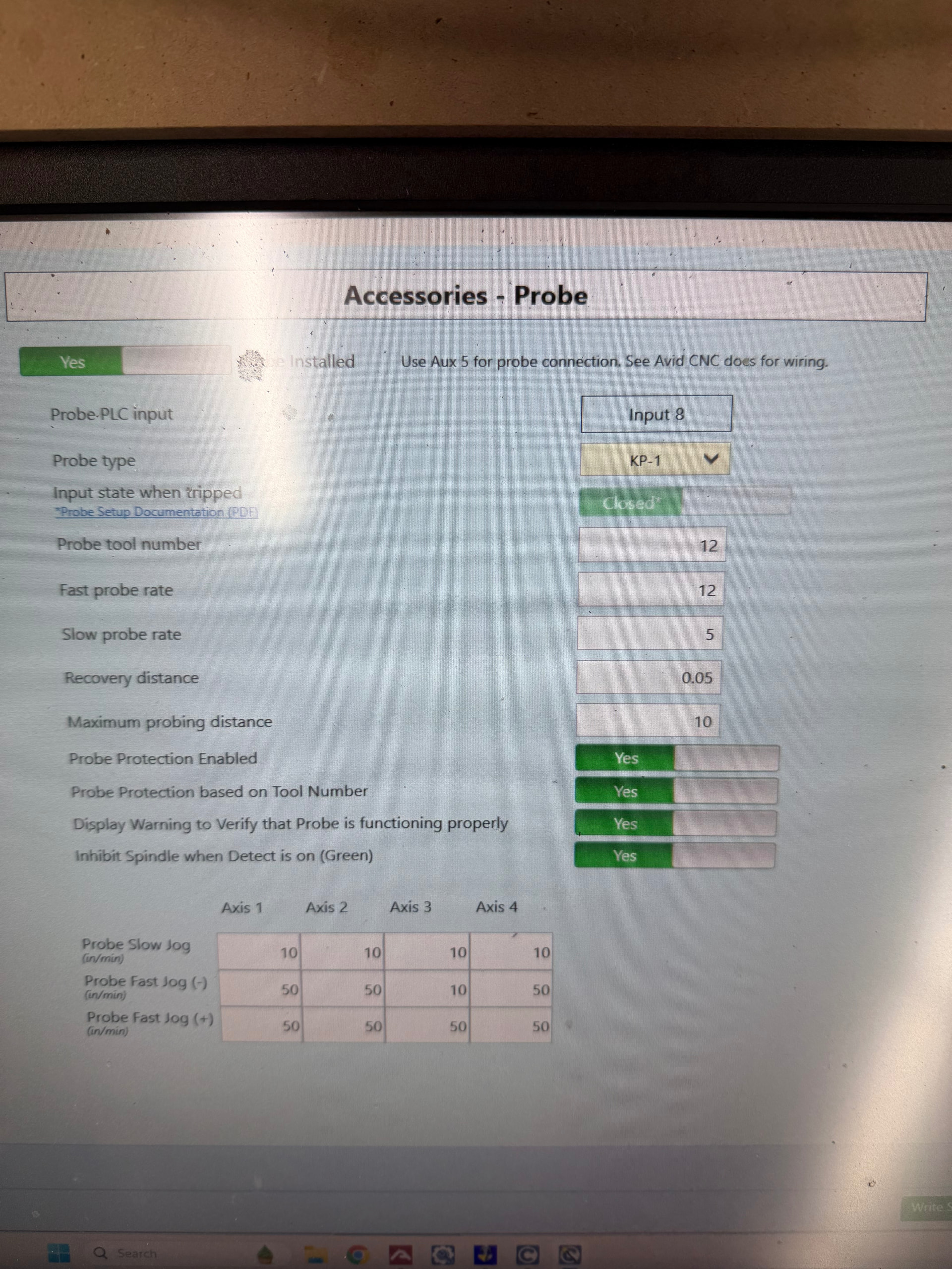

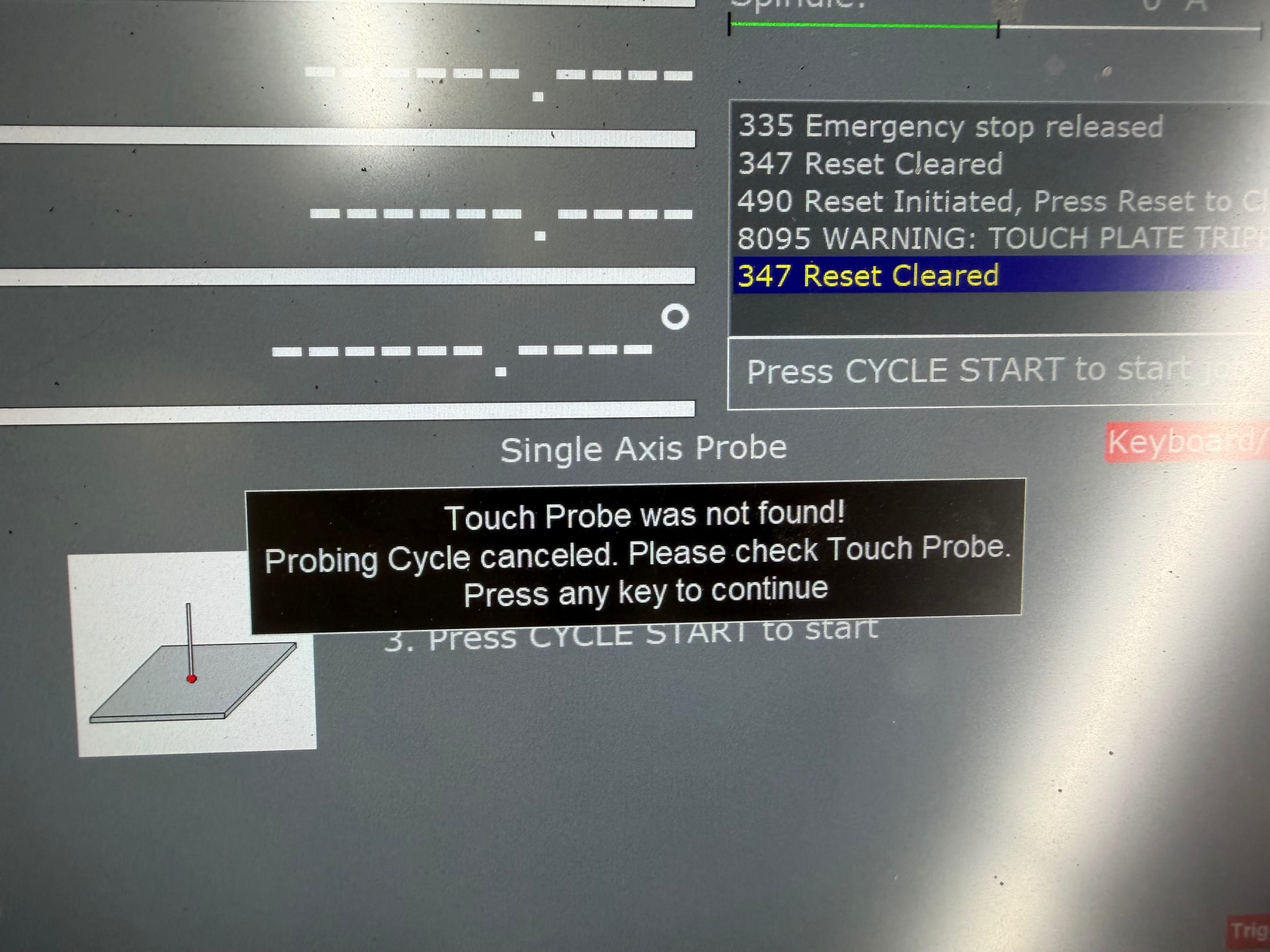

I’ve just purchased a KP-1 probe from Centroid and I’m trying to set it up (unsuccessfully, so far). It appears to be working correctly, illuminates green and red when tripped. I have gone over the wiring a few times and it looks in order, but when I try to run a probe, it states “Touch Probe not found”. Can anyone, kindly, help sort out my whatever my issue is? I’m almost certain I’ve done something dumb (as usual). Thanks so much, as always!

\*Brown should read “1 Brown in 24IN H1”

\*Screen shot when manually triggering probe

\*Screen shot when running a probe cycle

You you press Alt I from the main screen? This will bring up the PLC diagnostic. You can see what your inputs are doing.
With it up look at input 7 and 8 and see how they behave when you unplug, plug in, and trip the probe.

Input 7 is red , Output 7 is green, and 8 is green when the probe is left alone. When triggered, input 7 goes green, output 7 remains green, Input 8 remains green and Output 8 remains red.

Sounds like you have the wiring for input 7 and 8 reversed.
“Probe detect” is supposed to detect when the probe is plugged in, and “probe tripped” is only suppose to be lit up when you trigger the probe stylus.
What should be happening is that input 8 should be triggering when you touch that stylus. So you can either reverse your wiring or reveres the inputs in the Wizard… up to you.

Swapping the wires solved the issue. Thanks for your help, it is much appreciated.

You’ll want to use input 8 for the probe tripped, and optionally 7 for probe detect.
You configure the probe in the wizard on the advanced side just like they show in the Centroid probe instructions:
