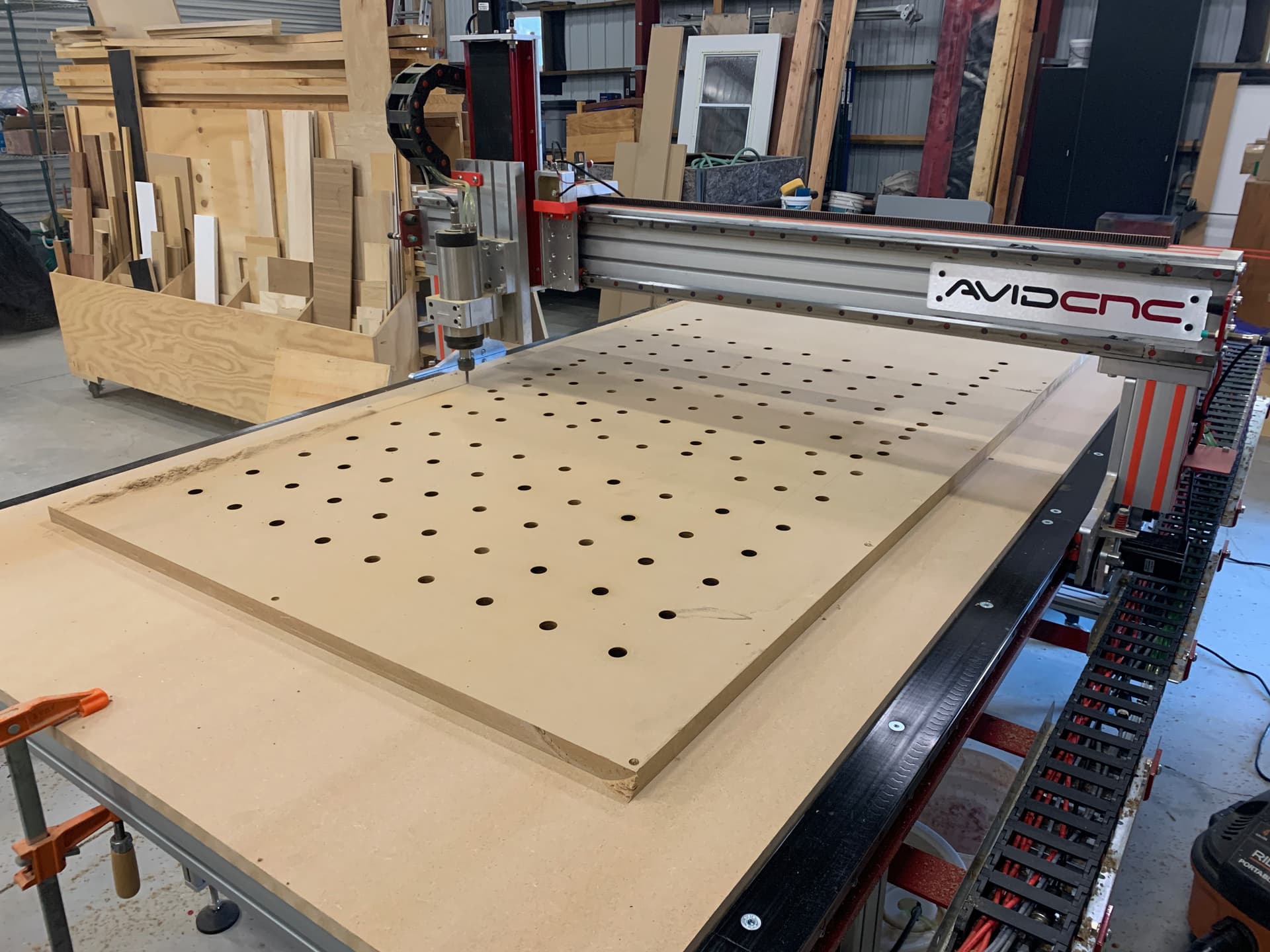

As promised to @Corbin , here are pictures of the track saw cutting table that I now use for large sheets.
Not my idea! Inspired by [SauterShop Vario](https://www.sautershop.com/vario-bench-mft-with-pro-base-set-vb-pro2.0), but while theirs is sized to replace a Festool MFT top, mine is 3 feet by 6 feet to handle the larger plywood pieces.
Really just simple geometry and pegs. It allows you to precisely get any angle cut just using the right peg holes. I use it with the UJK fence system, but you could easily CNC your own out of plywood. I also use a combination of dogs from UJK (Axminster) and [Benchdogs.co.uk](http://Benchdogs.co.uk).
Note that it can also be used for providing a nice fence to position the Festool Domino for in field cuts.
Pictures in multiple posts…

Oh yeah, that is super nice! I would love to do something like that, but my shop is getting pretty crowded.
**Author:** ![Kosh](https://yyz1.discourse-cdn.com/flex027/user_avatar/forum.avidcnc.com/kosh/32/3849_2.png) [@Kosh](https://forum.avidcnc.com/u/Kosh)\
**Post date:** [February 21, 2025, 5:46pm UTC](https://forum.avidcnc.com/t/large-sheet-track-saw-cutting-table-insp-by-vario/4423/4 "2025-02-21T17:46:11Z")
If you just leave it as a “slab” (not secured to a base), you can just hang it on the wall.
**Post date:** [February 21, 2025, 9:29pm UTC](https://forum.avidcnc.com/t/large-sheet-track-saw-cutting-table-insp-by-vario/4423/5 "2025-02-21T21:29:52Z")
That’s a good idea too!
