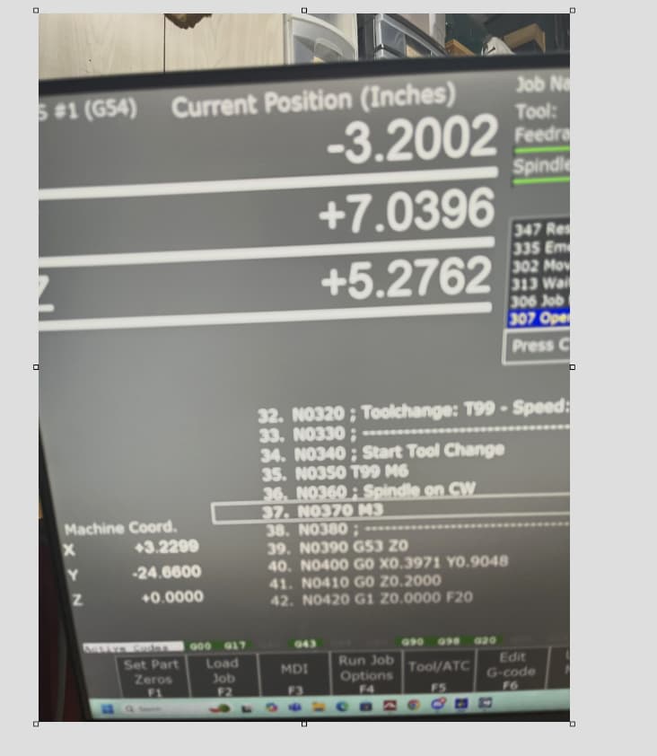

**Author:** ![kglasnapp](https://avatars.discourse-cdn.com/v4/letter/k/dfb087/32.png) [@kglasnapp](https://forum.avidcnc.com/u/kglasnapp)\
**Post date:** [August 2, 2025, 1:52pm UTC](https://forum.avidcnc.com/t/laser-cross-hair-installation/4560/10 "2025-08-02T13:52:27Z")
I have set the offsets in “Set Part Zero / Laser” menu. X offset seems to work. However the Y offset is set to 2.0402 but when I goto zero the Y axis only moves about .2 inches. Any idea what may be wrong?
Another funny thing that does not seem to be correct to me. That is when I home all of the axis goto to 0 in machine coordinates. When I move my machine to the place that I cut at the Y machine coordinates go negative.
I have been able to cut and use the laser to cut a number of parts correctly.
**Post date:** [August 3, 2025, 10:37am UTC](https://forum.avidcnc.com/t/laser-cross-hair-installation/4560/11 "2025-08-03T10:37:32Z")
Are you sure you’re talking about machine coordinates? Those can never go negative.

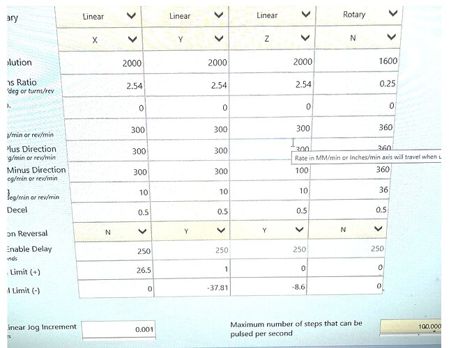

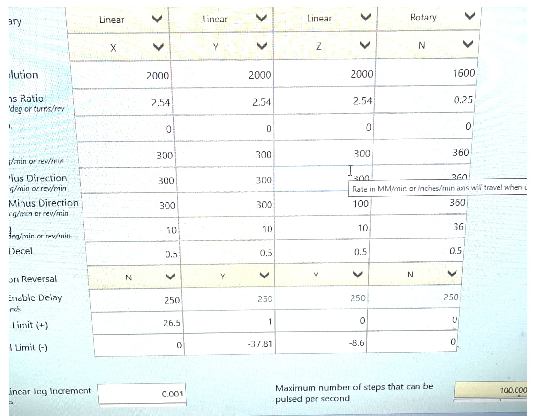

**Post date:** [August 3, 2025, 11:31am UTC](https://forum.avidcnc.com/t/laser-cross-hair-installation/4560/12 "2025-08-03T11:31:11Z")
100% sure that the machine coordinates in the Y direction go negitive. How can I correct it?? See below for a picture of moved with negitive Y, a picture of homed and a picture of my config. Do you need other information?

**Post date:** [August 3, 2025, 11:45am UTC](https://forum.avidcnc.com/t/laser-cross-hair-installation/4560/13 "2025-08-03T11:45:08Z")
Sure looks like that’s how you have it setup, but if that’s a stock Avid machine none of our machines are setup that way. You also have axis reversal wrong, which makes me think that you might have tried to correct for that by having a negative Y travel?
By the looks of it this is a Benchtop Pro?

**Post date:** [August 3, 2025, 5:31pm UTC](https://forum.avidcnc.com/t/laser-cross-hair-installation/4560/15 "2025-08-03T17:31:20Z")
> [@kglasnapp](#):
> Whjat could be wrong with my configuration that has the Y machine coordinates be negitive?
The y limit (-) should be zero, and the (+) limit the the positive (38.81) to have home be by your tool height setter and machine coordinates always be positive.

**Post date:** [August 3, 2025, 7:15pm UTC](https://forum.avidcnc.com/t/laser-cross-hair-installation/4560/16 "2025-08-03T19:15:16Z")
Just to be sure you are talking about a small crosshair laser that you installed? If so did you teach offsets with the f8? And then set your parts position 00 x and y once you line it up with your crosshair laser.
If I use the go to XY 0 button then move the gantry towards me I will get a y negative
**Post date:** [August 3, 2025, 11:32pm UTC](https://forum.avidcnc.com/t/laser-cross-hair-installation/4560/17 "2025-08-03T23:32:58Z")
Looking at your screenshot it appears that you have overridden the stock motor settings and reversed the axis directions on three axes.
There would be no reason to do this if you have a stock avid machine.
Something is funny with your setup

**Post date:** [August 4, 2025, 11:27am UTC](https://forum.avidcnc.com/t/laser-cross-hair-installation/4560/19 "2025-08-04T11:27:58Z")
Just setup a new profile. You can download one from the support site.
> **[CNC12 - CNC Software](https://www.avidcnc.com/support/instructions/software/downloads/cnc12/)**
They are all preset with the settings you need. Just make sure you pick your correct machine type and don’t override any of those motor settings.
provided your machine is physically setup the way we recommend this should work just fine
