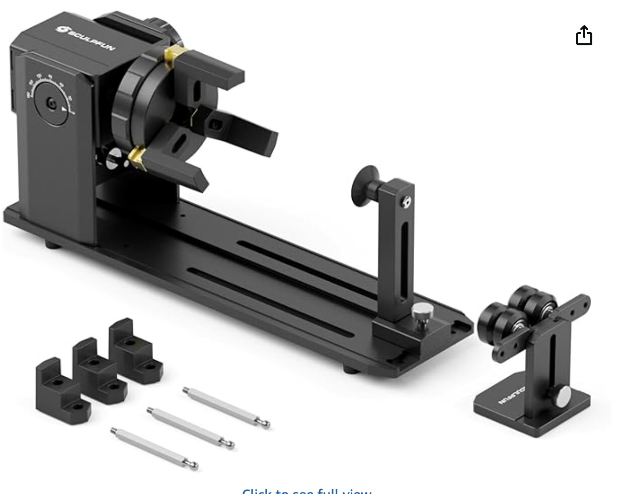

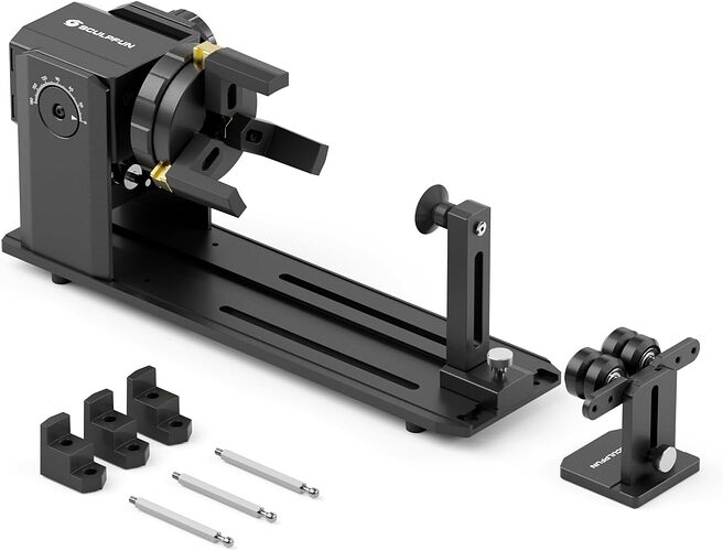

I picked up one of these:
 ![2025-08-24_21-42-16](https://canada1.discourse-cdn.com/flex027/uploads/avidcnc/original/2X/d/deeaa234089f623c77f4e4966e84855005ee5a30.jpeg)
> **[Amazon.com: SCULPFUN RA Pro Rotary Chuck for Laser Engraver, 3 in 1...](https://www.amazon.com/SCULPFUN-RA-Pro-Multi-function-Cylindrical/dp/B0D2DGZRX1)**
> Shop SCULPFUN at the Amazon Arts, Crafts & Sewing store. Free Shipping on eligible items. Save on everyday low prices.

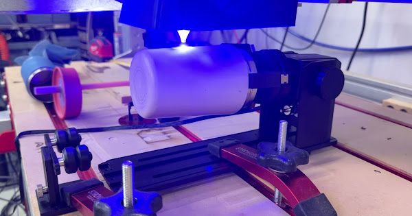

I wired it into one of my stepper machines as an A axis. I had to drop the amperage on the driver down to the minimum as this rotary has a puny little 2amp stepper on it.
I had to work out the motor tuning settings by doing some napkin math and some tuning in CNC12. Once I got that all sorted it out it works just like our “big” rotary.
The thing doesn’t have any power for cutting, but it works great for laser stuff.
I had been doing tumblers and things on the Avid rotary, but this one is more fun for “little” stuff… mostly because of the bearing rollers and the fact that you can easily angle the rotary so that you can do beer glasses and things like that.
Once I do a project that doesn’t have some personal information on it (like names and phone numbers!) I’ll post some results.
I had to do a little testing to figure out the power levels to burn the paint off of those Yeti tumblers, but once I got it it was easy to do.
For those wondering: On a 45 watt laser I was doing 30% power, 150 IPM and one pass.

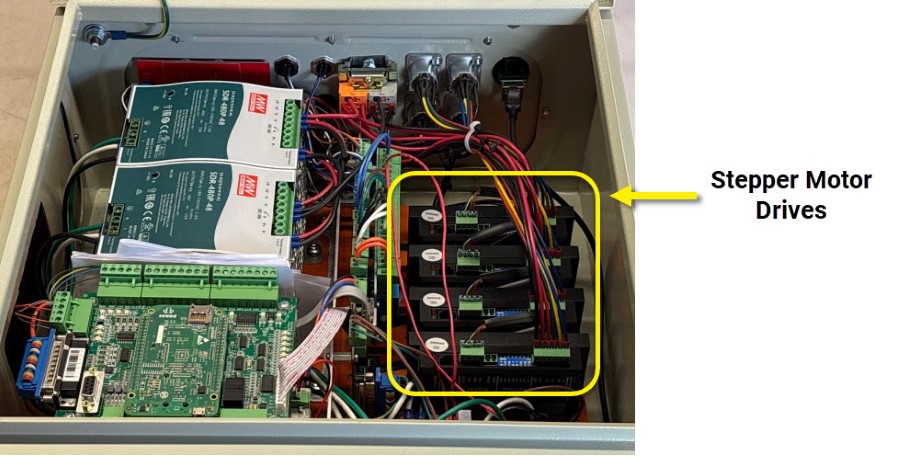

Our stepper motors run at much higher amperage, but our stepper drives have adjustable amperage:
If you look on the side of a stepper driver there are dip switches that you can configure. One set of them is for the amperage. Stock I believe we max them out at 7 amps, with the flipping of a few switches I was able to drop it to the lower amperage I needed so I didn’t cook the stepper motor in the rotary.
