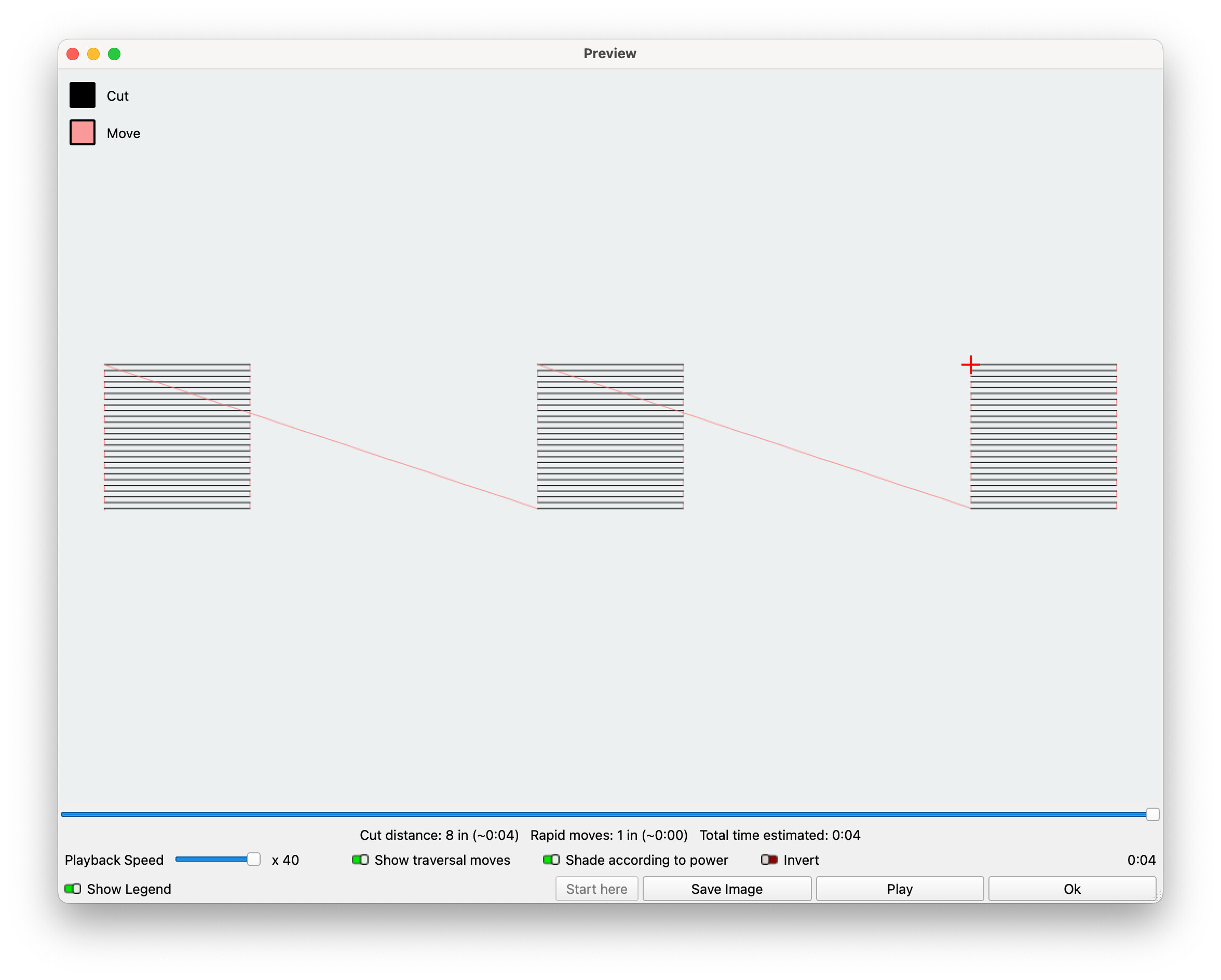

Consider a simple design with three rectangles, each 0.1 inches in X and Y.
 ![Screenshot 2025-07-16 at 4.11.06 PM](https://canada1.discourse-cdn.com/flex027/uploads/avidcnc/original/2X/8/85485f0dfc358027a426fd355af2be51c9da7e51.png)
A layer (tool path equivalent) is configured to fill the boxes using the 0.1 mm equivalent line width. It will generate a back and forth operation as shown in their preview dialog:
 ![Screenshot 2025-07-16 at 4.13.52 PM](https://canada1.discourse-cdn.com/flex027/uploads/avidcnc/original/2X/7/7b0894ef0effb84e1a78d2ac7b0471d4068dab56.jpeg)
Looks great, right?

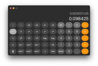

Where did `0.0984` come from? Take our line width multiplied by 25
 ![Screenshot 2025-07-16 at 4.27.57 PM](https://canada1.discourse-cdn.com/flex027/uploads/avidcnc/original/2X/2/2e5ad17d53ed82efd9e036b905008bced09a5f50.jpeg)
Add some rounding and you get 0.0984
