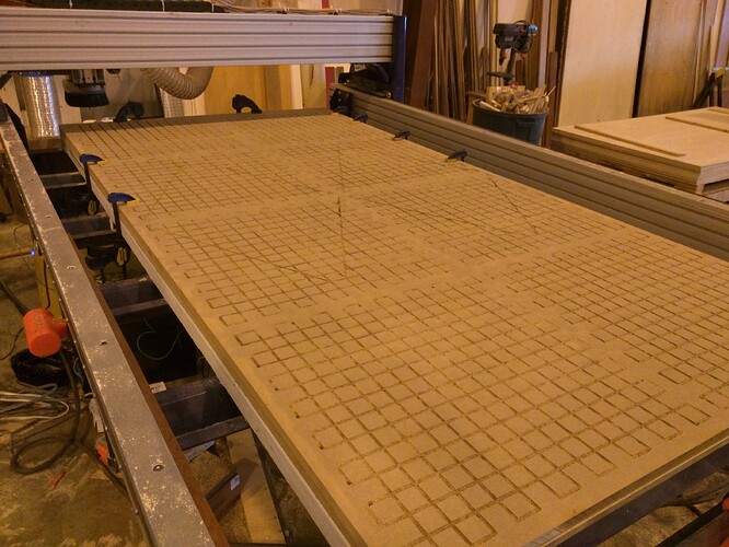

For 4x8 sheets your best bet is going to be a “universal” vacuum.
Usually these consist of having three layers on your machine:
Bottom layer solid plywood
Middle layer a plenum
Top layer LDF (low density fiberboard)
Then you plumb a vacuum pump into it like this:
> **[Hurricane | Cnc Vacuum Pump | Black Box Vacuum](https://blackboxvac.com/hurricane/)**
> Discover the power of the Hurricane CNC Vacuum Pump at Black Box Vacuum. Engineered for optimal vacuum hold down on full-size CNC routers, our Hurricane model ensures precision and efficiency. Shop now for advanced CNC vacuum solutions!
and you can suck down full sheets. You can valve off areas too to increase suction as you remove parts. This one one I made for another machine about 10 years ago:
 ![image](https://canada1.discourse-cdn.com/flex027/uploads/avidcnc/original/2X/e/e7476c184153efe570957af7fefa235c60bed578.jpeg)
You can see the three layers, base on bottom, plenum and then the top LDF layer

I had this valve system connected to a black box hurricane. I had 8 24x24 zones. I could turn on/off any zone at any time. So if I was working on a full sheet for cabinets I’d open them all up. If I had some smaller work that needed a ton of suction I’d turn off all but one zone and direct all of the suction there.
This setup was pretty versatile. It worked best for me as at the time I was doing mostly sheet goods.

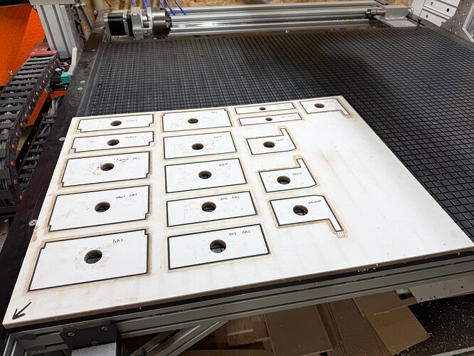

We bought the Black Box Hurricane for our CNC. For large sheet work items it works GREAT and I love it. Here is our plenum set up.
