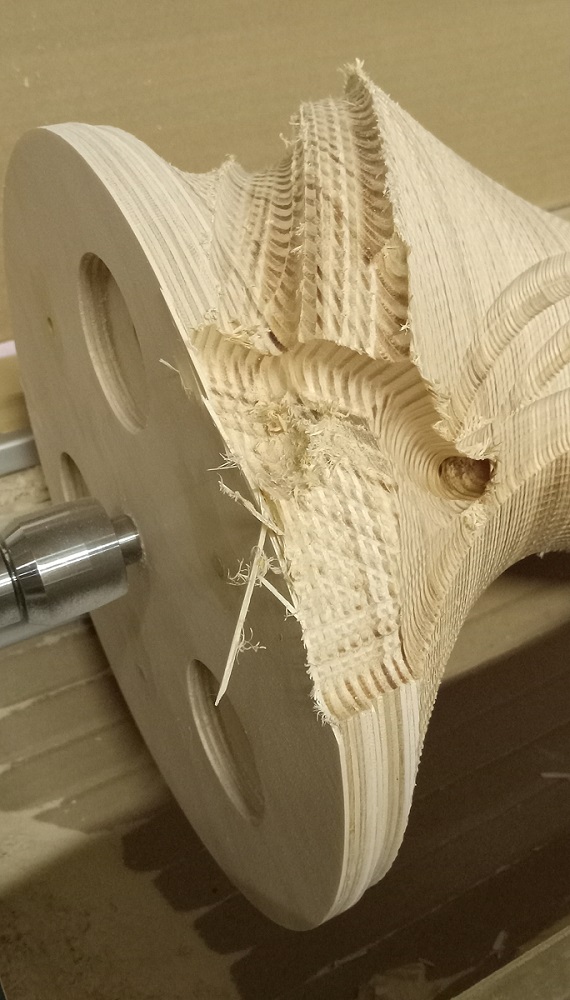

On a rotary 3D carving project, the machine failed six times. The first two times I pushed a long 1/2" endmill too fast, too deep. The endmill stalled in the wood, slipped down from the collet, and lost z-height - my fault. On the second stall, the collet significantly tightened down on the slipped bit - nearly too tight for me to loosen it again. However, after getting it off, I blew out the dust and did not notice any damage to the collet.
I swapped that 1/2" endmill with a 1/2" ballnose and tried 3D roughing passes in a raster (not z-level) toolpath. This caused the next four failures. I do not think that they were due to the feedrate, as it was slow - about 100 ipm. I have run the same endmill at 200 ipm for raster passes before without issue. The stepover is also small - about 10-20%. Each time, the z-axis lost height/ did not retract up properly/ during the program and carved into the stock too deeply. After each z-axis slippage, I re-zeroed the ballnose. It does not appear that the ballnose slipped in the collet like the first two failures, which means that the z-axis lost height somehow.
After reviewing the four ballnose failures, it appears that the issues occurred during the U-turns of the back-and-forth passes of the 3D raster toolpath. Further, it appears that the z-height loss happened when the U-turn occured when the bit has just dipped into a valley and then tried to lift back up out of that valley right at that U-turn. This is the point where the bit is engaged with the wood 100% in a frontal cut, not the 10-20% stepover side cut. When the endmill does a U-turn where there is no material at the turn (zero frontal engagement), the slippage does not seem to occur. But then, it also seems like the z-axis height loss might also happen when dropping down into a valley and back up in the middle of a raster pass.
I don’t know if the pull-up shear against the wood is too great for the z-axis motor to overcome (doesn’t seem like it should be), if the z-axis movement is too fast for the Mach 4 vs the x-axis movement (doesn’t seem like it should be at my slow feedrates), if there is bind/pinching caused by the rotary rotation reversing against the bit during the U-turn (as my raster passes are on a 45-degree angle against the baltic birch veneers), or somethine else.
VCarve Pro was used to generate the toolpaths.
Various posts have discussed frayed cables, bumped cables (not the issue), z-motor brakes (no idea how to check this) or tolerance and smoothing in Fusion 360 (not using that software), or Mach 4 lowered acceleration settings (I am using the defaults).
Any knowledge what is causing this and how to fix it?

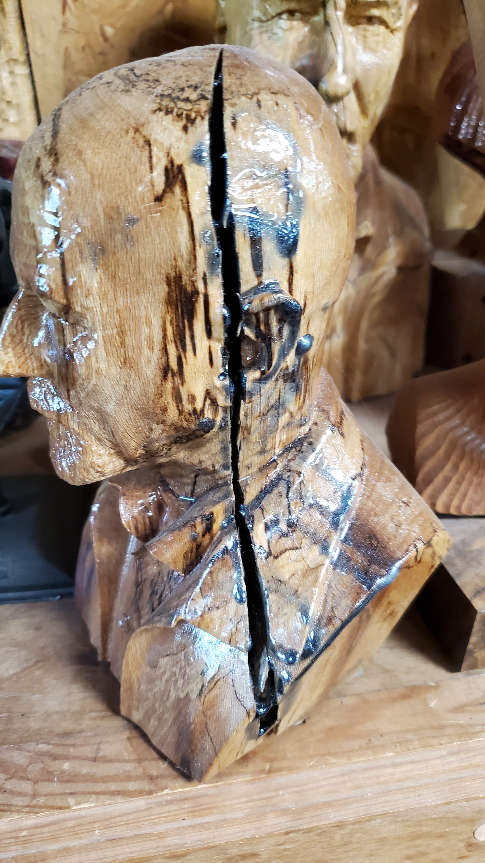

Hello Matt, I use the default on the tolerance (0.0004) I use very high on modeling res. And for sure if you don’t want your bust to split wide ass open, no matter what your moisture meter says DO NOT USE LOGS FOR CARVING.
Do a proper glue up of any hard wood. Use the gadget to do a rounding toolpath. Then import your model and rough it out I always leave 0.06 to 0.07 machining allowance , now it will give a warning that leaving that much for the finish bit to remove might be a problem, but for me it has not been, What is a problem is using the suggested 0.02-0.04, I would find places that the roughing bit cut too deep into the model.
I posted some more pics showing splitting when using logs, this won’t happen if you do a glue up.
