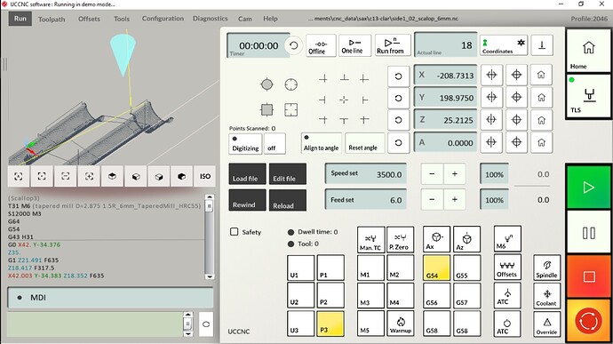

Uccnc screen seems a bit chaotic lol.
But Id rather have a chaotic screen with more stability. And probing features included which I need.
Check this Uccnc screenset that a user made
> **[GitHub - twentyfortysix/uccnc\_screenset\_2046: Screenset for UCCNC](https://github.com/twentyfortysix/uccnc_screenset_2046)**
> Screenset for UCCNC. Contribute to twentyfortysix/uccnc\_screenset\_2046 development by creating an account on GitHub.
