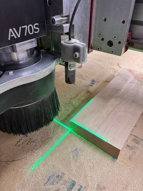

I would like to install one of these. For those that have one can you post a picture showing how it is mounted.

That’s how I mounted mine. I went with a green one as I find those easier to see (and cooler looking).
 ![IMG_1580](https://canada1.discourse-cdn.com/flex027/uploads/avidcnc/original/2X/a/a0df2671e813824fb14d9e3805c1edcddb6baa45.jpeg)
I use this ALL the time for non-precise origin setting.

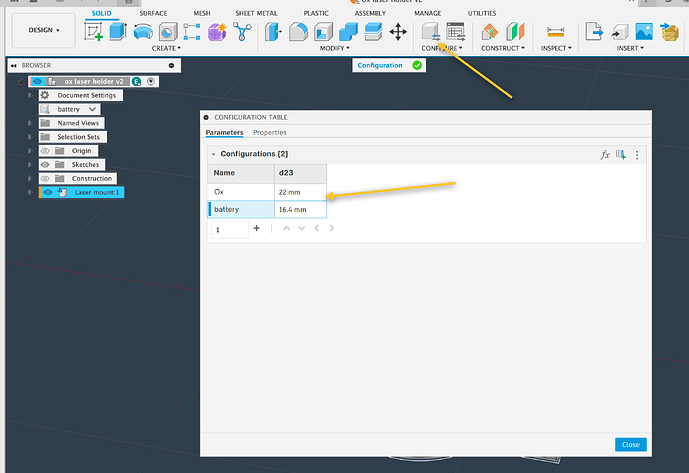

Darn I printed out that 3D model you had in f360 and it’s way too small to fit the laser diameter. I bought the exact laser that you show in your message. Guess I’ll have to learn fusion to enlarge that hole
**Post date:** [October 8, 2025, 11:02pm UTC](https://forum.avidcnc.com/t/mounting-a-laser-crosshair/5337/11 "2025-10-08T23:02:58Z")
You have to configure it as an Ox:
 ![image](https://canada1.discourse-cdn.com/flex027/uploads/avidcnc/original/2X/0/0af63c30568e824a1ce3bde482f6972da9baa47f.png)
The diameter of the OX is around 22mm, you probably printed the 16.4 mm version

I don’t see that option

looks like I have version 1 of your holder, I downloaded it from another thread you had about this. do you have a google drive or something with all your goodies in it ?

ok I think I have it figured out in f360, will reprint and let you know.
**Post date:** [October 9, 2025, 12:40pm UTC](https://forum.avidcnc.com/t/mounting-a-laser-crosshair/5337/15 "2025-10-09T12:40:22Z")
You’re in the “manage” workspace, you need to be in the “solid” workspace and you’ll see the config option on the toolbar up top
