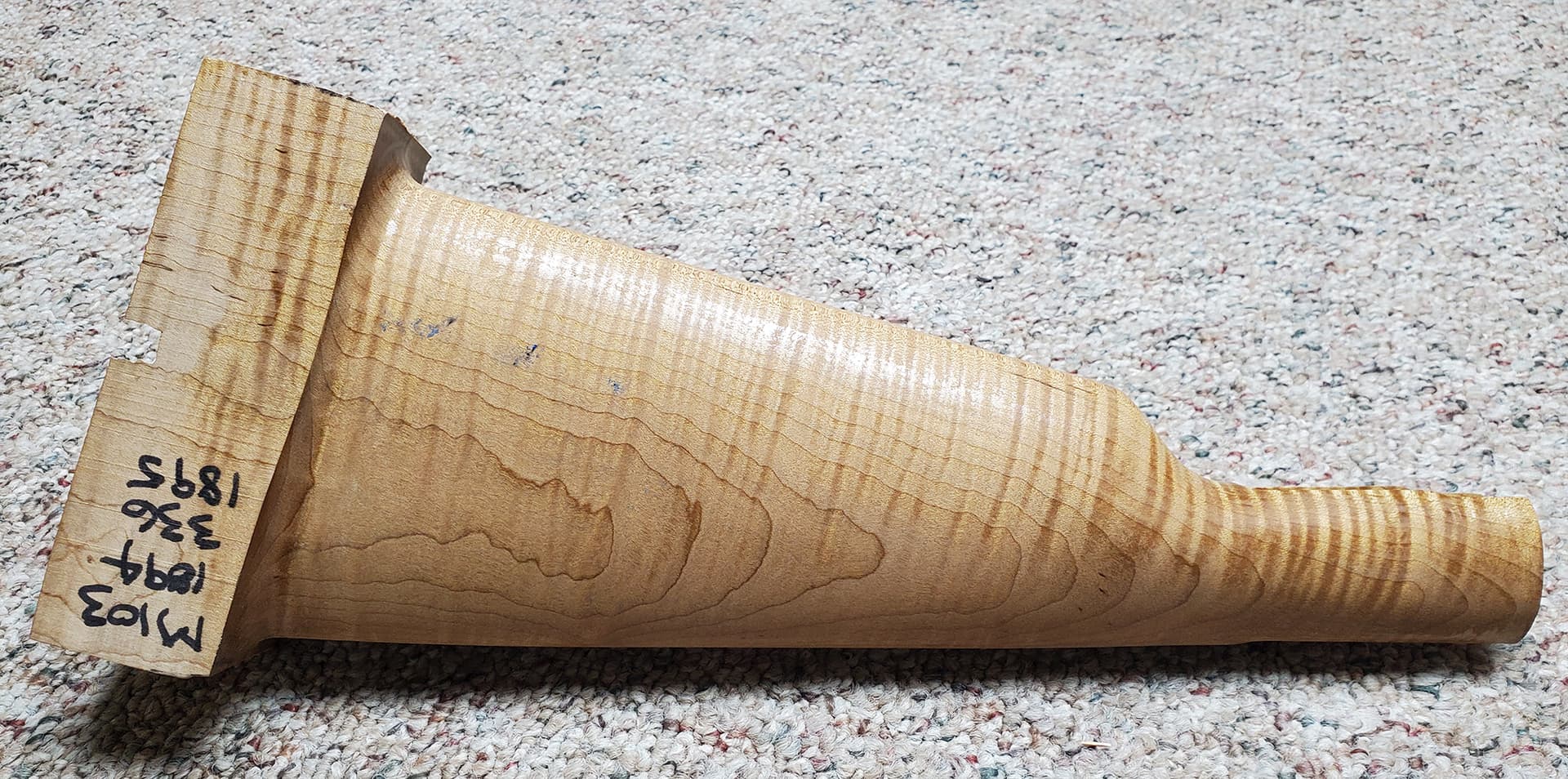

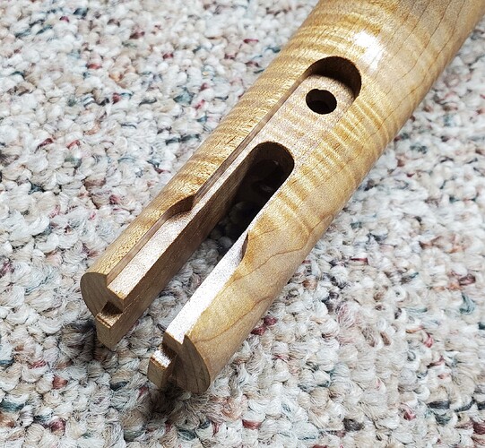

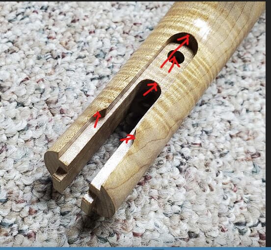

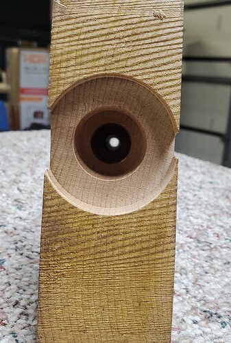

Good Afternoon!
I got off the phone with Cory in sales a little while ago. He suggested I join here and post my project needs to get feedback from the crowd.
I want to be able to cut butt stocks and forearms for Marlin lever action rifles out of fancy walnut & maple blanks. The quality of the inlet is the MOST important consideration. This is not meant to be a production type scenario.
The photos below are of a stock that was made for me a few years back, unfortunately that is no longer an option.
My thought is to use a rotary 4th axis so everything can be cut in one setup. The inlet is basically parallel with the bottom of the stock.
 ![image](https://canada1.discourse-cdn.com/flex027/uploads/avidcnc/original/2X/a/aaffc1fc143f933e6037d26c7d75fbf514a11a57.jpeg)
 ![image](https://canada1.discourse-cdn.com/flex027/uploads/avidcnc/original/2X/7/7d0cc1ecf1e22fbc45ea16bb49f0f97db91c2ba9.jpeg)
 ![image](https://canada1.discourse-cdn.com/flex027/uploads/avidcnc/original/2X/1/11c33c87813291147a02699eeb75919402e35803.jpeg)
 ![image](https://canada1.discourse-cdn.com/flex027/uploads/avidcnc/original/2X/3/3733fb7e858d409111ef7c978c87b7fb5aacb342.jpeg)
 ![image](https://canada1.discourse-cdn.com/flex027/uploads/avidcnc/original/2X/b/b6e634a30959f9d8f1095d560be6c8b1dc76b761.jpeg)
Feel free to hit me with any questions or comments!
Thank you in advance, Lew.

Welcome.
It is great that you know what you want to build in advance, that will help quite a bit!
IMO there are few basics to consider before making any recommendation.
- How many of these do you want to make?
- Did you have a budget in mind?
- How much space do you have to dedicate?
- Do you already have 240V power? Enough for a dust collector too?
- Are you going to be using it for other projects as well?
- The back of the stock with the lettering on it has a notch cut out of it. Is that just from workholding, or are there important features there?
- Do you already have experience with CAD tools?
A rotary does sound like it would get the job done, but to be honest if you are only making one, maybe traditional hand carving is the way to go.
Depending on what software tools you are using, you might end up having the rotary just do 4 90 degree turns. In which case you can likely get the same result with clever use of dowel pins.

Greenleaf, thank you for the response and your insight!
- How many of these do you want to make? **To start, one per month would keep me busy as it is just a small part of the larger overall project. As word gets out, there may be a higher demand. Hard to tell, but sexw wood is always in demand…**
- Did you have a budget in mind? **I was hoping to be all-in for around $10k. That was a number from my head, without the benefit of any research.**
- How much space do you have to dedicate? **If I find a solution that I cannot live without I will make the space for it.**
- Do you already have 240V power? Enough for a dust collector too? **Yes, and I have the dust collector as well.**
- Are you going to be using it for other projects as well? **I do not foresee that but you never know…**
- The back of the stock with the lettering on it has a notch cut out of it. Is that just from workholding, or are there important features there? **There is a through-hole lengthwise through the buttstock, probably a left-over from that process. The entire block at the back is removed on the tablesaw.**
- Do you already have experience with CAD tools? **I had a small Milltronics machining center for metal parts 100 years ago, but that is it.**

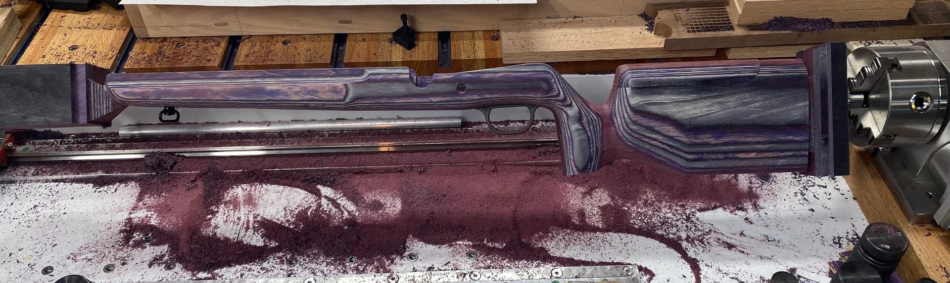

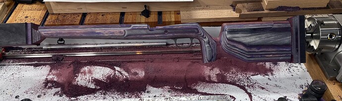

I may know a thing or two about cutting stocks on a 4th axis.
 ![IMG_3038](https://canada1.discourse-cdn.com/flex027/uploads/avidcnc/original/2X/e/e3ca39afb8d58d932b6dc623c807601331db7623.jpeg)
Ideally your inletting will be 90 degrees to the axis of rotation of the rotary which does not look like the case for your example. You will want to support one end with the rotary chuck and the other with the tail stock having “tooling lugs” on both ends to hold on to and then saw off after the milling. Being zeroed dead nuts on the axis of rotation is a must . Being off really throws things off once you start rotating. If you are not dealing with a lot of variations in design, I would consider setting it up dedicated fixturing on the table for cutting the sides and doing the inletting in a vise or fixture. The rotary pays off for the work that is variable.

I use Fusion and no mfg extensions. I use the 4th axis as an indexer, which basic paid Fusion does that well.

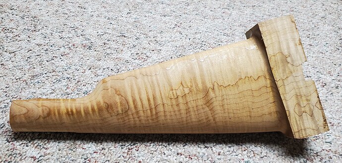

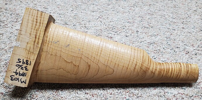

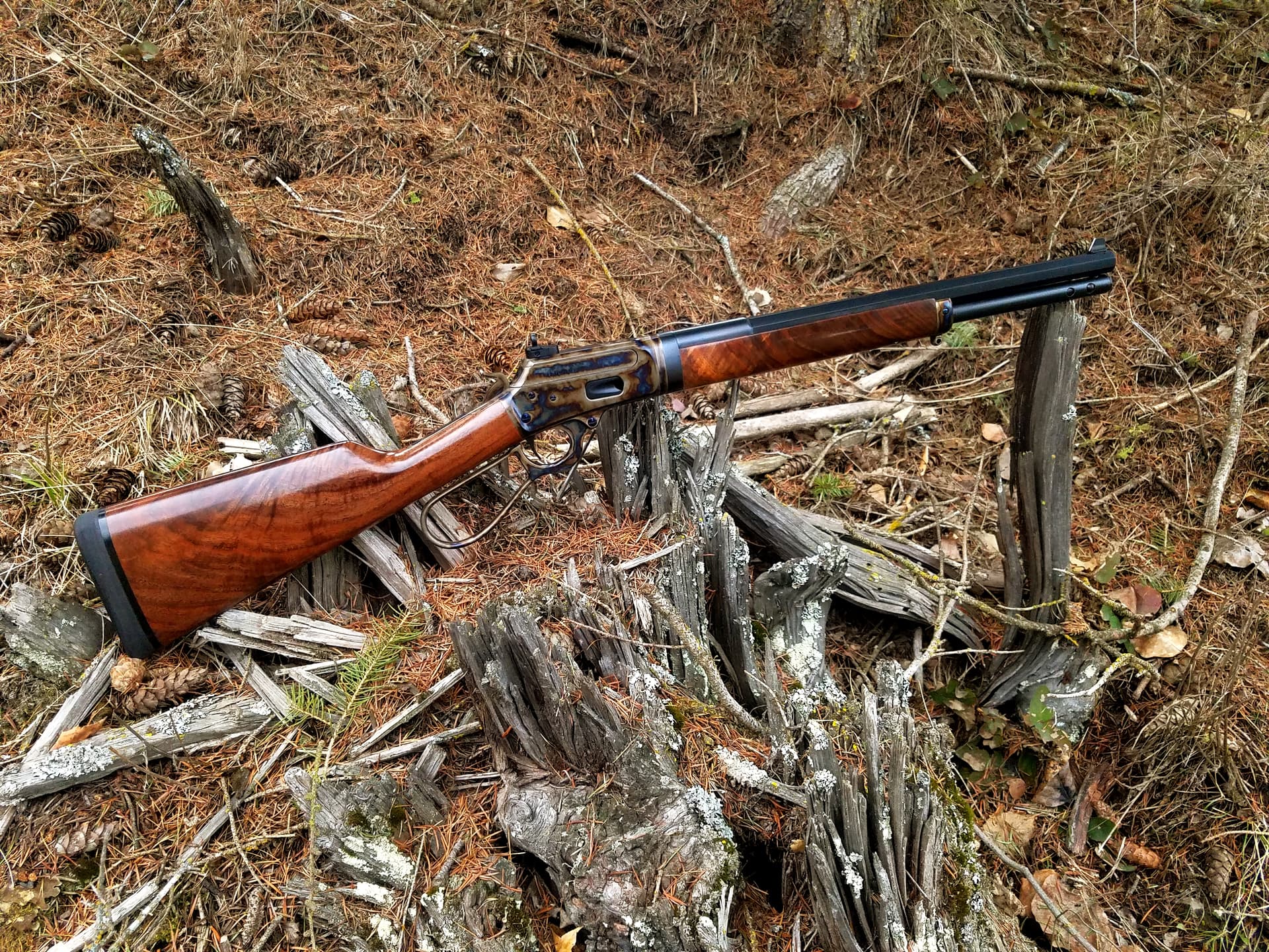

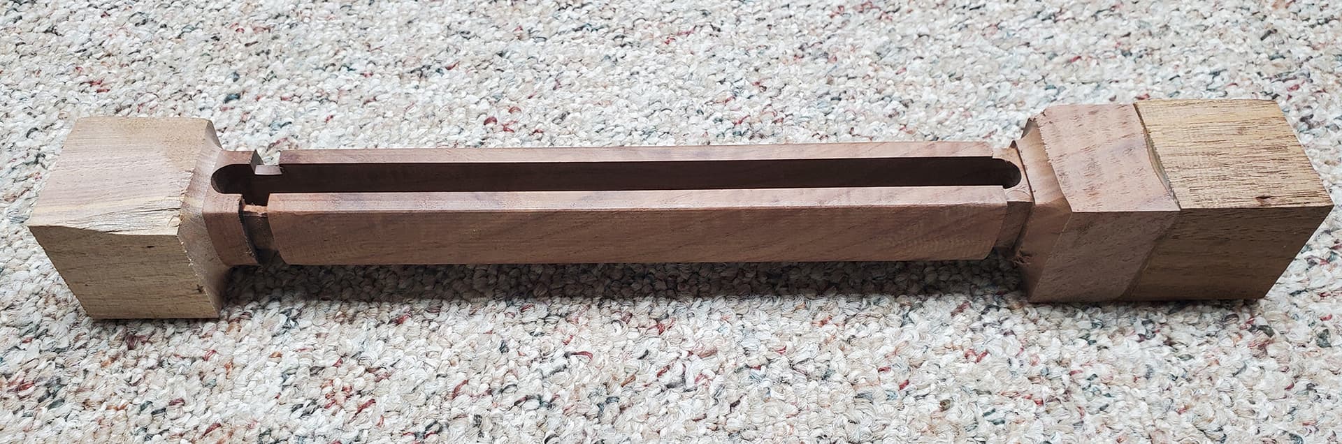

Okay, here are a few more photos of the butt stock and forend.
 ![image](https://canada1.discourse-cdn.com/flex027/uploads/avidcnc/original/2X/2/24233aee1761f2a089586451d296fbb48edc0400.jpeg)
 ![image](https://canada1.discourse-cdn.com/flex027/uploads/avidcnc/original/2X/f/f9e216c38e9e9116730ad43ec2edc98258b86bb4.jpeg)
 ![image](https://canada1.discourse-cdn.com/flex027/uploads/avidcnc/original/2X/d/d6ce0ad52219dd4c9a9298739e16b7fb5e4913cf.jpeg)
 ![image](https://canada1.discourse-cdn.com/flex027/uploads/avidcnc/original/2X/0/0d3ef972c3dbbc94919d4a37ac93d68e5de65f32.jpeg)
 ![image](https://canada1.discourse-cdn.com/flex027/uploads/avidcnc/original/2X/8/841d4745d597caa0edf544409788ea42c2c81e98.jpeg)
 ![image](https://canada1.discourse-cdn.com/flex027/uploads/avidcnc/original/2X/f/f8056609ec812d9aec144cc36847126fc0133218.jpeg)
 ![image](https://canada1.discourse-cdn.com/flex027/uploads/avidcnc/original/2X/5/54f10ab83d4bf4debdd83310491e03d95fd4bc69.jpeg)
And one of a finished product…
 ![image](https://canada1.discourse-cdn.com/flex027/uploads/avidcnc/original/2X/3/35b9348cb1568ea76d4d72f8d660fc409221e0f9.jpeg)
**Author:** ![Loren](https://avatars.discourse-cdn.com/v4/letter/l/b5ac83/32.png) [@Loren](https://forum.avidcnc.com/u/Loren)\
**Post date:** [September 13, 2025, 11:55am UTC](https://forum.avidcnc.com/t/noob-needs-help-determining-new-machine-needs/5239/9 "2025-09-13T11:55:40Z")
Beautiful work. The forearm is a natural for a 4th axis and you do not need to be able to do live 4th axis to cut it but you could cut in on a fixture too.
Boring the deep hole in the butt will be fun. I think do that first then make some custom fixture to locate off of the bore and then chuck up on the fixture.
One thing to keep in mind is the Z travel clearance you will need over the work piece on the rotary. I use some pretty long end mills and tool extensions to reach some of the inletting depths. You will want to have the rotary axis dropped down in the bed and the tall gantry / Z axis options.
I custom built my machine using Avid drive components just for those reasons.

_Boring the deep hole in the butt will be fun._ **Boring the deep hole is something I routinely do on one of my 16 x 40 lathes manually, no issue. Usually takes about ten mintues-ish per stock.**

**Similar to the photos of the forend with the 2x2 blocks still attached.** _Correct_
