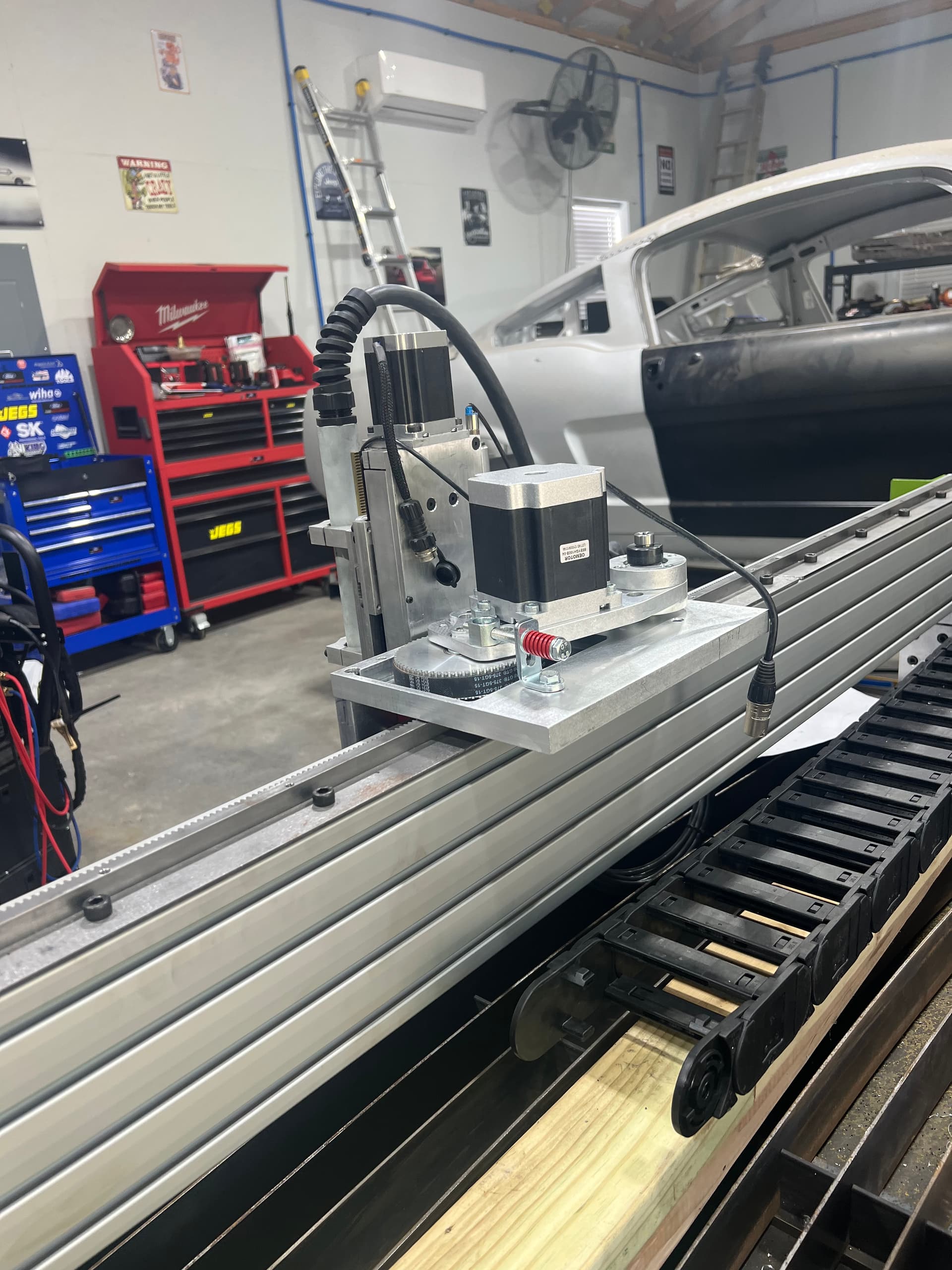

I’ve built my 6096 pro with a Masso G3 too. The G3 drives the Avid supplied Gecko 203v and nema 34 steppers. Runs perfectly. I finally got the Jianken ATC with pneumatic tool rack and pneumatic dust hood working. My dust hood/shoe is Z axis independent 3d printed. I have to redesign the dust hood to fit around the spindle bracket when it lifts… so close. I’ll get some video posted soon. Love the Avid/G3 combination.

Working on a 5x5 plasma using a G3 Masso

I am just about to finish it up hopefully be able to get a video up in the near future. The Masso seems to be super easy to work with
