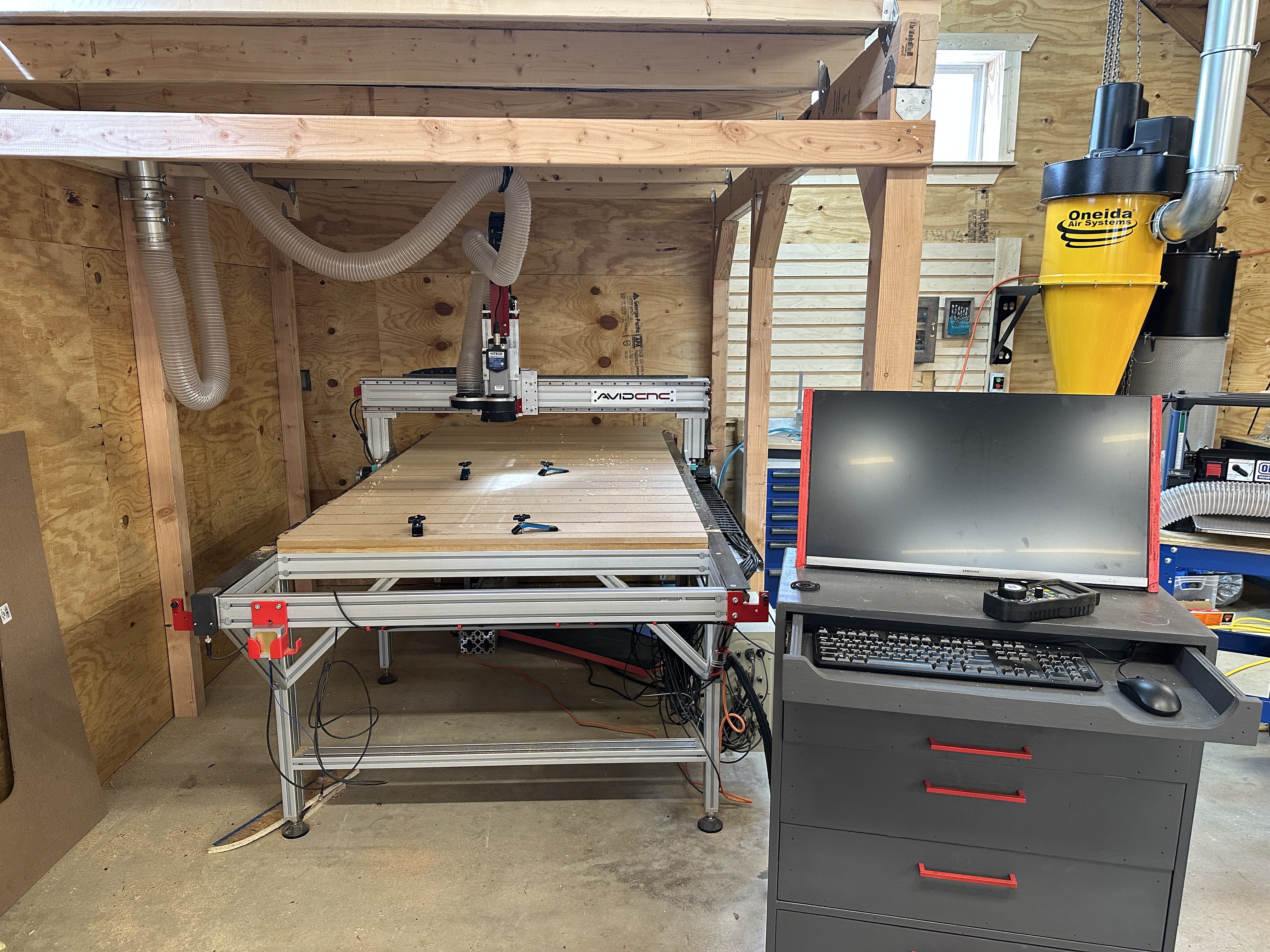

I have mine about 50cm away from the wall and directly at the wall with the back side. I am pretty happy about that since I have to have room on both sides for clamping and dealing with larger pieces. I have my lumber storage right above the CNC to save space.
 ![IMG_5360](https://canada1.discourse-cdn.com/flex027/uploads/avidcnc/original/2X/b/b611ff29d23c47e9d6850c57a8ff50df00ba60f1.jpeg)
