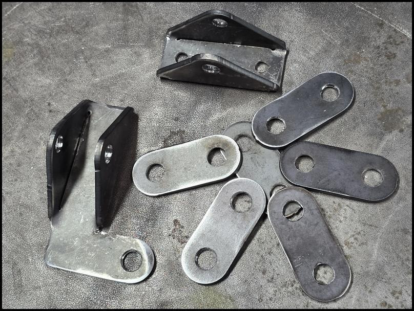

It is hard to see in this next image, but this part gets installed on the back of the cross-slid fit in along side the taper attachment and picking up some of the existing mounting bolts used by it. The piece sticking up is welded to the X-axis linear encoder mount and the part sticking down offers two bolt holes to pick up slots in a mating part that attaches to the shuttle / encoder read-head on the Z-axis.

Then back to to the plasma cutter to generate the next set of brackets for the Z-axis mount. After bending and minimal welding these look like the following.
 ![image](https://canada1.discourse-cdn.com/flex027/uploads/avidcnc/original/2X/4/43689f078ddec1d29188b9660d51b189cbbcf2ed.jpeg)
