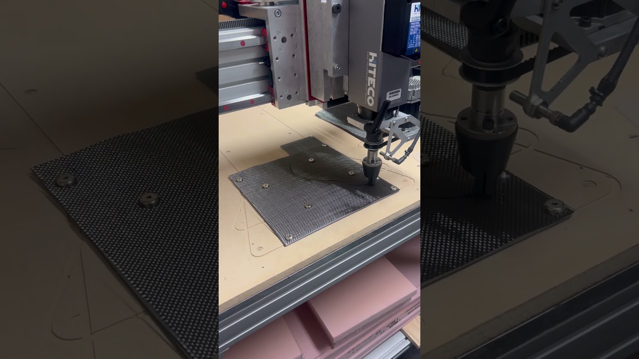

Now that we had a new tool in the shop we started having intrusive thoughts about how to automate some of the more tedious tasks we have in front of us. As mentioned, we’re doing a lot of composites work right now. This includes templating and cutting tons of carbon fiber fabric. We decided to try adding a tangential knife to the machine in support of this.
My brother designed a mount for an additional ClearPath servo motor. The spring-loaded blade holder is made using a ballspline and a 3D printed bearing block. All the other mechanical bits are from McMaster. We’re using the spindle as the toolholder since the ClearPath can’t cope with the axial loads. This has the added benefit of not requiring any additional shafting or X/Y tool offset weirdness. Both the motor and homing switch are wired to the EX controller’s A-axis ports, with power Y-cabled off the X-axis servo. I found a tangential knife post processor for Fusion 360 on GitHub that I re-wrote and customized to work with the Avid. The rotary homing scripts in CNC12 also required some mods to make them work with a C-axis instead of an A-axis.
 ![Image (18)](https://canada1.discourse-cdn.com/flex027/uploads/avidcnc/original/2X/1/19086526cc97d907414a3b631c43fa55094fa52e.jpeg)
The crank handle on the left lets us pull the entire assembly as a unit. There’s also a stop collar to index the mount axially and a dowel pin that acts as a rotational stop.
Video of the first test cut:
[![](https://canada1.discourse-cdn.com/flex027/uploads/avidcnc/original/2X/0/03547e24472d7cc63c5009655541ea33ce8160fd.jpeg "Avid Tangential Knife Test") ](https://www.youtube.com/watch?v=vMTR1O7Nc8E)
We have since added a 48"x48"x0.093" LDPE sheet as a cutting surface. That’s backed by a sheet of mild steel. This way we can simply hold the cloth down with magnets.
