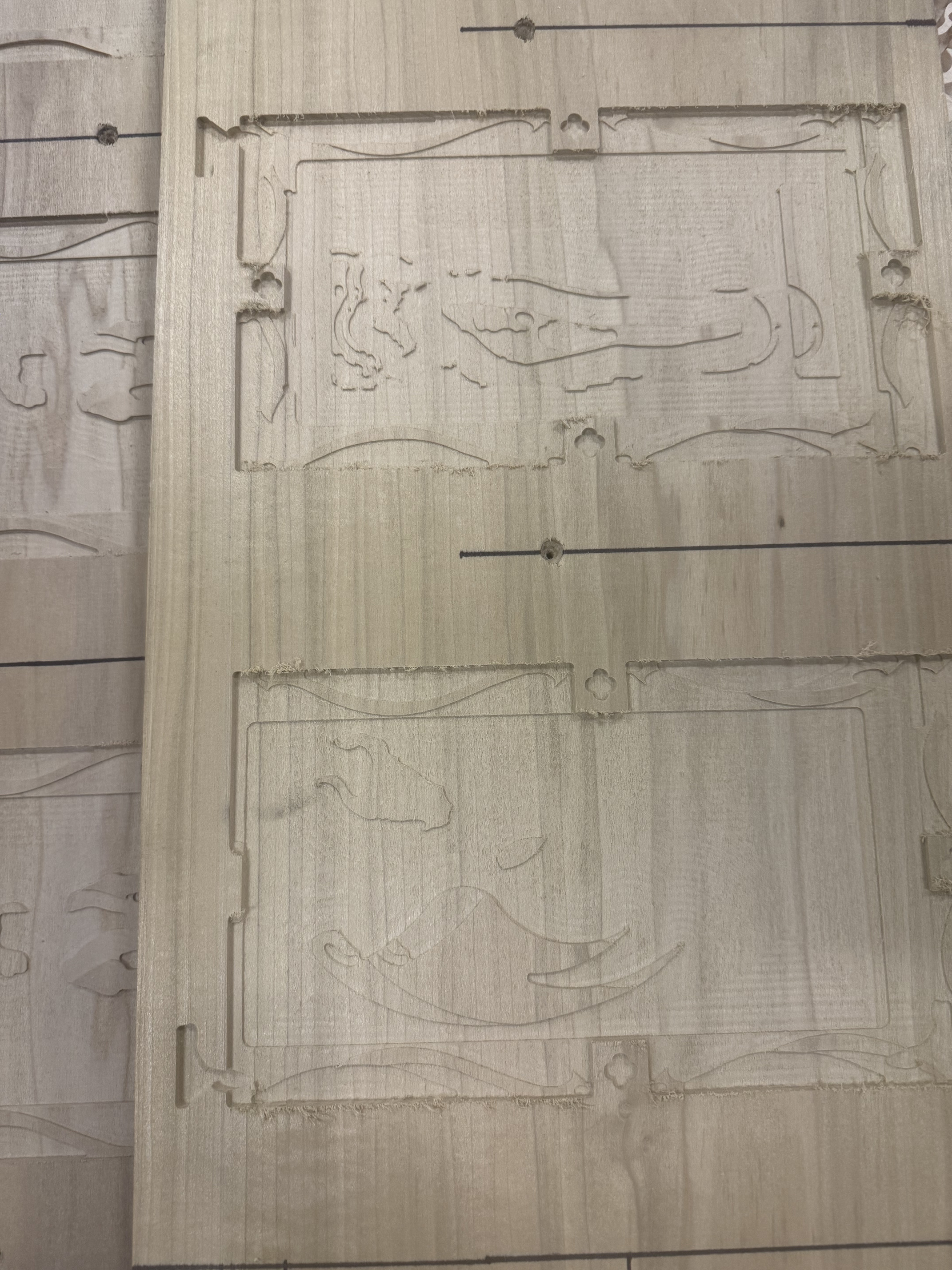

Here are some photos of the issues I’m experiencing:
I’m cutting Poplar Hardwood with 1/8" Bit at 12000rpm and a Feed of 50ipm.
This is from the first time it had issues on the X-axis
 ![Unusable King.HEIC](https://canada1.discourse-cdn.com/flex027/uploads/avidcnc/original/2X/e/e016e7c7f9fd8dbd066c98021cfc664a25516d80.jpeg)
This shows how it lost position by 5/8" on the X-axis. It’s unclear to me at what point in the cut it did this because you can see the clover pocket on the top model and not on the bottom one but the upper one had more of the model damaged (it’s not supposed to look like that… at all)
