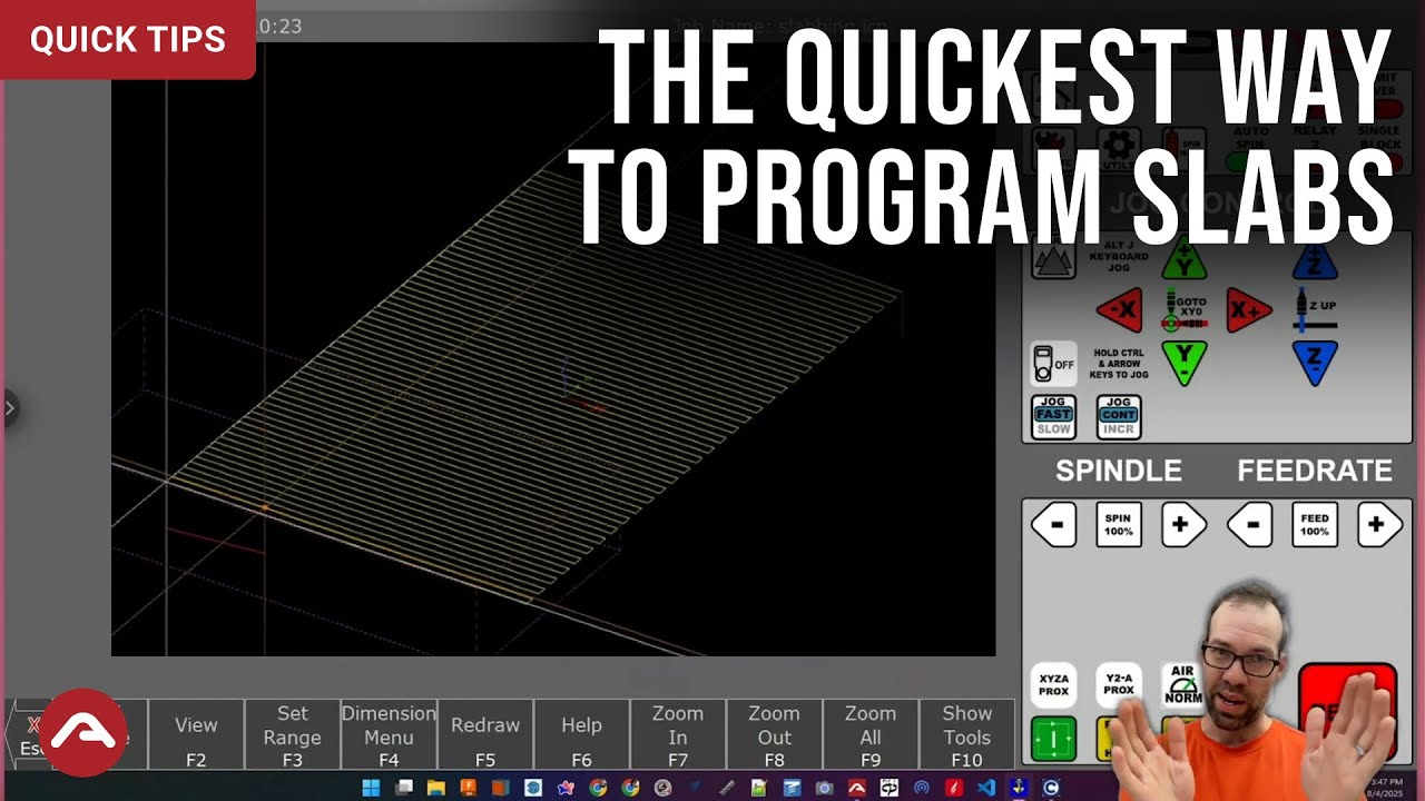

It’s already in there, you can use Intercon to make a big slabbing toolpath.
It’s under advanced options. I have a video planned on how to do it, but basically you’ll use the “conversational” CNC interface. In a couple of clicks you can make a slabbing pocket toolpath really easily.
You just create two operations:
-A tool change
-A pocket or a facing toolpath
You can configure everything and post it immediately without ever leaving CNC12.
[![](https://canada1.discourse-cdn.com/flex027/uploads/avidcnc/original/2X/b/bb6717bf03c5bae1ecacaf31712fdc26f8426136.jpeg "Flatten Slabs Faster using Intercon") ](https://www.youtube.com/watch?v=Fti_7ybt62Q)
