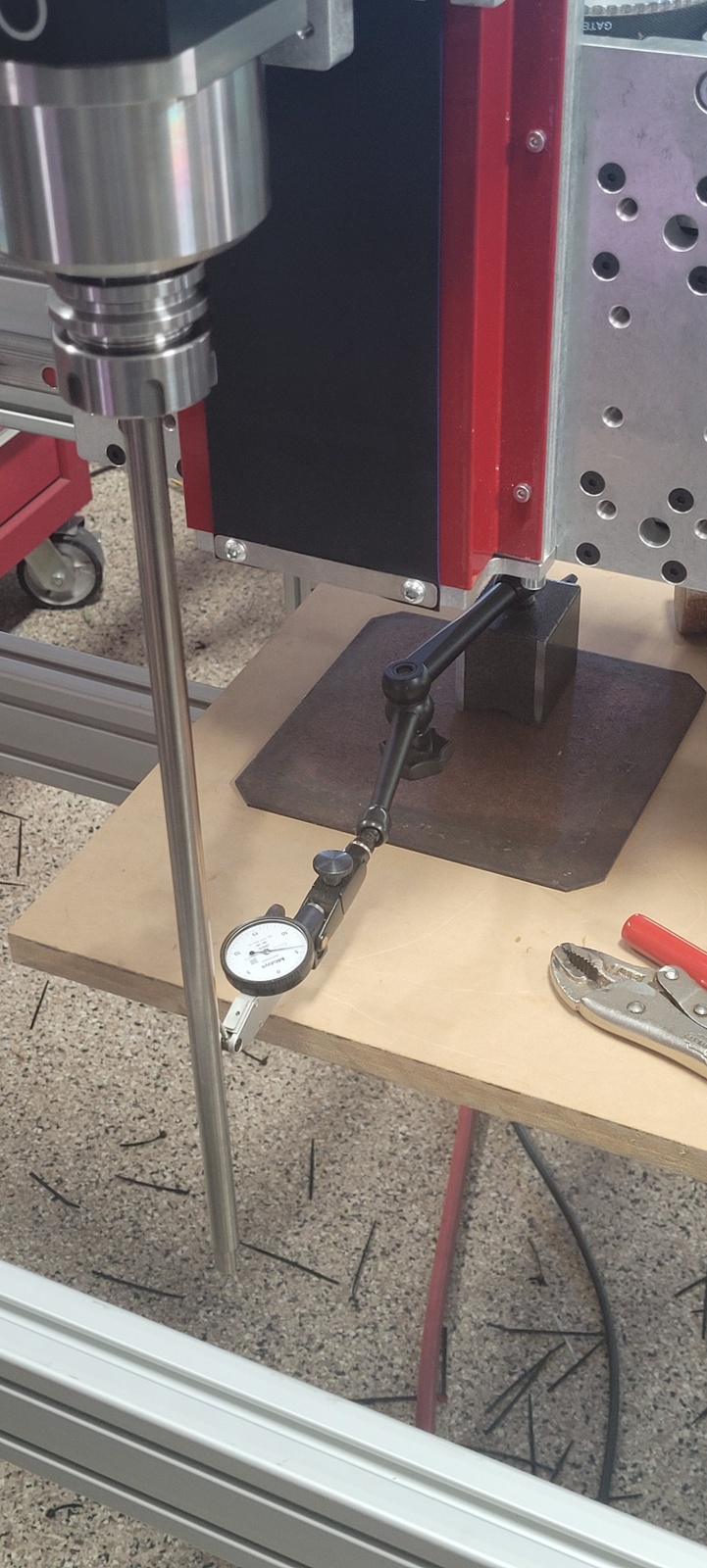

A while back I got to the point I needed to tram the spindle on my new 48" x 48" Pro router. I read about and watched lots of videos on how people have been doing this. I guess if all I was cutting was wood most of these would have worked but I plan on also making small aluminum plastic injection molds and other precision parts out of metal. I might be asking to much of this machine but I’m going to give it a try. If this were a Bridgeport mill it would be easy to tram because the mills table can be used as a reference surface. I don’t have that with this router.
So where to start. One thing I didn’t find anyone doing was first tramming the axis of the spindle to the Z axis linear rails. I figured if those weren’t in alignment I’d never be able to make decent parts.
So how the heck I was going to do this. At the time I had just finished leveling and squaring the table but didn’t have a spoil board on it yet.
The following procedure is what I would call a proof of concept. I’m using a ER32 collet mounted in an ISO30 tool holder. I was getting .001-2" runout of the rod at the collet end and .010-15" at the far end around 12" away. With a little massaging I was able to get one side pretty flat down around .005" top to bottom which I marked.
I mounted a .0005" dial indicator against the rod along the Z axis of the machine and ran the spindle up and down. Using the non-concentric nut on the Avid spindle mount I trammed in the Z axis. I did the same for the Y axis but used feeler gauge blades inserted between the bottom edge of the spindle and the spindle mount. I had to repeat the process many time before I got it right. I ended up having to make a custom shim for the Y axis.
I’m sure this will have to be checked from time to time as things settle and wear in. Maybe someone will come up with a better way to do this but for now this is where things stand.
Next up was deciding what to do for a spoil board/fixture plate. I wanted to use an aluminum plate for the first section and some sort of hard plastic after that but I was blown away at the price, around $1K just for the aluminum. Maybe if I win the Lottery.
I hope this made some sense. Please ask Questions and post comments. Because I don’t do this for a living, having this forum will really help.

Technically, the method you are using is reasonable for checking the perpendicularity of your Z-Axis liner rails. The problem I have is that you probably have too much and too many inaccuracies built into your process to tell you much. With a very high quality collet, your runout should be about .0001" at about 4xD. So you should get the result at 2" off the nose of the collet with a 1/2" shank loaded (for example). Measuring at the face of the collet should yield almost imperceptible runout. Runout is linear, so if your gauge bar is perfectly straight, your runout should double at 4", triple at 6", etc (for this example). Any thing else that contributes to that isn’t runout.
Also, if your rails were off by 1/2 a degree (say 89.5), you X/Y positional change would be .035" over a 4" Z-Axis change. I highly doubt you’re off anywhere near that. But 4" is still probably an exaggeration of your typical change in cut depths for what you are doing. Let’s say it’s 1" in your Z-axis change. You’re only talking .00875".
If I were you, I would see if I could get my runout tightened up by trying a higher quality collet first. For you guide rails, get a simple Wiley digital angle gauge and zero it on your table. Then, hold it against your rails. They are accurate to within .2 degrees and repeatable to .1 degree and are inexpensive. if it says you’re wishing a couple tenths of a degree, move on.

I don’t think I did a great job of explaining what the issue is. If you draw a line through the two linear rails, we will assume because the assembly slides smoothly they are parallel. Now draw a line through the the centerline of the spindle. All I’m trying to do is make all three lines parallel. All that’s left after that is taking a skim cut off the spoil board and checking for flatness. At that point the system should be good to go.
This process wasn’t an easy one and shouldn’t be needed by most people. With the current way this is done we kind of back into making the spindle aligned with the linear rails. I just don’t think we will ever quite get there.
Yes the better the tools the better the results. I used what I had on hand. For next time I plan to have a quality 1/2" or larger ISO30 tool holder. This will help with the runout issue. Another thing I think would help would be to lock the spindle and use a piece of precision ground square stock turned at one end to go into the tool holder. With round stock the problem is exacerbated by the fact I got greater fall off any time the dial indicator moved off the centerline of the round stock.
Bottom line is I think aligning the spindle with the linear rails (however it’s done) should be the first thing done not the last during the tramming process.
Please ignore the setup you see in the picture, not sure what I was doing at the time. One of the things I found when measuring how square my spindle was to my table. The further the dial indicator was away from the spindle the larger the difference readings if any. Making them easier for me to understand and thus more accurate. The indicator was able to swing the entire width of the table. After I put on a full spoil board I was able to measure the nod of the spindle. This was cheap and easy to do. I used a couple of nuts, a bolt with the head cut off, part of an old bed frame and only one dial indicator.
Current project is making a spindle lockout so I can’t drop the tool out while spinning at 18000rpm. That would make for a very bad day. Design is done and I’m half done with the build. If anyone is interested I’ll share when it’s done. Not sure why that isn’t part of CNCDepots design.
I’m just at the beginning of this journey while also trying to understand the machine I’m going to love to use along the way. Have fun, I am.

There are two things that can be off, the spindle, and the Z axis. Probably many ways to align both, however, if you align the spindle to the axis, that is fine, but how do you know that the axis (the linear rails) are perpendicular to your table in X and Y? The axis itself seems to be the one that all the tramming videos ignore.
**Author:** ![rwoerz](https://avatars.discourse-cdn.com/v4/letter/r/77aa72/32.png) [@rwoerz](https://forum.avidcnc.com/u/rwoerz)\
**Post date:** [February 6, 2023, 8:10pm UTC](https://forum.avidcnc.com/t/spindle-tramming/1688/13 "2023-02-06T20:10:08Z")
I think taking the skim cut after aligning the spindle takes care of the X and Y squareness but I think you might be right, I’ll have to think on that one. Thanks for the reply. What a can of worms we’ve opened. I’ve heard “The answer is out there.” We can only hope.
We might have to rely on how well Avid puts the Z axis together. Thanks a bunch, now you’re making my head hurt. lol
