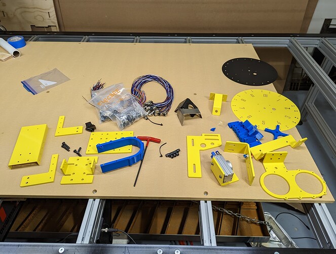

**Post date:** [April 5, 2023, 7:14pm UTC](https://forum.avidcnc.com/t/subnoize-10-tool-carousel-tool-length-sensor-and-dust-manifold/1096/52 "2023-04-05T19:14:33Z")
![PXL_20230405_190554935](https://canada1.discourse-cdn.com/flex027/uploads/avidcnc/original/2X/b/be1713ae929166247ed2a0c3011f8ea43b8d9805.jpeg)
Last of the parts are powder coated and the electronics cabinet components are arriving.
M12 8pin female panel mount for the motor control are proving difficult to source but they will be here by May at the latest.
The control components will have to live spread out on the floor a bit longer 😞
Hopefully this weekend I can start by getting the powder coated dust manifold mounted and the tool breakage and length sensor ready to be mounted.
Almost there!
