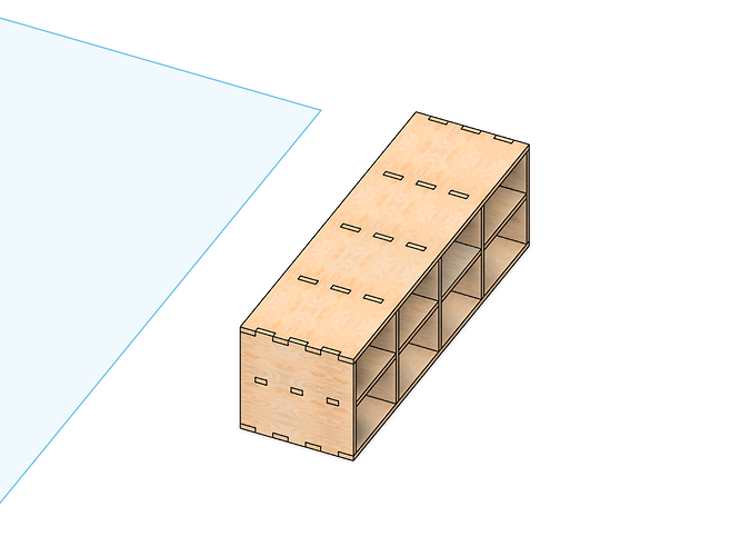

![Cubby Bench (v1)](https://canada1.discourse-cdn.com/flex027/uploads/avidcnc/original/2X/7/72e3520e5744b161e4087436600de78c6c9b54a7.png)
I just decided to take the plunge and get a full-size CNC. My use is to drop sheets on it and get perfectly indexable tabs and slots to assemble simple shapes for my business, for starters. I’ve used Fusion for a while for 3d printing, but I still haven’t broken out of being a novice. I do understand simple issues with using a CNC router for tab n slot, like rounded corners and needing to dogbone. However, I’ve read that a tolerance of .007 is appropriate to allow parts to go together. Whenever I watch a video, I try to figure out the workflow for adding this tolerance, but it seems like most of the time it’s left out. I do understand how to offset a cut, but I must be missing something because doing that operation for every single face of a cut seems like I’m doing it the hard way. I was expecting a tool to allow me to join/cut two parts and have just have the cut take a little extra somehow.
The reason I ask here is: am I worried about nothing? Will the cnc not be as precise as I’m afraid, and leave an interference joint that I can just push together with a little bit of mallet?
**Post date:** [October 9, 2025, 10:29pm UTC](https://forum.avidcnc.com/t/tab-n-slot-tolerance-in-fusion-360/5344/2 "2025-10-09T22:29:37Z")
As someone who’s made a lot of furniture like this, you’re thinking of the right thing. I think .007 is a good place to start.
What I do in Fusion when I build models is I model them zero clearance but I add an offset in as a parameter that I can tweak.
What I do when I get a new type of material/bit is I cut a small test joint to see how the tolerance fits. Once I am happy I’ll cut the whole sheet.

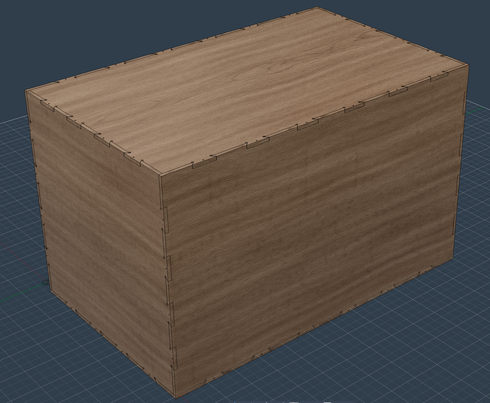

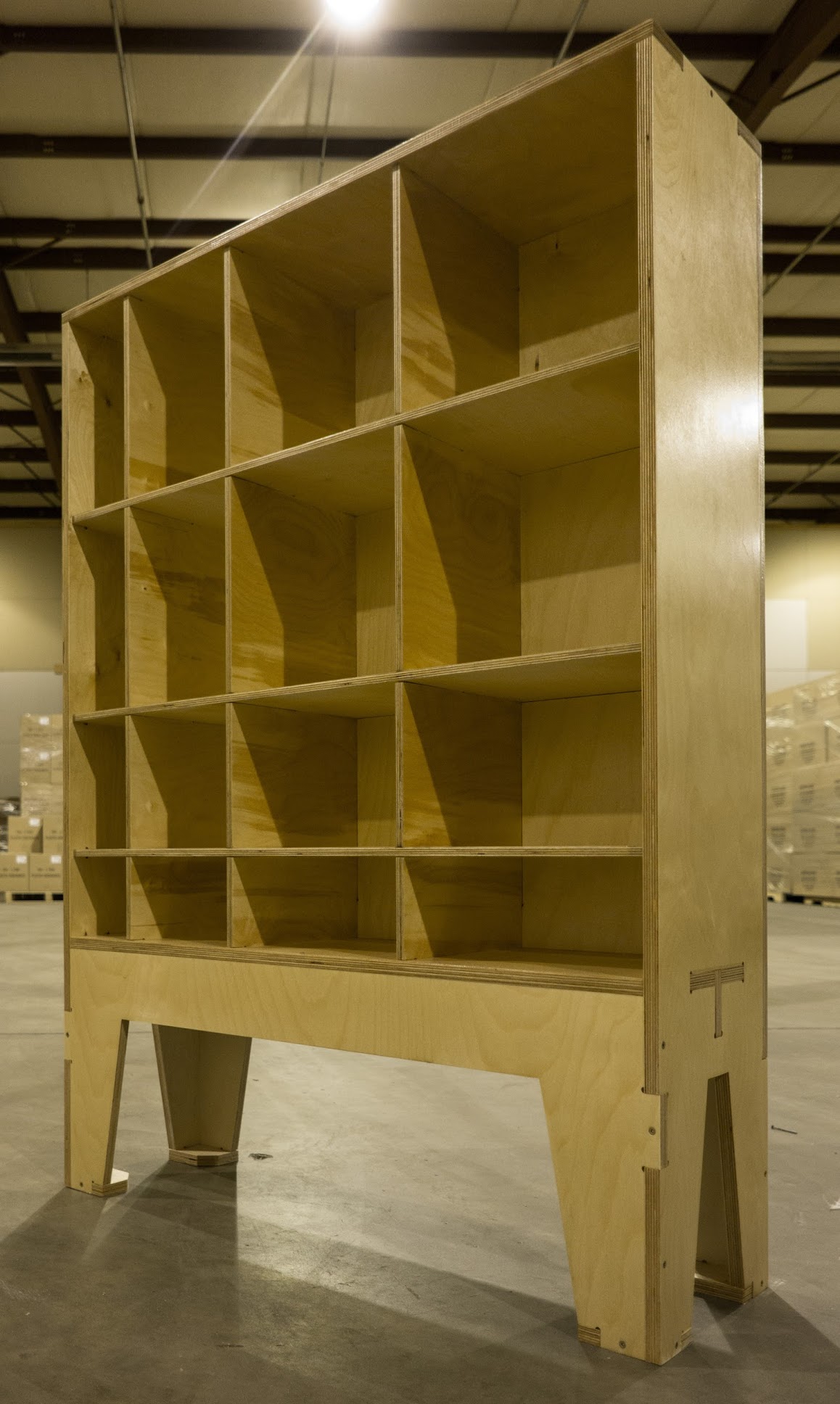

 ![OpenDesk Lift Desk 4](https://canada1.discourse-cdn.com/flex027/uploads/avidcnc/original/2X/7/7db9b9363d8bcd22c12127c5c928c9ffaa03c347.jpeg)
 ![AtFab Open Cabinet Baltic Birch 1](https://canada1.discourse-cdn.com/flex027/uploads/avidcnc/original/2X/b/bff4f2ee4a7d173cb08ff58c9cab91f36b3e40f6.jpeg)
There are a couple of things I’ve made using that method

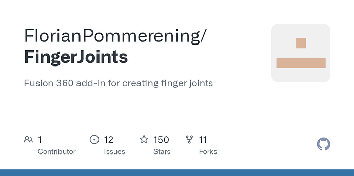

I use this plugin and it works great for finger joints. You can specify the gap between fingers using a value or a parameter as well. And it’s free!
> **[GitHub - FlorianPommerening/FingerJoints: Fusion 360 add-in for creating finger joints](https://github.com/FlorianPommerening/FingerJoints)**
