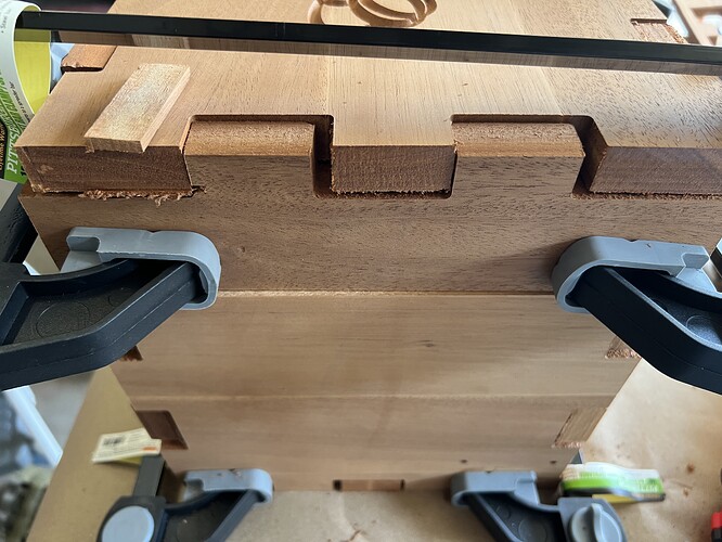

Hello friends. I created a box on my Avid 4848 pro, using the vectric box creating gadget. I changed the tolerance to 0.1, and changed to cutting outside the line. I did this after watching a few couture videos. It is not snug at all as you can see in the pics. Does it mater that I cut outside the line? Should I set the tolerance back to zero? Thanks in advance.

I don’t use the box thing in Vcarve, but I found a tolerance of about 0.005" to 0.008" is good for a nice tight fit. You do still want to cut outside the line, and on one of the two you add the tolerance. I talk about it here in this video: [https://www.youtube.com/watch?v=ID2WLf2jn6A](https://www.youtube.com/watch?v=ID2WLf2jn6A)
Let me know if that helps!
Corbin

Corbin! I ran it with a clearance of .005, it was a perfect fit.
