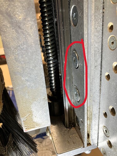

I’ve seen corners like that before when the feed or acceleration settings were just a bit too high. Even if the pinions are tight, the machine can still flex a little under load, especially at 3/4” depth. You might try a shallower pass or drop the feed rate 10–15% and see if it smooths out.
**Author:** ![carpsof](https://avatars.discourse-cdn.com/v4/letter/c/bc79bd/32.png) [@carpsof](https://forum.avidcnc.com/u/carpsof)\
**Post date:** [October 16, 2025, 4:11pm UTC](https://forum.avidcnc.com/t/why-do-i-get-these-nasty-corners/5361/22 "2025-10-16T16:11:39Z")
> [@Talvoryn](#):
Where do you change accel settings?
> [@Talvoryn](#):
I dropped the speed 25% and still had the problem.
**Post date:** [October 16, 2025, 8:47pm UTC](https://forum.avidcnc.com/t/why-do-i-get-these-nasty-corners/5361/23 "2025-10-16T20:47:39Z")
> [@carpsof](#):
You’re on a Mach machine right? There’s a good thread about that here: [Mach 4 Acceleration/ Deceleration](https://forum.avidcnc.com/t/mach-4-acceleration-deceleration/1123)
> [@carpsof](#):
Before you even reach for a software solution make sure your machine is mechanically sorted out.
**Post date:** [October 20, 2025, 10:46pm UTC](https://forum.avidcnc.com/t/why-do-i-get-these-nasty-corners/5361/24 "2025-10-20T22:46:31Z")
Pinions are tight as a drum, but I think I found the culprit. The Z-axis carriage mounting screws have worked themselves loose and the whole thing had a bit of pivot slop. I put some thread locking compound on them and re-tightened them. (I suggest other owners do the same). Fingers crossed this fixes it.
