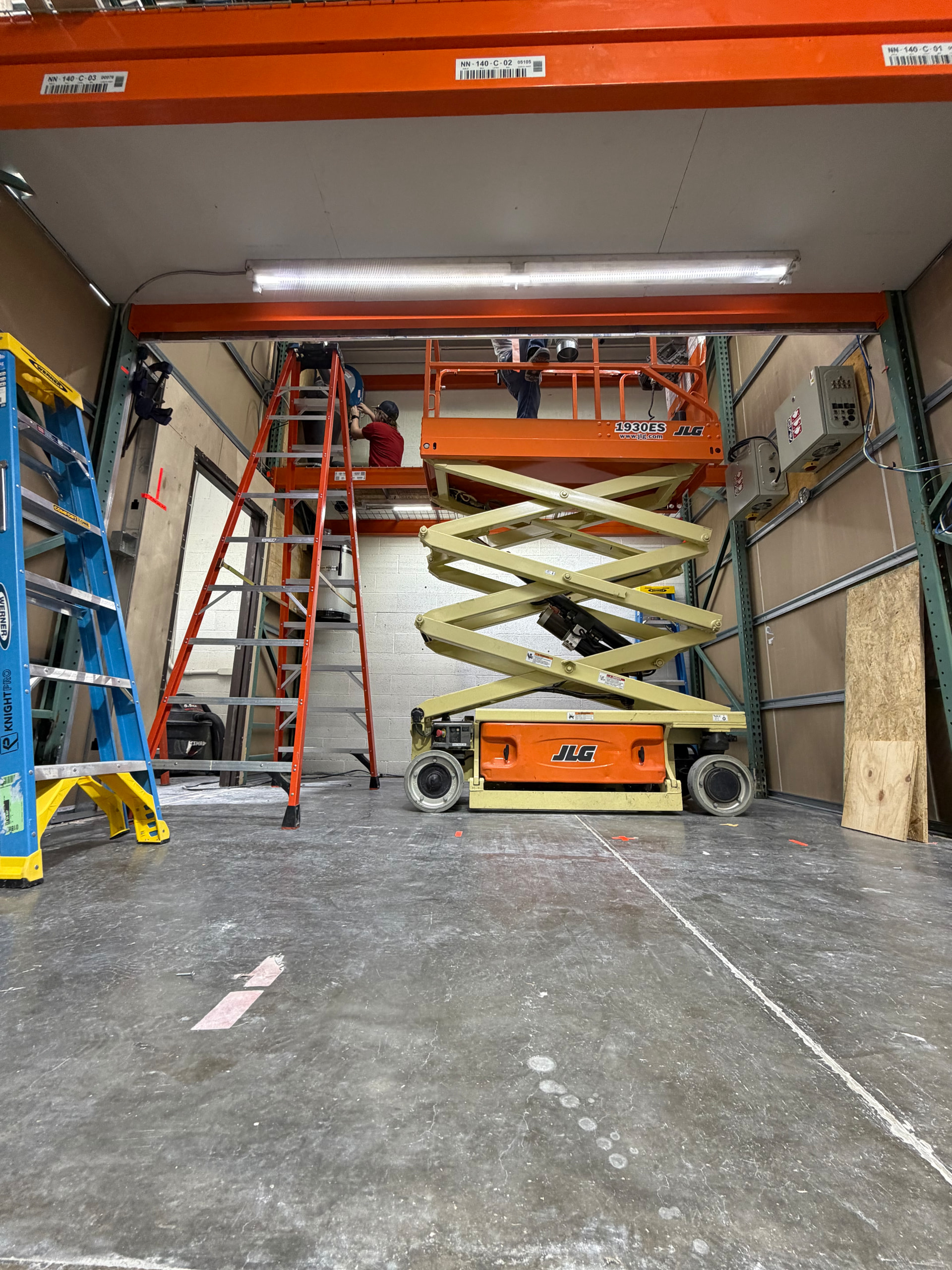

Any issues with wall mount spindle and motor box turned 90 degrees?
Curious if you experienced guys foresee any issues with spindle and motor control boxes mounted on wall just above head height turned 90 degrees to the right in below photo. Main reason for this is to clear the 2’ walking path and still reach disconnect switches from the ground, and help wire connections reach table. Long track side of cnc table will orient parallel 2’ off right wall. See attached photo. Tight on space and want isolate vibrations from table so not mounting on leg frame of table. Serviceable from step ladder as doors drop downward like a mini shelf.
Hey Andy,
I don’t think you’ll have any problems. Others have wall mounted their control boxes, though normally lower. I like your approach to table access. If the cables will run down the wall and across the floor, use cable floor duct to protect them from foot traffic and accidental drops.
Good luck with the rest of the build.
