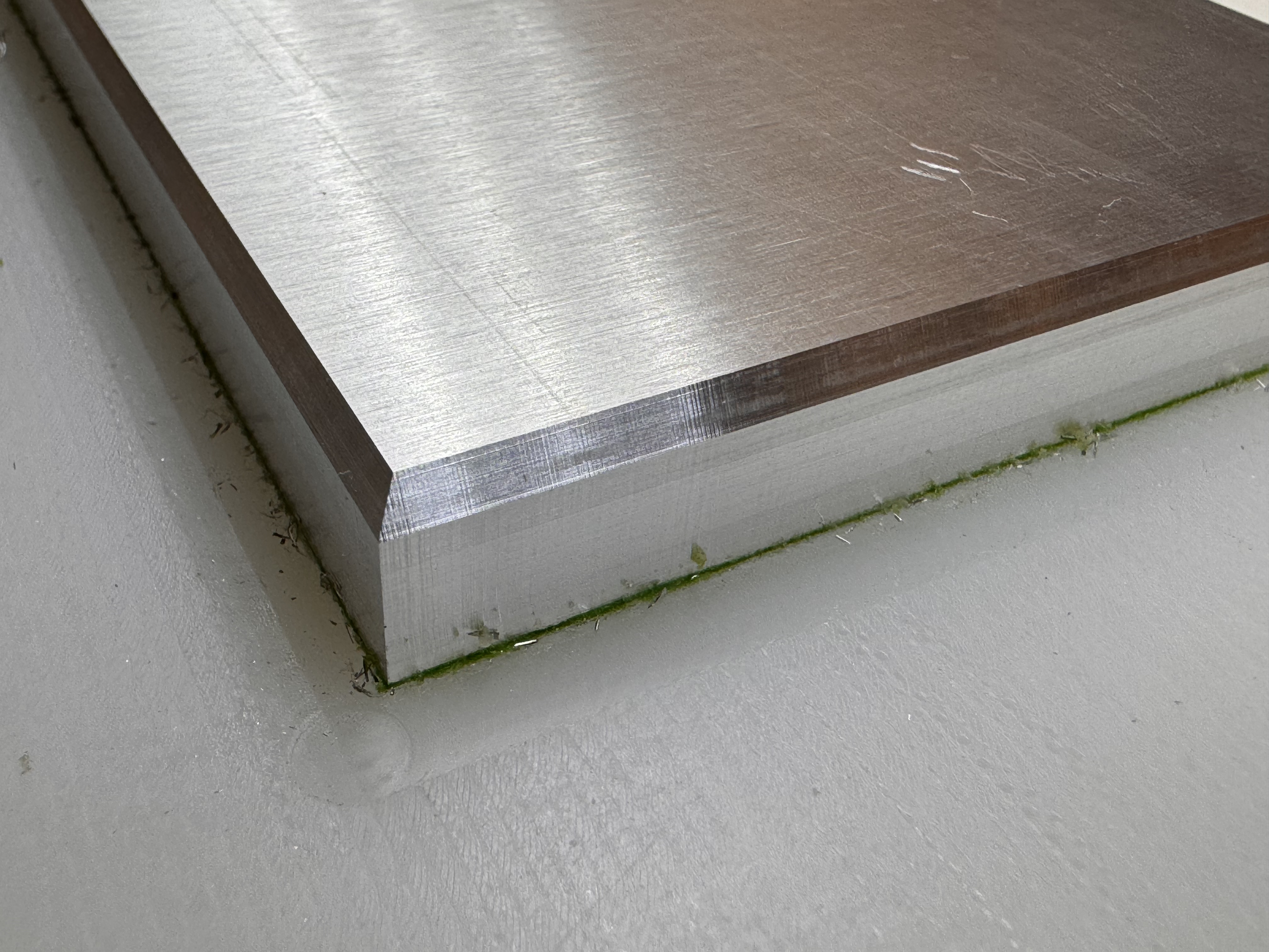

First time milling Aluminum on my AVID
I’m pretty excited about this! I’ve had my AVID PRO 4896 for almost 2 years and decided to try some aluminum plate 6061-T651 and I’m IMPRESSED. Here are 2 video links of me milling Aluminum. I’m going to also add 3 pictures to this message of a milled 1/2” plate with chamfered edges. 1 picture of cast iron milling as well. It cut like butter !

I have ZERO experience milling metals or alloys! I basically purchased some HDPE boards with varying thicknesses and Flattened both sides the put a recess close to the edge like a cutting board that’s designed to catch juices. Then i used the painters tape on both sides and superglue to hold the aluminum down on the table. this is my first experience with Aluminum on a CNC.
Check out the second video. For cutting oil or lube or whatever I just collected some random stuff around my shop and mixed a little of this and that in a spray bottle then sprayed it on a cheap paint brush.
