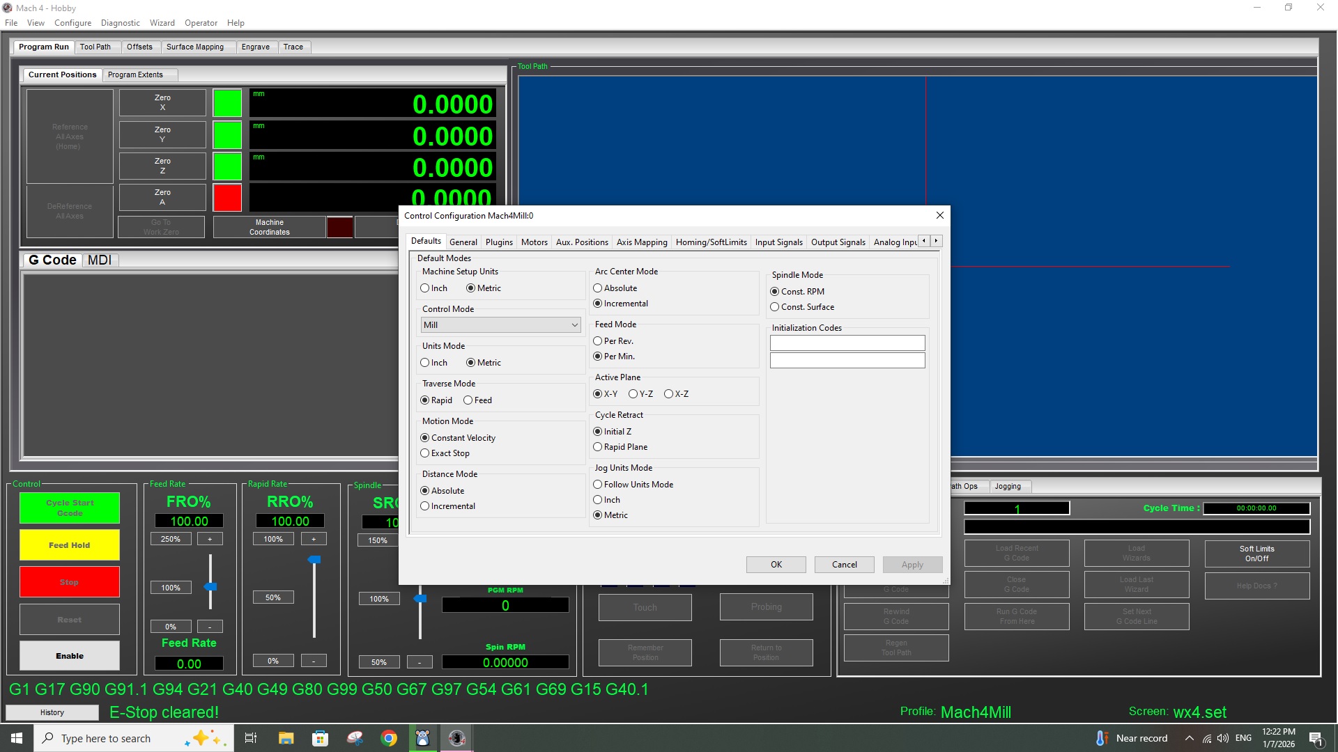

I suppose that its a mechanical or electrical problem, not a software. I have to change all leadscrew nuts to exclude backlash errors. Unfortunately I have only one spare nut. I purchased a new nuts online and hopefully get them by the end of this month. Electrical issue can be the wrong microswitches settings on TB6600 motor drivers. I had such problem from the very beginning because the factory switch settings were wrong. I re-switched them to 32 microsteps and 6400 pulses per revolution and it started to work…. but may be 6400 is not enough and I need to find another motor drivers…..
I found something interesting. The table below shows 10000 counts per unit. Maybe it needs to be 6400 for correct operation?
What machine are you running? This doesn’t look like Avid’s version of Mach 4 for sure…
No, its not an Avid version of Mach4. Its a hobby version. I made machine and control unit myself. :slight_smile:
maybe turn on Exact Stop vs Constant Velocity? Add smoothing in Fusion for your toolpath to 0.001”.
I’ll try exact stop tomorrow. Today I changed X-axis nut and also used motor Counts per unit in Aux.Positions. I started a longest G-code and checked a zero positions after. Looks like X-axis error gone. Need to start it several times to make sure. I usually use smoothing in Fusion for curved surfaces. Not sure it will work for pocketing. I made another zero point in the low left corner and modified the program. It works good - thank you for advise!!!
