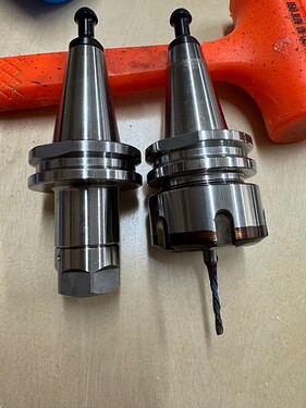

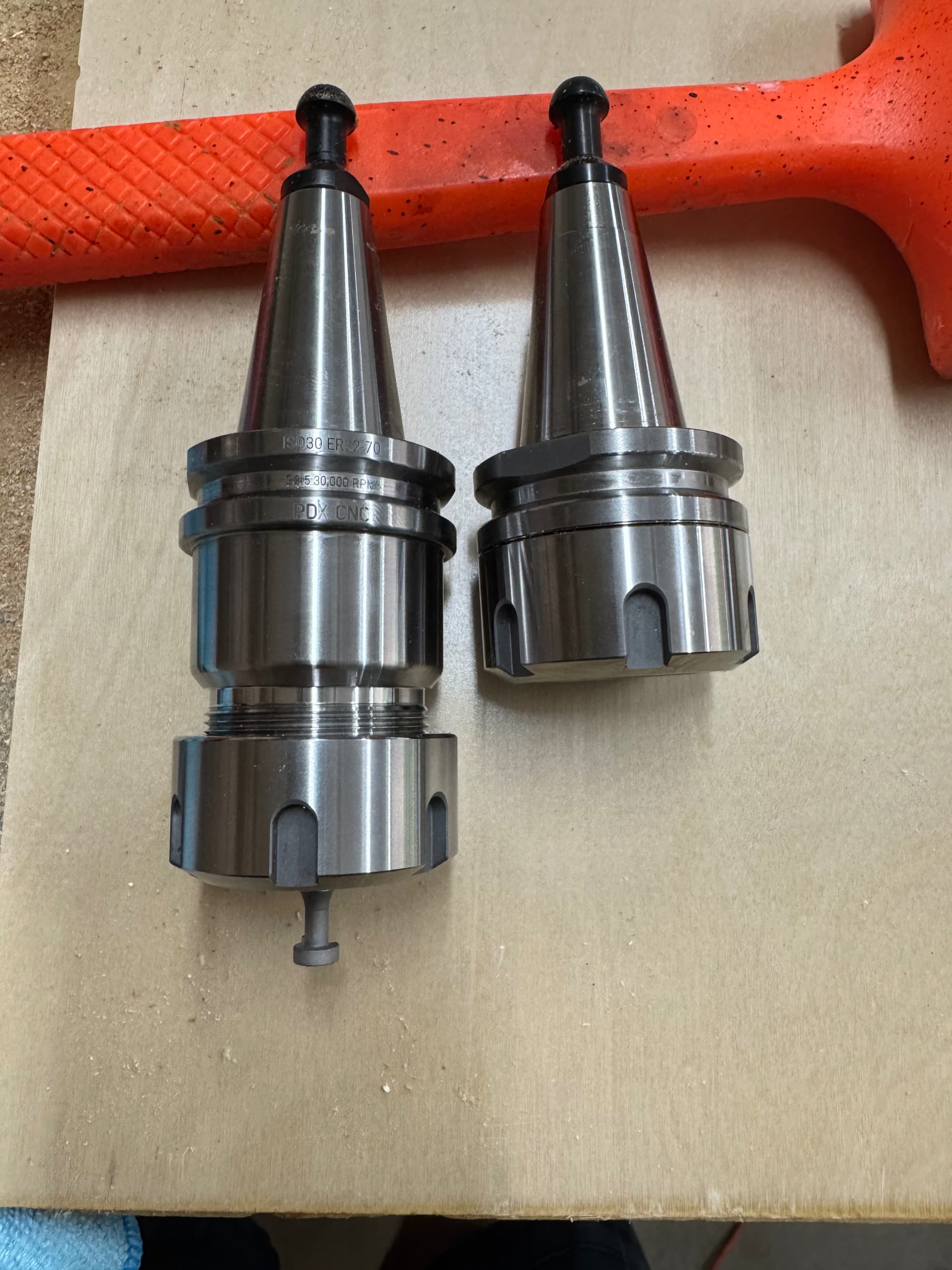

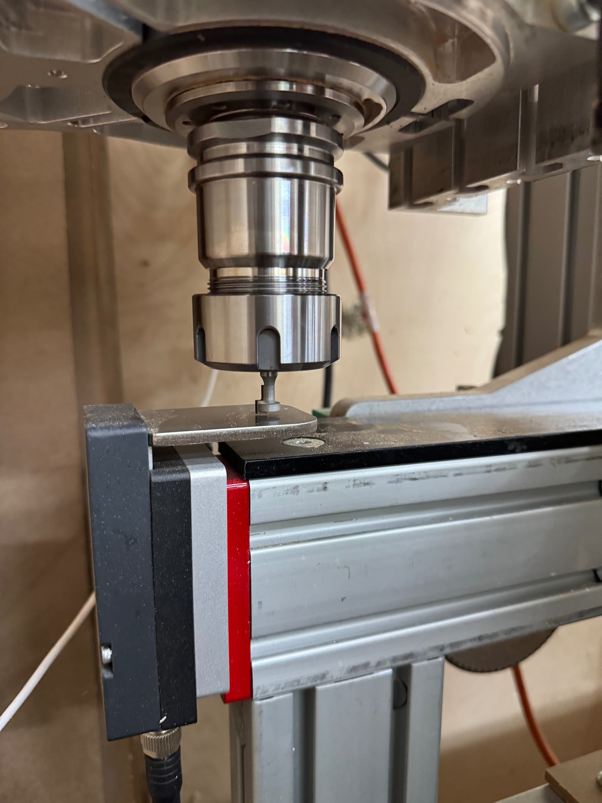

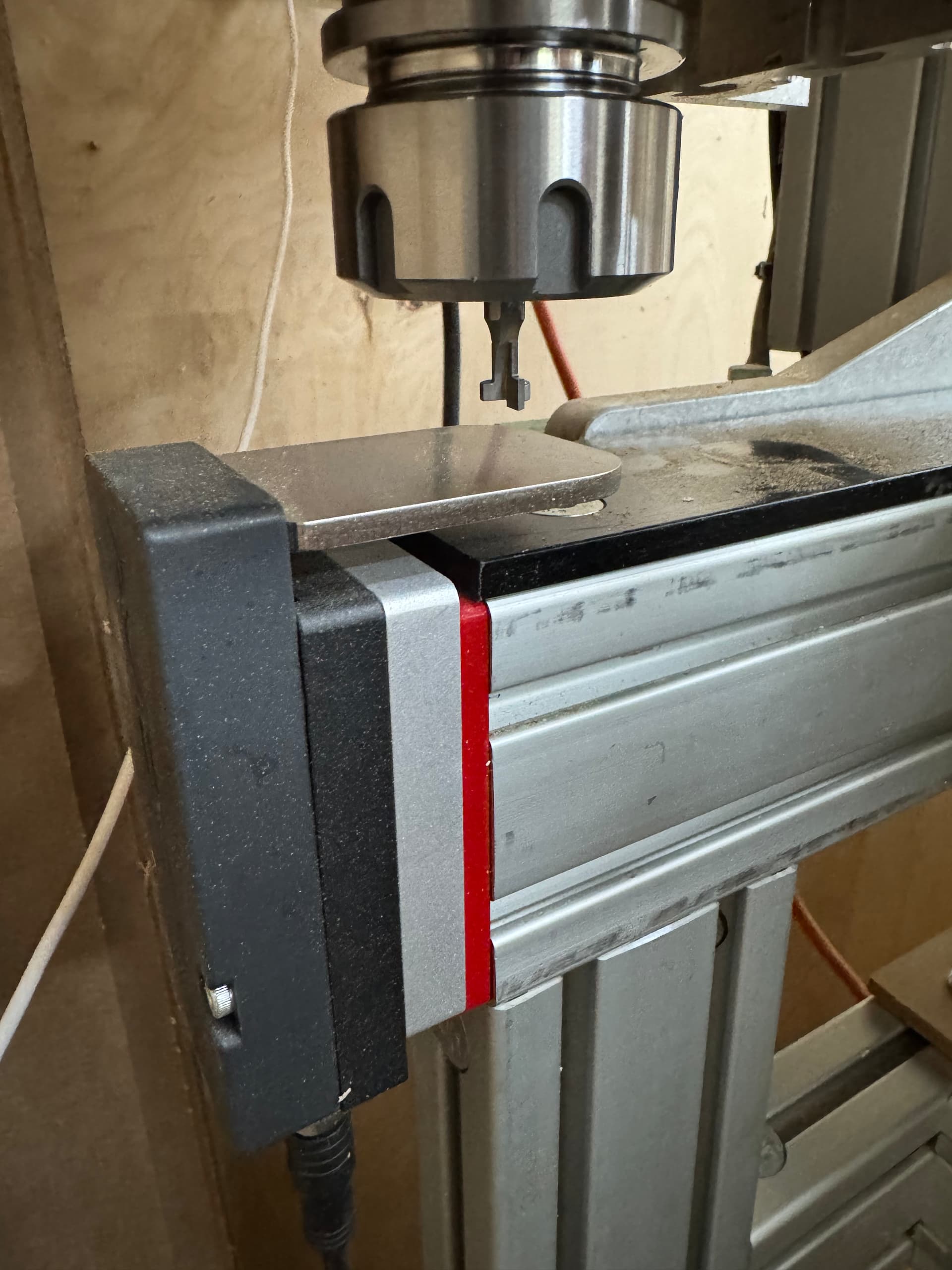

I have a couple of short 1/4" shank bits I use regularly – a keyhole cutter and 5mm drill. When properly inserted into the collet, the bit won’t reach down to my tool height sensor.
I picked up a couple 70 mm ISO30 ER32 tool holders from Portland CNC. Now the tools easily reach. Note – I have no connection to this company, just found them via google. Product seems very good.

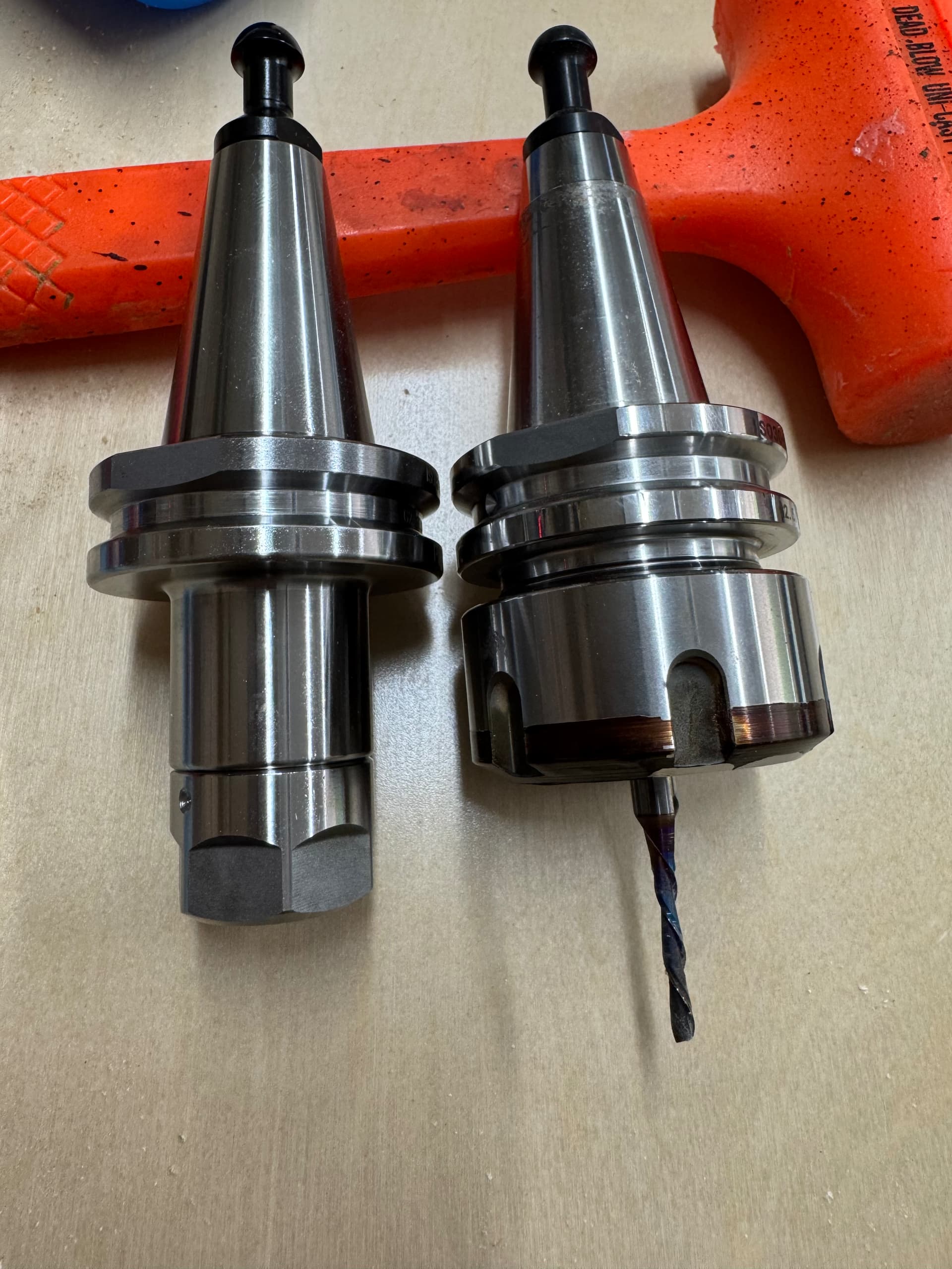

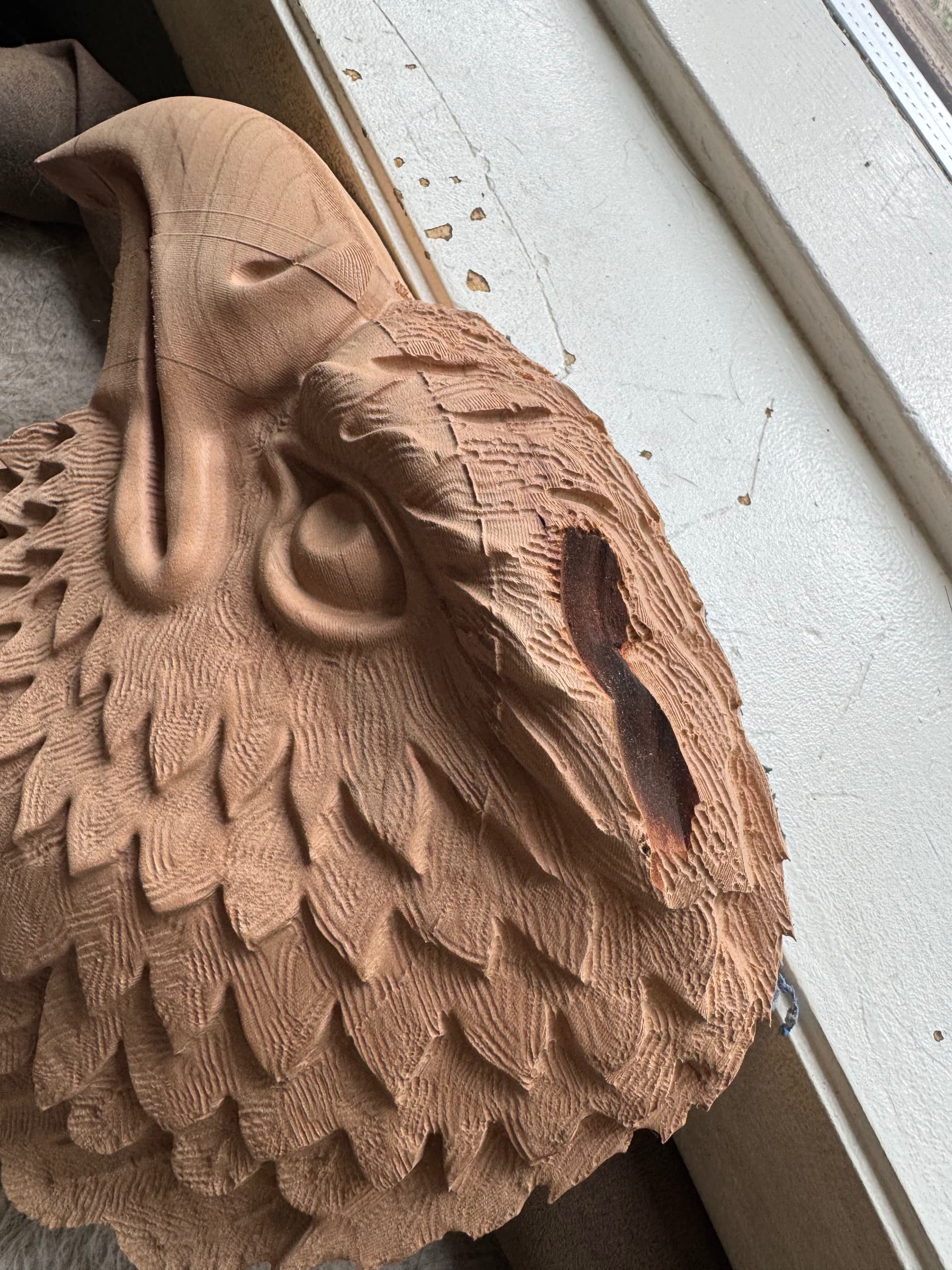

I also picked up a 70mm ER16 to hold use when doing a final contour cut on 3d models. I recently accidentally hit a carving with the standard tool holder and, well, that didn’t turn out well:
Here is that ER16 model next to the standard one that did some fine collet nut shaving
Those long tool holders are a great solution.
You could also slide your spindle down lower on the drop plate too do you wanted. It looks like you wouldn’t need to lower it that far for those tools to work.

I always get the 40/45mm tool holders and thought “why would anybody want a longer toolholder?” Never thought of this situation!
