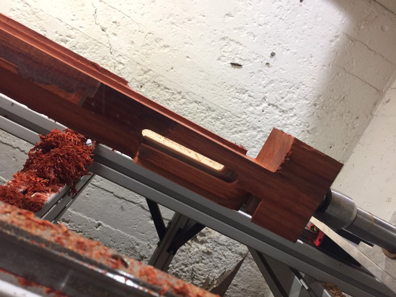

I make spearguns on my 4th axis using fusion. I’ve done them both with the rotary tool paths as well as indexing each side. I’ve found that machine time is reduced using the rotary tool paths but i’m just doing it as a hobby so if it’s take a few minutes longer it doesn’t matter and saves me lots of money not paying for the rotary package. Once you get used to setting your tool orientation indexing each side is very easy and you have lots of tool paths to choose from.
Couple pics after finishing passes.

Is that mahogany, teak, Bubinga, beautiful-looking oily wood! nice work!

It’s Padauk. Machines nicely as long as you’re careful around any sharp edges for chipping.
