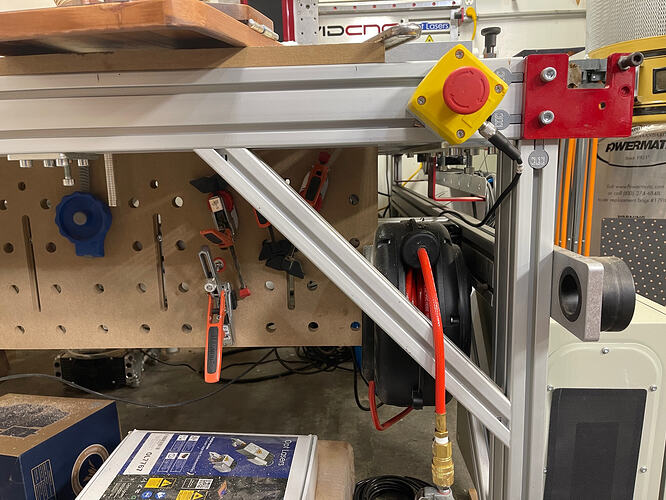

Here is the angle brace shipped my new machine last January. These are drilled such that a rolling T-nut and a hex bolt can fasten them into the adjoining members.

What is this device you have attached to the front?
That’s the tool tightening fixture that comes with the new smart spindles for ISO30 taper tool holders.
Ok nice
Yes, it’s definitely a need to have item. It works great! I also added a 1/4” retractable hose reel under the top to keep a blow nozzle handy or plug in the composite nailer.
