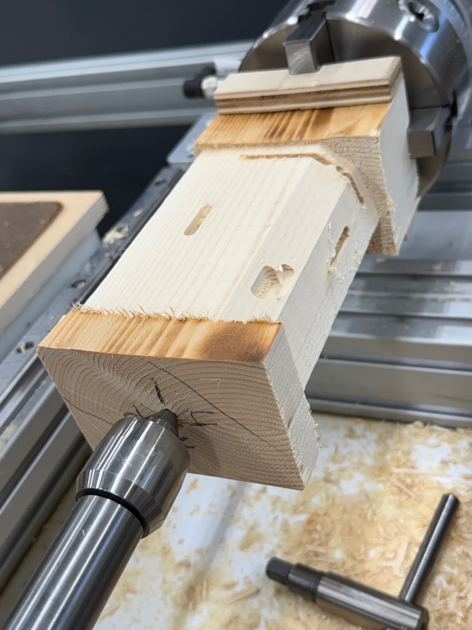

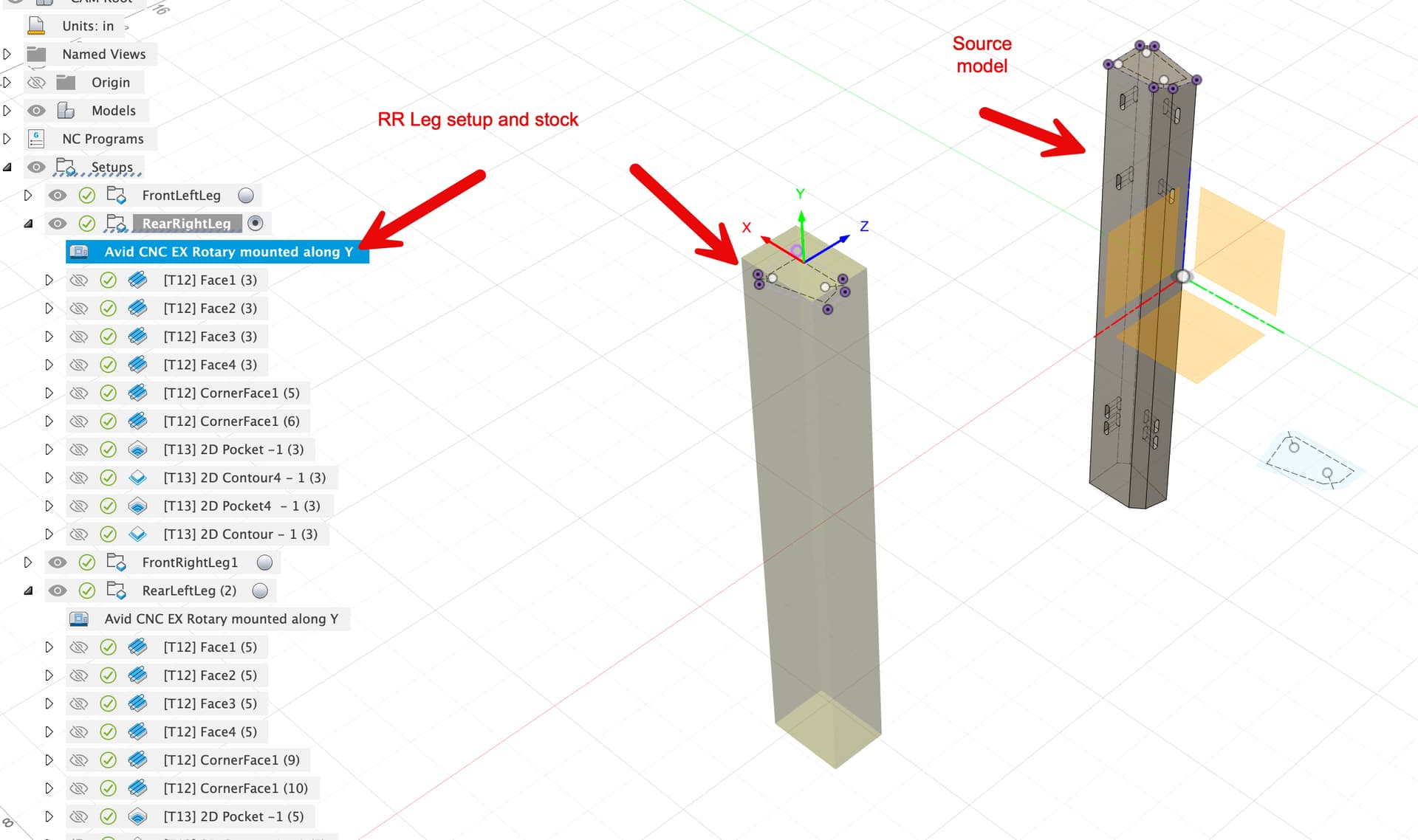

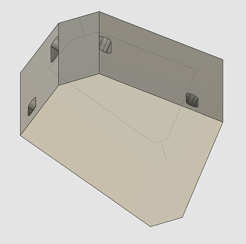

First of all I am not sure what is causing this, the post processor, fusion, or a few brain cells shorted out. I am trying to cut some table legs for an angled table, yes I could do this on my table saw, but figure this would be learning exercise for the rotary. There are two issues I am experiencing with cutting this, both come down to the X axis coordinates created in the post seem to be wrong. I was able to machine both front legs and they look fine, however when I went to machine the Right Rear Leg, ( 4th manufacture stepup ), on the first Corner Cut (5th operation), what happens is the bit does not cut all the way through. Instead it ends short of the full width of the corner. If I extend the pass by .7-1 inch or so I am fine, but on the simulation it works perfectly, just in real cutting it does not. And looking at the generated gcode and moving the spindle to where it says, it is doing exactly what was processed. (this issue was present in both front legs as well, but I just put the in the compensation and proceeded.

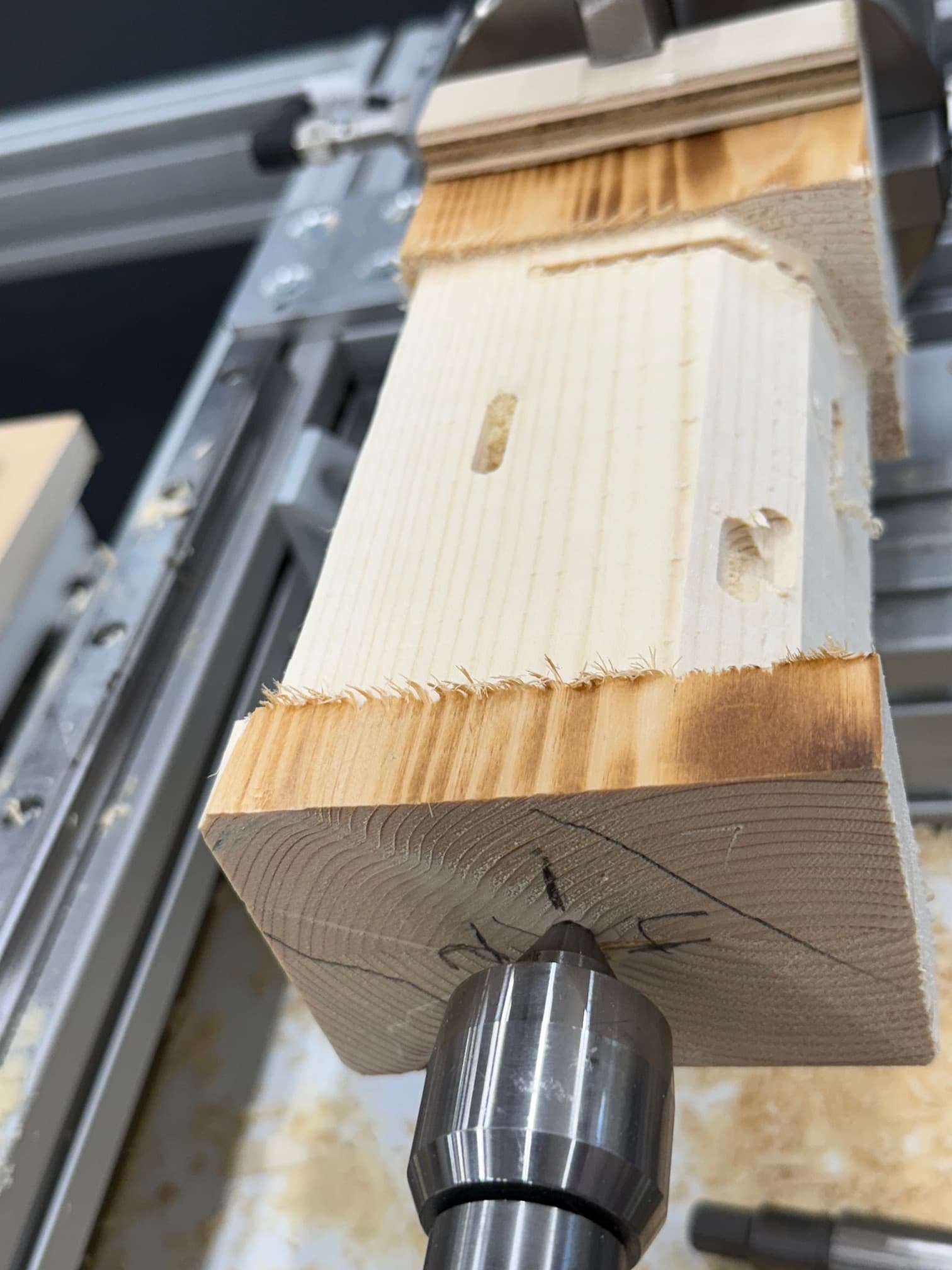

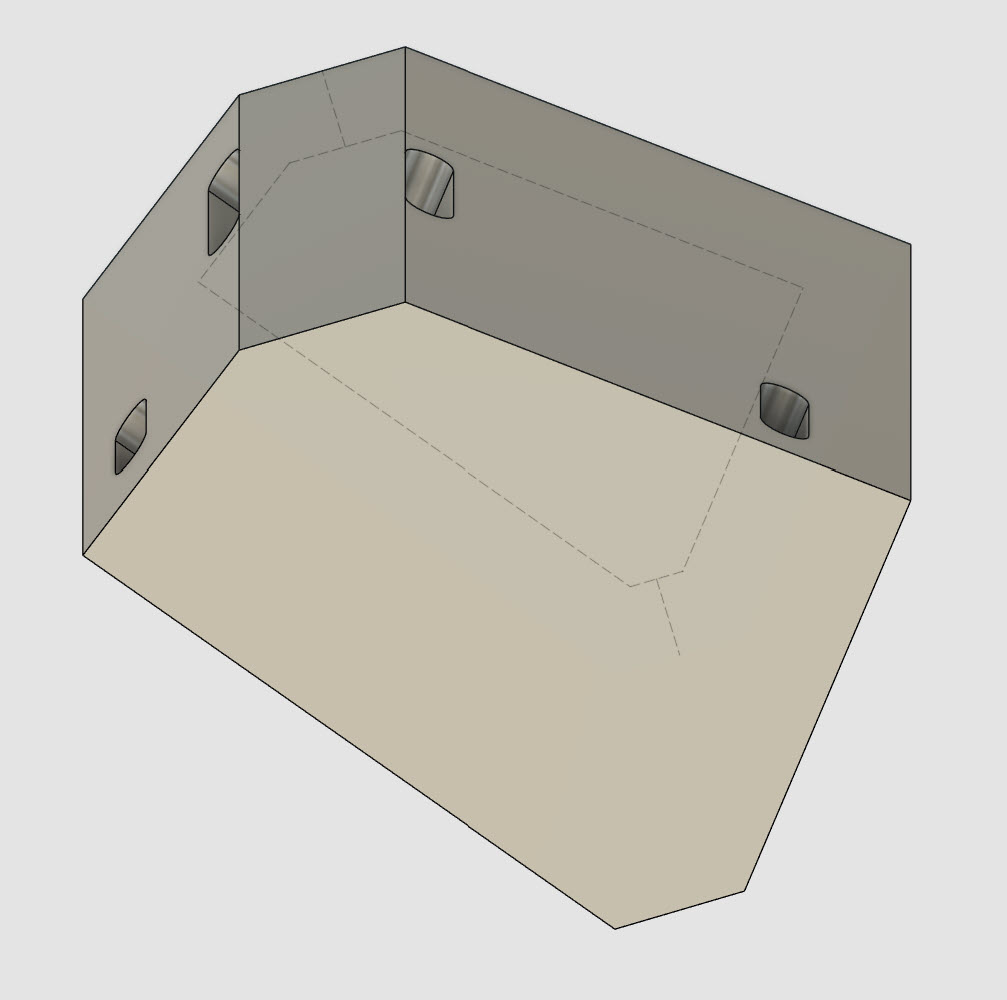

Second issue is when I get to the 2D Pockets, these are pockets for dominos, these pockets on the first side in the Rear Right Leg setup was totally off. Instead of putting the pockets where the should it seems to have moved to the wrong side, where the X coordinates are off. And really looking at it, things are even what I would expect backward. My rotary is mounted along the Y axis with the motor at the max Y limit and max X. My setup is shown in the image below, along with what it actually cut, like it rotated it. And since I am not in the shop now, I am going to have to go look at the two front legs closer to make sure things are where they should be.
I have attached the entire fusion 360 file of the entire design, the resultant gcode for this setup. Please don’t be too harsh on the design :wink: But if any one can see why this is not cutting right, please feel free to smack some monkey knowledge into me. Any help is greatly appreciated, especially before I give up and use the table saw and then end up cutting it 23 times to get it right there as well…

I took a look at this and I don’t immediately see a “smoking gun” that would be your problem, but I do see a few head scratching things in your setup…

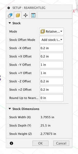

For some reason your stock on this setup is far away from your source model… I’ve never seen that before, that could potentially be an issue
Another issue that’s gotten me a few times is using “relative stock”. I like to be explicit about what my stock is if it’s a cube or a cylinder. If it’s anything else I draw a solid for it and use that as the stock.

  • Entire part is rotate along the y axis. In fusion the +Y axis is facing away from us, on my machine that rotary is mounted along the Y axis with the chuck at the far +Y axis. If there was a chuck in the drawing it would be at the back where the sketch is lightly shown. Why is it not cutting as it is defined in CAM with the Y0 X0 is at the back of the part?

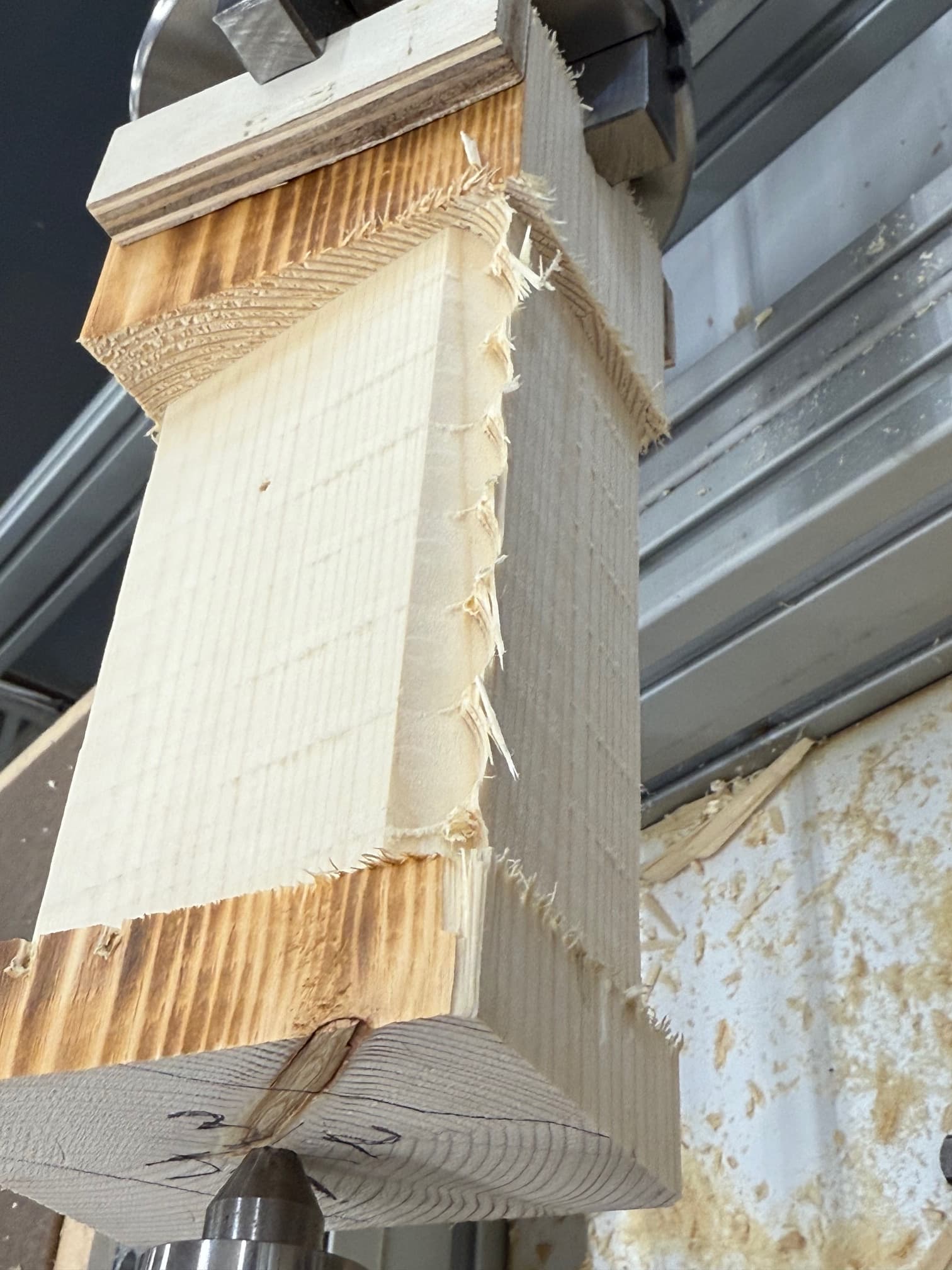

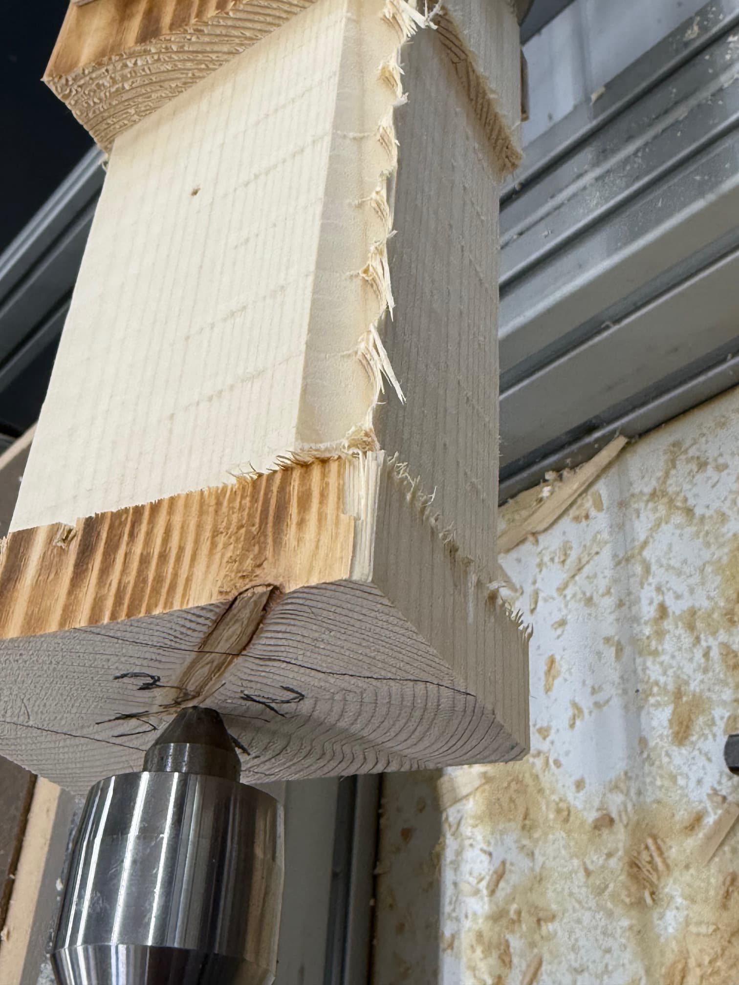

  • There is some issue, which I believe is related to the first, where when the part is rotated to cut the corner there is an issue where it does not fully cut on corner, in the simulation of Fusion 360 this cuts perfectly fine, and shows the bit where i expect it, in actual cutting it is offset, and never full cuts the corner between faces 2 and 3.
  • When it rotates to cut the slots, it does not seem to be putting them in the same offsets as the first 6 operations, and we no end up with the slots being cut into the corner ( since it is on the wrong side. The slots appear that the would be in the correct position if part want not rotate around the y-axis for the first operations.
  • I have numbered the faces and put a mark of which faces it should cut the angle tops and and even before cutting the piece show here I knew it would be wrong, because face 1 is the face on the fusion drawing facing up to the right and face 4 is the one to the left both with the slots in it. However when I rotated it prior to cutting based on the G0 A0 commands and labeled the end of the piece with the face numbers you can see that the intersection of face 1 and 4 are on the top right, not top left.

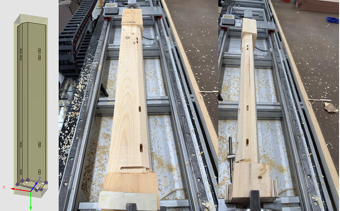

You can see if I am looking at the end from the tail stock position, the top is face1, the right should be face 2, but it is face 4 from what it is really cutting in the pictures in the previous post. The Y axis is pointing in the positive direction toward the chuck, I wouid expect the actual cut to mirror this. Is it rotating the opposite direction from what fusion 360 is expecting? Is there somewhere where you can change the direction of rotation?
Tim
Also you notice this is what fusion thinks the cut path should be for the first corner cut, however it is not positioned correctly I beleive because it thinks the cut should be to the left of where it is, exactly like fusion is showing, but the code that is generated is off to the right side. This pic of the actual cut was rotated after it was done so it is not in the right orientation, should be more rotated to the left so it would be parallel to the cutting bit (between faces 2&3)

SOLVED! The Autodex Fusion forum nailed it! Thanks to Scott for pointing this out. “you need to flip the rotary axis in the machine definition” As I said, my chuck is at the Max Y of the machine, the default Machine on the cloud expects it to be toward the Y0. So that is why the axis appeared to be flipped. I downloaded the machine profile, and edited as he suggested, saved it to my cloud, updated the setup, regenerated, posted, and recut…. and well everything works as expected. Something simple but so very frustrating.

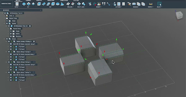

I don’t think this is the correct solution… we flip the spin direction of the motor seeping on how you have it mounted on the machine. So if you have your chuck facing towards Y- it spins “backwards “ and if you have it pointed towards Y+ it spins forwards.
This way it doesn’t matter which way it’s mounted as long as you have it set properly in the CNc12 wizard.
This was done so that you don’t have to have 4 setups, only two: one for rotary mounted alone X or Y
We provide machine profiles to support this: Fusion 360 - CNC Software

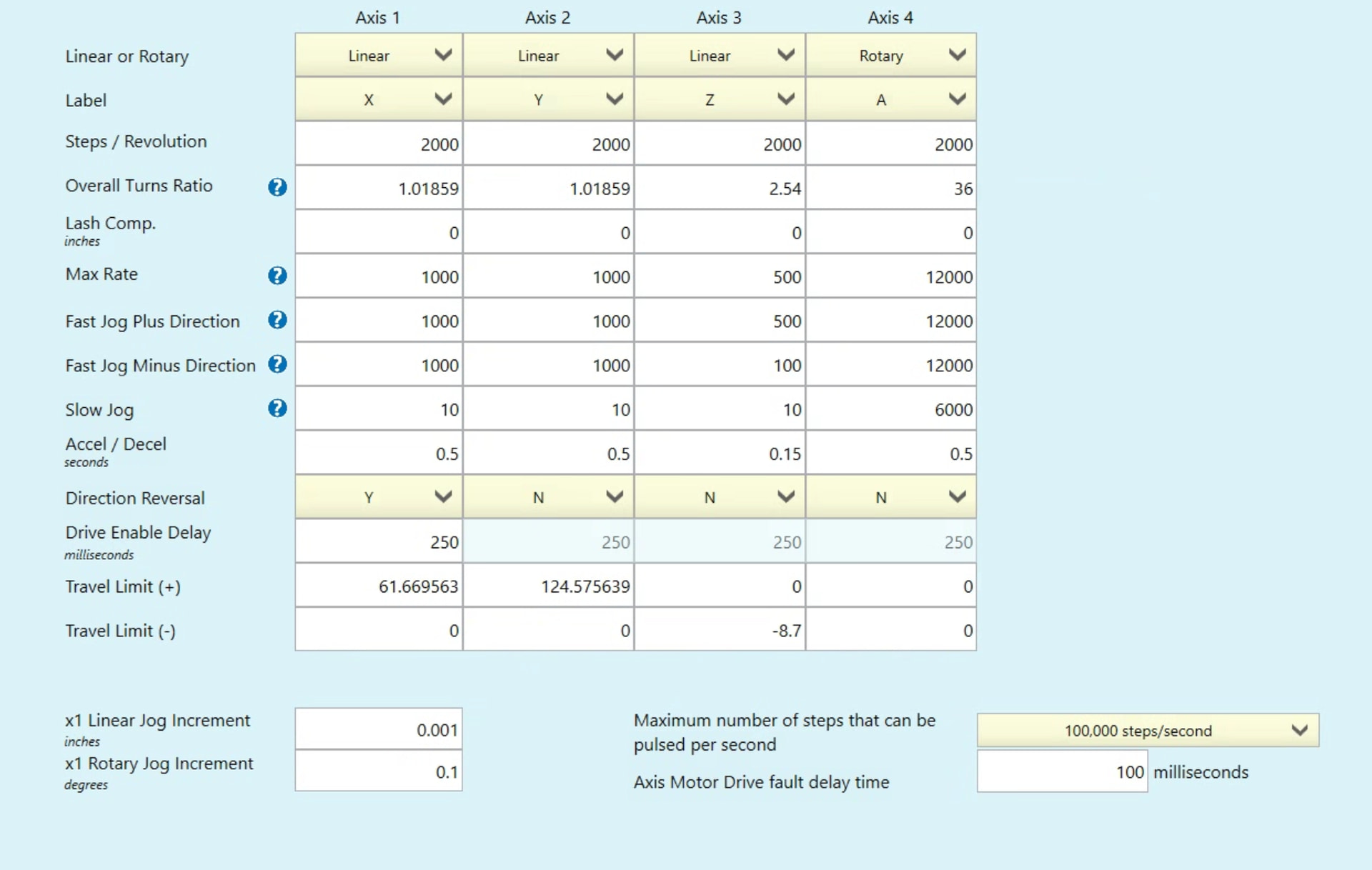

Can you send me a picture of this screen from your Acorn wizard:
and can you send me a picture of an overall shot of your machine that has the rotary in it.
