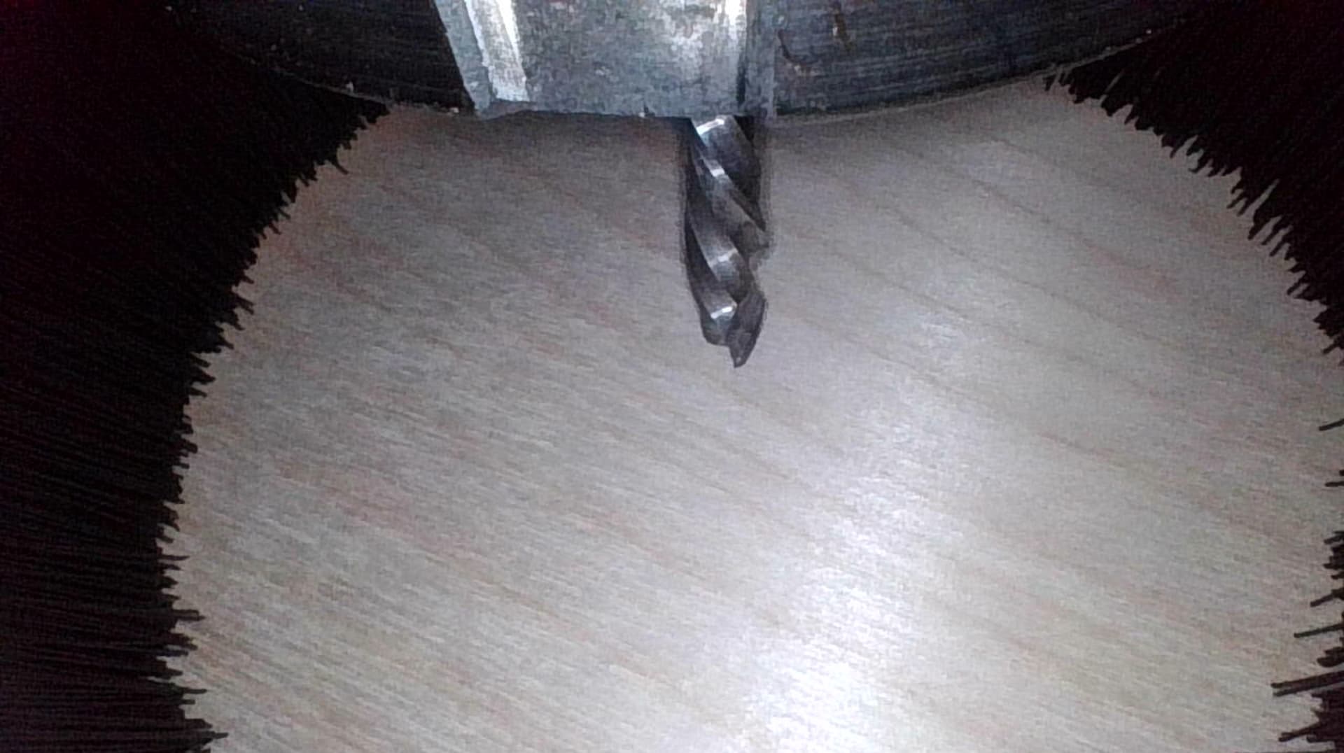

@djdelorie I think I am developing your sticky tool issue. The first tool of the day take a moment longer and pops out with some force.
[EDIT: Video was move to the correct channel ]
Try a bit of this:
I wonder though if the stickiness might be made worse by debris in the taper? Neither of us has an air-clean setup for the tapers we install.
Or the spindle warmup routine isn’t warming it up enough.
I leave the vacuum on during the tool change and that seems to keep the dust from sticking to the taper. As the tool holder is inserted the air flowing out of the case also seems to keep dust from being caught in there. I do check it once a week and haven’t seen anything stuck up in there.
I also do the new warmup routine. It takes about 14 minutes or so and I make sure its at least 90 to 95 F before starting.
So where do I put this stuff? Just hose it down? Put some behind my ears for good luck :wink:
Thin coat on one of the tapers, then do a bunch of insert/remove cycles on that spindle. Or thin coat inside the taper. When I did mine, I followed it with a mostly-wipe of a dry paper towel. the tiny layer that’s left is supposed to keep the tool from sticking, or so say the folks at cncdepot.
Also, if the snag is after taper release but before drawbar release (i.e. if it drops out of the taper but you have to force it the rest of the way out) you need the drawbar cleaning procedure - empty spindle, slowest speed, spray WD40 up into the drawbar mechanism[*] and let it drain out along with any debris.
[*] specifically, aim for the gap between the draw cage and the taper’s ball race - it’s the ball race you want to clean

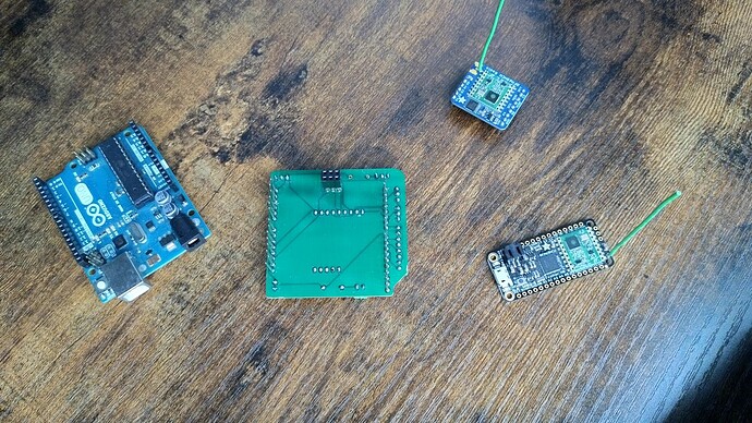

Blast from the past! Here is my custom PCB (cut on my PCB mill, solder masked and assembled by yours truly) and Arduino Uno running Grbl that drove the original carousel.
The communication was via LoRa radio.
Not pictured is the 5v induction sensor for homing and a 5 v pressure sensor for the drawbar line.
This was traditional steppers and ran on 48v using a drone power buck to power the Arduino.
It was in service until the resistor for the pressure sensor fell off. These days I do only surface mount (SMD) designs because of this very PCB. I still do rivets for through PCB connections which is required to make a two layer PCB but this is a single layer board!
