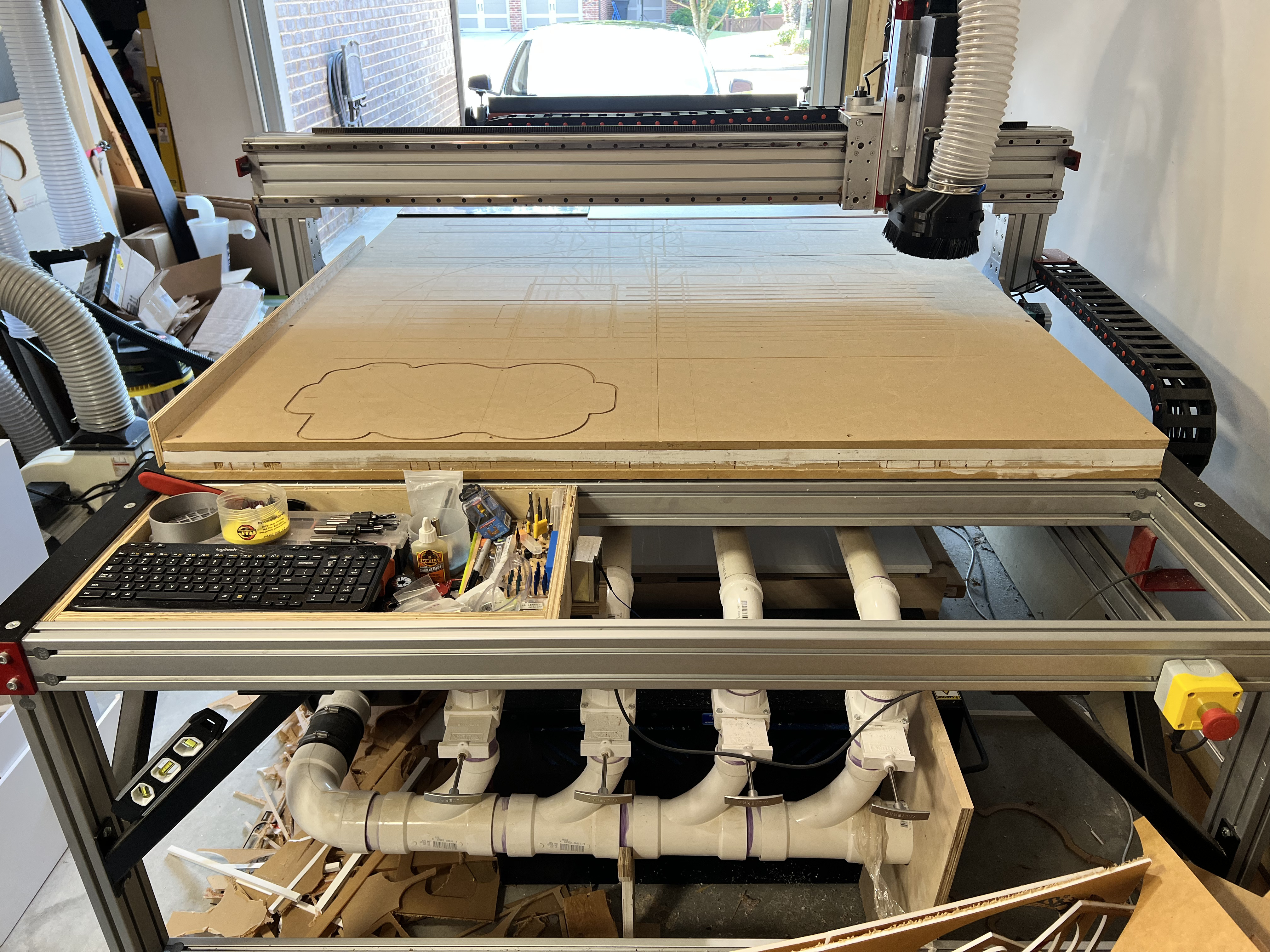

I just bought a 4x8 pro second hand and I bought a hurricane to go with it. I have vac board cut and the manifold plumbed, I just need to run 4 pipes and glue on the top spoil board… I am 600 miles away from it, so I’ll get it dialed in on my next trip to my new shop. Once I get it dialed, I’m planning to batch out a few vac boards and offer them for sale. I’ll use a latex paint on the outside faces and ship in 4 sections so it will operate in zones without using a gasket. Not sure if there’s a market for that, but there’s only one way to find out.
Sounds like it is a decent product. Mine is a 5x10 so it is on the outside of its capacity. Hopefully I can figure out how to use the zones to be effective at all sizes - but especially so on the first 3 feet where most of my work will get done… Any suggestions or plans on how to build a proper plenum? It sounds like you are on the right track- sealing things with latex paint. Is there any value to building the honey comb areas out of 4/4 MDF and creating a larger/deeper low pressure zone from under the situation? I am not an engineer and lack the science to figure out the values…
I built my own for about $1000 and a day of labor. For the plenum I used 3/4 Baltic birch sealed with polyurethane and routed a grid for all star gasket material. Plumbed this all with 2" PVC to the plenum and 3" PVC from the vacuum to the shut of valves. I am using 4 motors and split them off into pairs on a switch for each pair. I am using ultralight MDF for the spoilboard. From my research the central vac motors are high CFM and low vacuum so the extra flow of the ultralight helps maintain the vacuum pull.

I’m not sure what the vacuum bed plenum looks like under the spoil board, because I didn’t make it and I have not removed the spoil board yet. But it seems to be 3 layers of MDF for the vacuum table and the top MDF sheet is the spoil board. Looking at the underside though, the first layer has a bunch of dog holes, so I’m wondering if the vacuum bed is just sitting on top of that and is just 2 layers, not 3???
It has 4 zones plumbed to the Hurricane with individual valves. With this setup, it’s actually a 5x8 cut area not 5x10, but that is fine with me for how I use the machine.

The biggest thing is having and inline air filter. Anything getting into the suction side of the motor will kill it in short order. I got a canister filter with 3" inlets cheap from Alibaba.
Ill try to give an explanation with some additional pics. Everyone’s needs vary so you can tailor this basic concept. The picture of the motors in the last post is showing the cooling air side directly in front. on the opposite side is the suction side. Vacuum pulls from there. this is what pic 1 PVC manifold is attaching to. The snail shape part pointing down is the exhaust. I put some cheap mufflers on this side. Basically foam lined PVC. You can buy most of this stuff through central vac suppliers. The 3" PVC in the pic below is the mounted to the opposite side of the motors in the first post picture. I used toilet flanges siliconed and screwed to the box that the motors are mounted to. You will need to order gaskets for the motor side and not tighten them down too tight. I used bolts with double nuts to “suspend the motor on the bolts while tight enough against the gasket to seal. Upstream from that would be a canister filter from there it goes to shut valves for your zones Pic 2. After the shut off valves transition to 2” PVC to your plenum. Pic 3 is the underside of my 3/4 baltic birch plenum surface. Pic 4 is the top of the plenum. It is not hollow. It is a simple single sheet of material bolted to the CNC frame. The plenum is created by using the routed grid pattern, spoilboard and gasket material in between the two.

For the spoil board and vac board… 1/4" deep x 1/4" wide grooves on a 2" grid pattern are all you need to distribute the suction. Run 3" to your manifold, then 2" to your valves and your vac board. For the Vac board, I would recommend something like 3/4" Medex MDF. You can order it at the pro desk at Lowes. It’s moisture resistant, so humidity changes won’t hurt it. For the top spoil board, skim off a 1/64" pass, then flip it so the skimmed off side gets glued to the vac board… Once it’s glued down, skim the exposed face… Use CHEAP 3/4" MDF for the spoil board. You want it to be porous and pass air. You can paint the edges of the spoil board and you can paint the edges and bottom of the vac board.
One last detail… I’ve noticed that under vertical pressure (drilling, ramping, plunging) the spoil boards can flex between the Avid’s crossmembers. It’s no big deal if you’re doing cookie cutter type parts. If you have precise pocket depths or are carving, I would recommend adding support along the edge of the Y axis. I used angle iron bolted to the 80-20 tubes. You could also cut MDF strips and attach them to the 80-20. I also ran a piece of steel down the midpoint of the machine because I need ZERO movement in the spoil board.
Do you have a sketch or drawing of the plumbing that you did for the Hurricane and for the plenum and zones? is there value in setting the zones to different percentages based on the time and area that I use most? I want to be able to cut out cabinet parts as well as fine 3-d carving in less-than 12" square pieces.
The last pick @meangreen619 posted is what I would recommend. 4 zones works really well. I would skip the gasket material, but that’s me. I have always covered unused zones with a rubber mat. I use toolbox drawer liner from Lowes. It’s easy to cut to size and rolls up for storage when not used. These vacs are strong, so you don’t need to have perfect coverage, just get most of it. keep your zones simple and just cover the unused portions.
