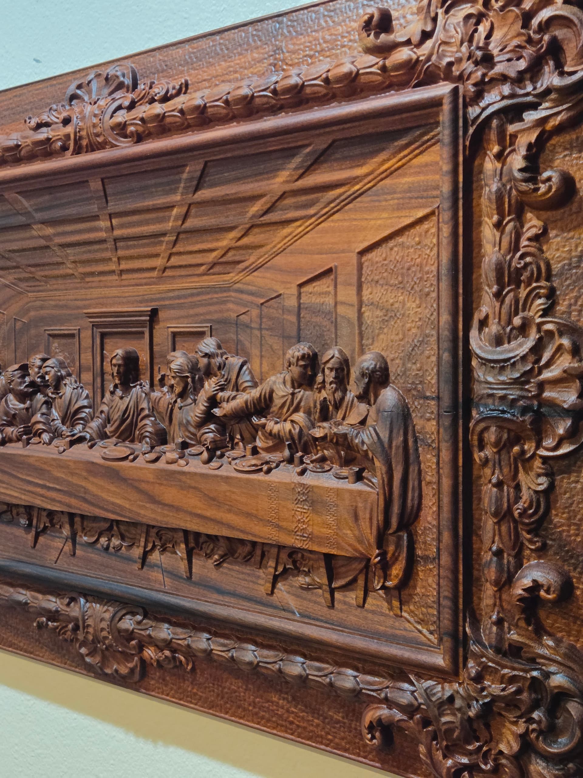

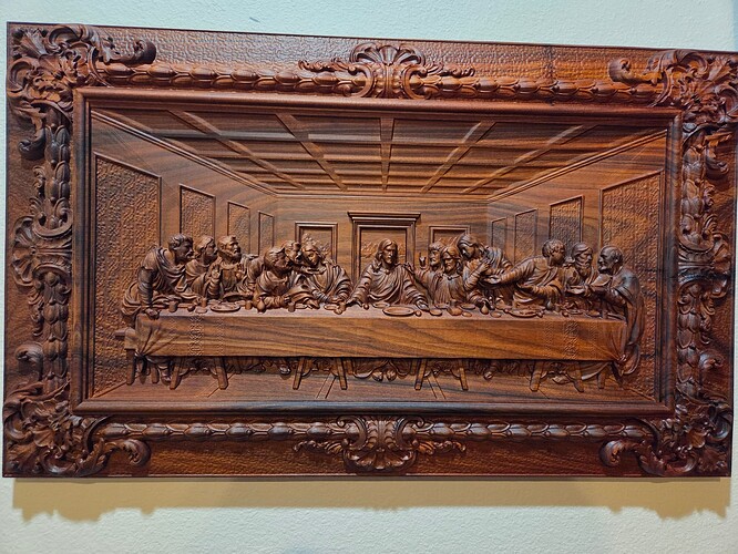

So I have been making Last Supper carvings for years now. The most popular size is 26 x 16 or so, this can take upwards of 40 hrs to complete, not a problem they always sell. here is the thing I want to know, if I was in the middle of one of these jobs and had to work on a shorter projects, would having more than one WCS setup allow me to switch back to the LS job I was on without any alignment errors or anything? I know that once I calibrated my rotary axis it always shows the angle with a line in it next to the X axis.

Those are some beautiful carvings!

Beautiful work!!! Beautiful wood!!! If you have time, tell us more about your bit size selection - amazing detail - and finish process.
Thank you
Sorry to hear about your situation. Do you mind me asking where you got your file from? Amazing clarity?
I have been doing LS’s for a long time, the ones you find out on the web but the details were ok but not great, then I found the lady in Ukraine that sharpens the resolution I guess, to be honest I don’t know what she does, but it was worth the $100 I sent to her for sure.
Do you do much sanding on these? Looks super clean. So sorry about your wife’s health.
Zero sanding and thank you
