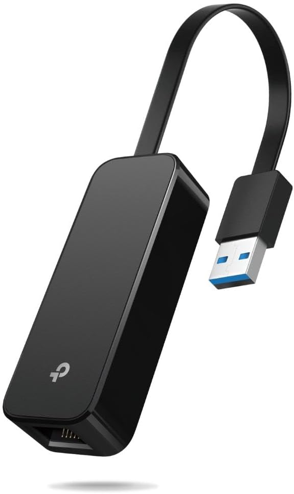

We are using the cable that came with the machine. Our laptop did not have an ethernet port so we bought an adapter (J5 Create USB 3.0 gigabit ethernet)

You might want to swap that ethernet adapter for another one… I’ve never heard of “J5 Create”
I have had great luck with these:
They’re cheap, made by a known brand and have never failed me.
I’d try that first. Sounds like you did a decent amount of other testing with the stress tests.
If that doesn’t solve it open up a support ticket with us and we can dig deeper.
Centroid in their tech bulletin 270, related to this problem, specifically says don’t use a USB ethernet adapter. We are seeing these errors after a CRP to EX upgrade … feeling like we’ve traded one mess for another.
That tech bulletin, while good was back from a time when USB>Ethernet adapters were not great. The reality is that on many modern computers it’s the only way to connect.
We have LOTS of them out in the field that are working fine. Ethernet communication issues are pretty rare as well.

Also, every now and then we find an ethernet adapter that just doesn’t play nice with a PC. If you have another ethernet adapter I’d recommend trying that (perhaps your PC has a built in ethernet port)
