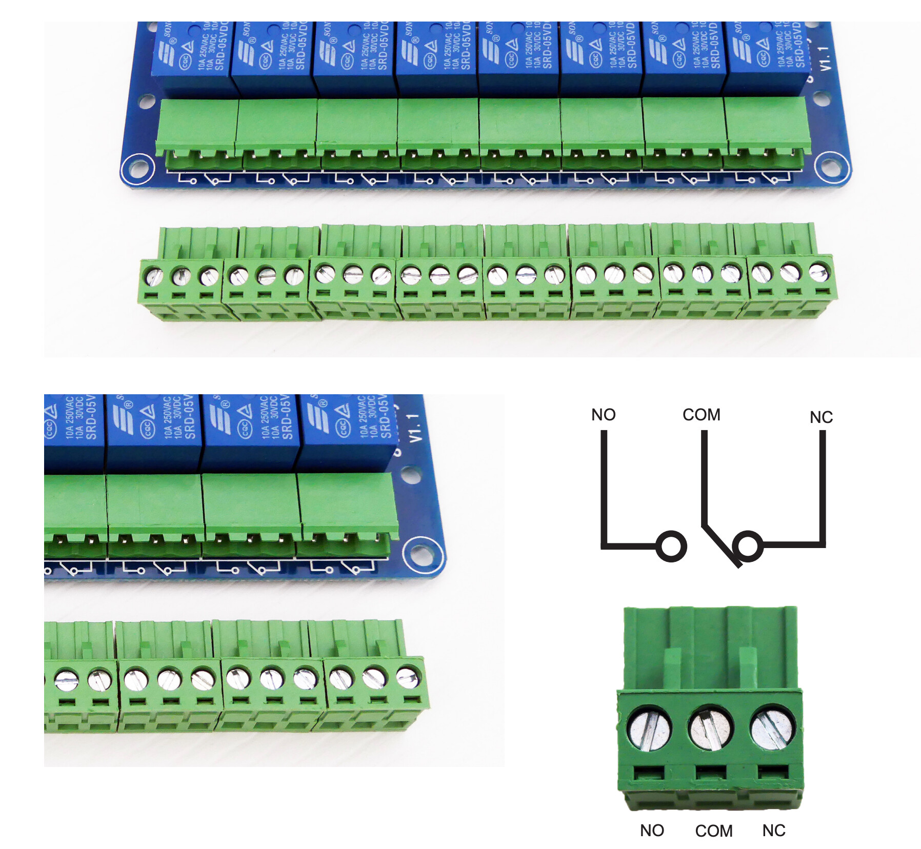

What is the model of the pin green pin connector so I can proper let wire the jumper cables on the board instead of just getting they to stay on by friction.
Are you talking about these connectors on the relay board:
You should have a set of 8 already on your relay board. If you’re missing some I can point you to where they are.
Please do not do “friction fit” wiring. That can cause a lot of problems.
Yes I am missing some of the 3 terminal connectors on the inter connect board and the 2 terminal connectors on the inter connect board. If I could at the very least just get a model or each I’ve ordered several different versions of moles connectors and they are all wrong so I’d appreciate some guidance. I’m not familiar with these cabinets.
