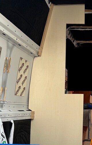

I cut irregular parts from 3/4” or 1/2” plywood with a jig saw. I use a scribing method and it takes several attempts to get it right. A couple corners might be square, but the rest could be very custom.
I’m hopeful my new AVID 4806 (coming in 4 weeks) can help me with this laborious task.

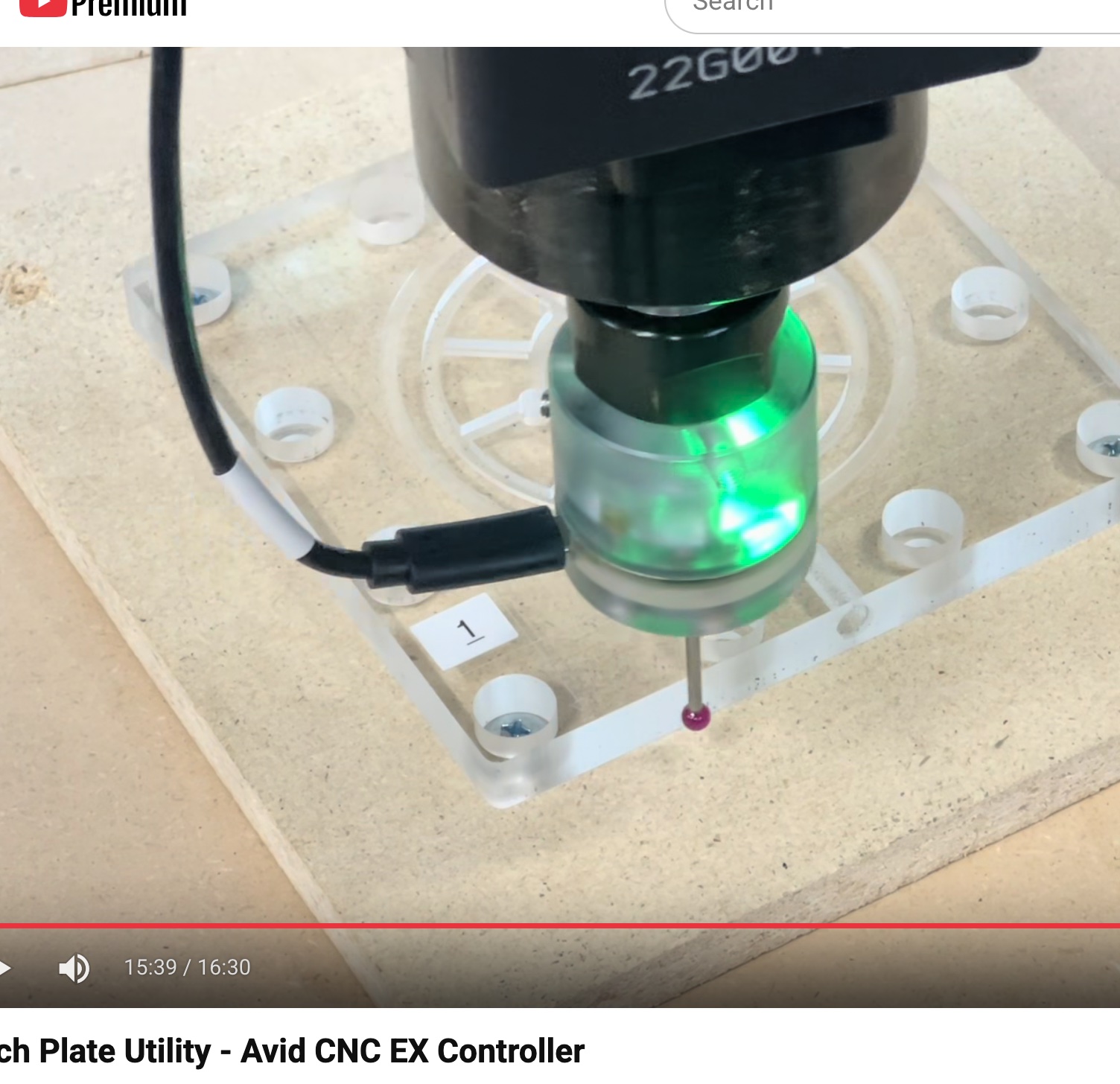

I saw this video that Eric did about the edge probe. Is there a way to use that to trace the part that I cut by hand?
How can I teach the software to cut a shape that I can’t draw? Note that most of these pieces are in excess of 2’ x 4’ so I can’t scan it.

You can use the digitizing feature in Centroid to copy parts like this. I believe the video is posted here somewhere… I’ll see if I can find it

This has some information about digitizing
https://www.centroidcnc.com/cnc_digitizing.html
You can use any probe for digitizing. In my experience it’s best suited for 2d shapes as it doesn’t take a ton of time.

Tracing a part like you showed in the first place is really not that hard… probing 2D parts with a probe is very reasonable to do.
I’ve done this a bunch of times, and what you’ll find is that you can get a good sense of the density of points that you need to probe…
For example… Big straight edge on your part? You probably only need 1-3 points on that, odd shaped curve? up the density of probing.
I’ve actually talked about and shown the workflow in this thread: Digitizing with cnc12?
There’s a great video in there of someone probing a knurled handle.

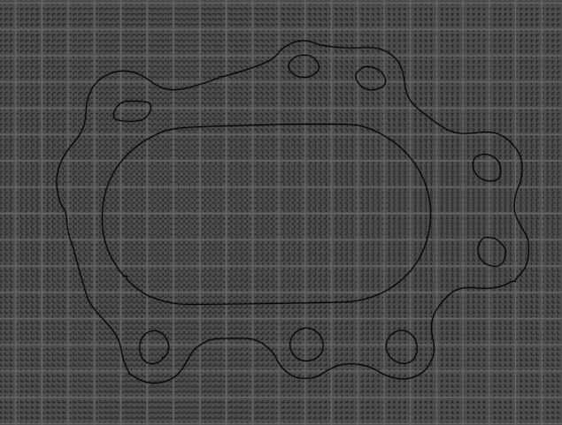

For probing 2D parts the workflow is even easier… after converting your points you just export them to DXF with G Code ripper and bring that into whatever CAM prorgram you want. From there just trace over the points and clean up anything and you can cut your part.

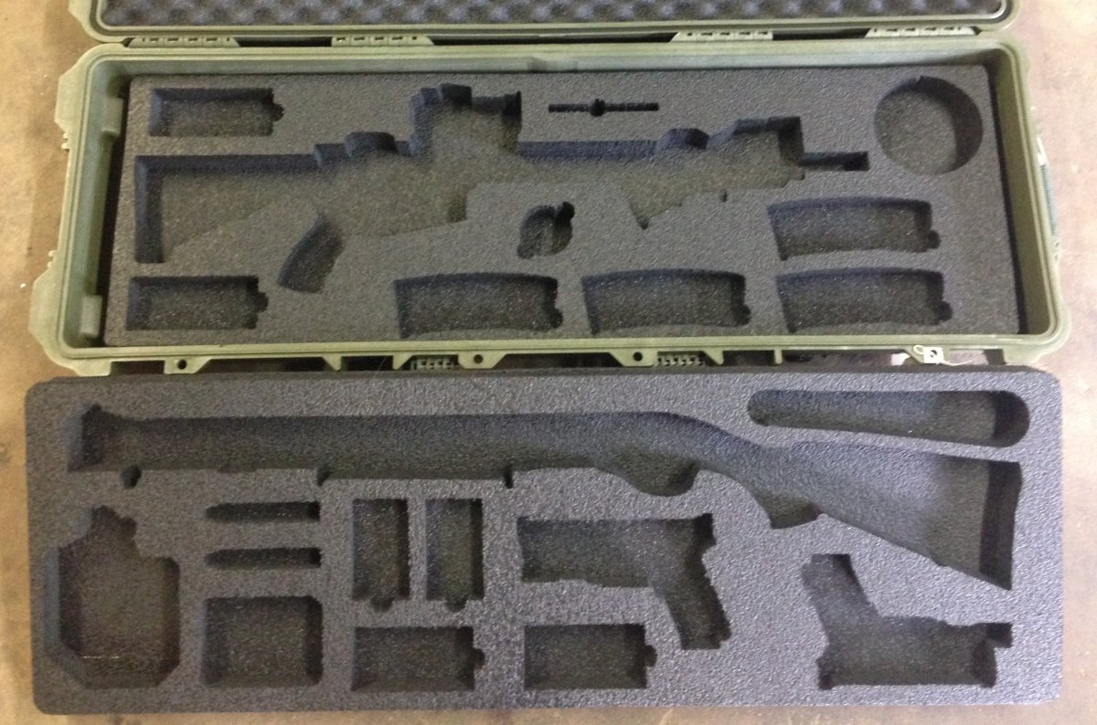

Every job that I have done over the last 10 years is for irregularly shaped items.
I trace the items on paper and digitize it using a board like this: https://logicgroup.com/GTCODigitizers.html
It produces a .dxf file and off we go.
