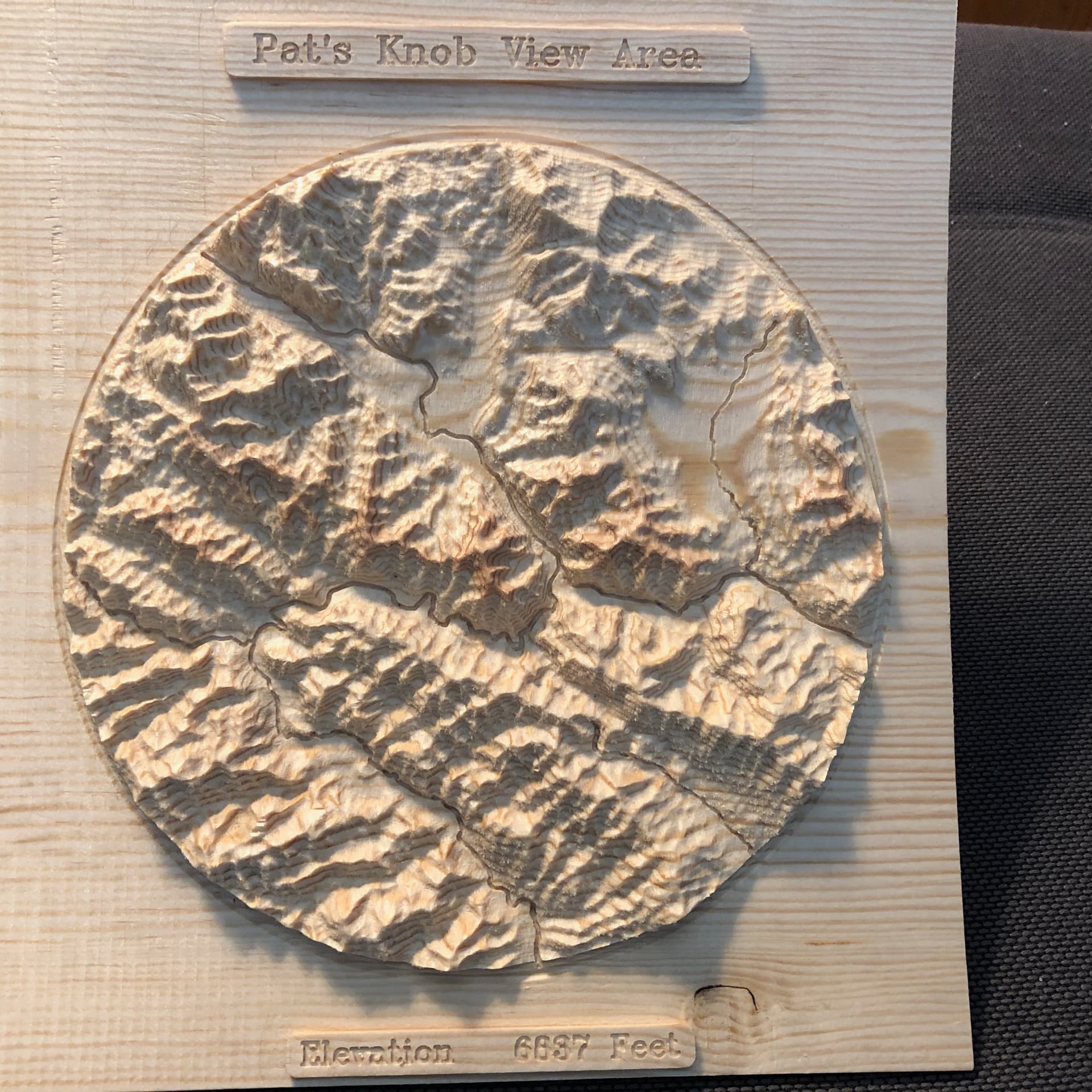

Here is the process I use:
  1. Start with a gray scale image, resolution depends on scale of carving, GOTOPO30 for large areas and STRM data for smaller areas. Data is usually from USGS
  2. Import into QGIS then produce a virtual image file to get rid of lines between tiles
  3. Use QGIS to clip the virtual image to a boundary, typically a state(s), county or polygon. I use the National Atlas data for clipping boundaries.
  4. Produce a STL file using QGIS
  5. Use VCarvePro to import STL file and produce the GCODE.
I have never had any problems with file size, some are over a million lines and run for hours. VCarvePro is a fabulous simulator.
Here are some examples.
Michigan carved in old growth tight grained spruce
Clark Fork and Flathead Rivers in Montana carved in Ponderosa pine
Western United States simulation in VCarvePro
