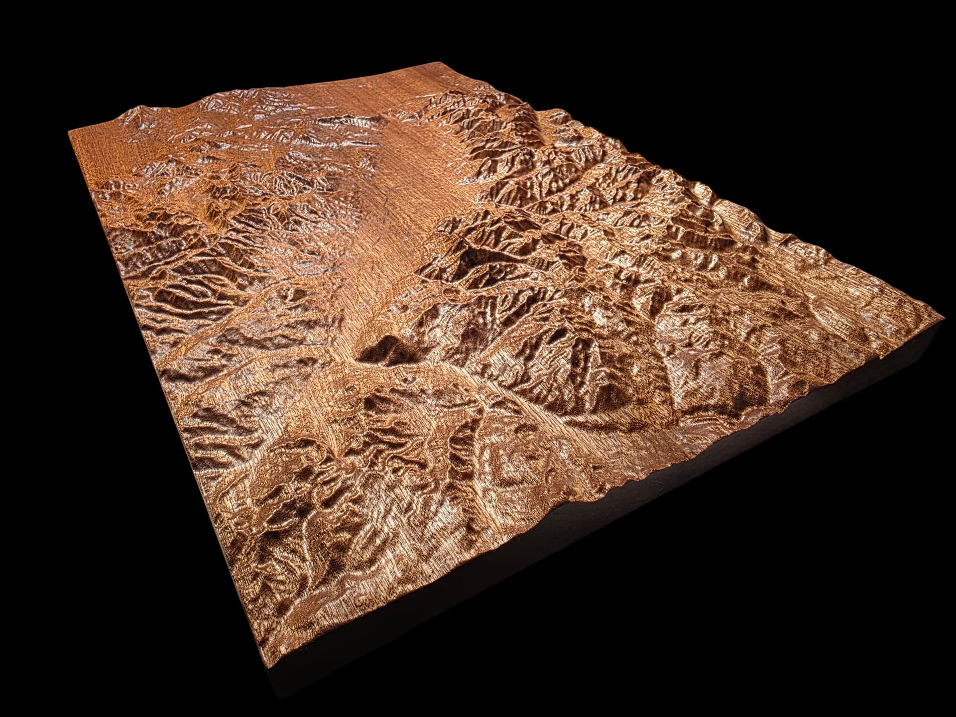

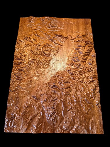

Paradise Valley MT Topo
1st attempt at a topographic carving. Project is 11” x 7.25” and was carved from Sapele. The finish pass took about 7 hours, but my step over was 4% diameter of a 1/8” tapered ballnose. Finish is Odies Oil.
I am wanting to do the entire state of Montana, but am hesitant to run my spindle (Hiteco 4hp) for upwards of 24 hours non-stop. Any thoughts, concerns?

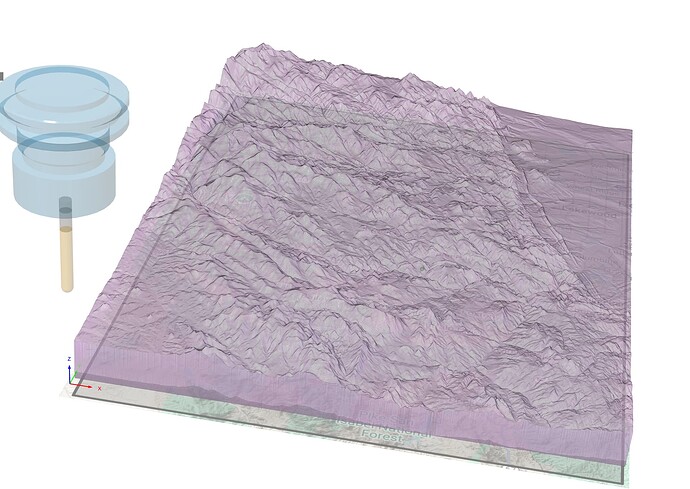

Using Fusion 360, I did a 3D Adaptive clearing pass that took around 1.5 hours, then a morphed spiral pass that took about 4 hours. That used a 1/4” ball nose running at 90 IPM (18k) with roughly a 5% stepover.
These were mostly defaults for my tool setup and I could have no doubt ran the morphed spiral path much faster. The 1/4” roundover provided plenty of detail and no sanding was required. The piece turned out great (was made out of cherry). I don’t have a picture of it, but here is the fusion 360 screenshot to give you an idea of the topo:

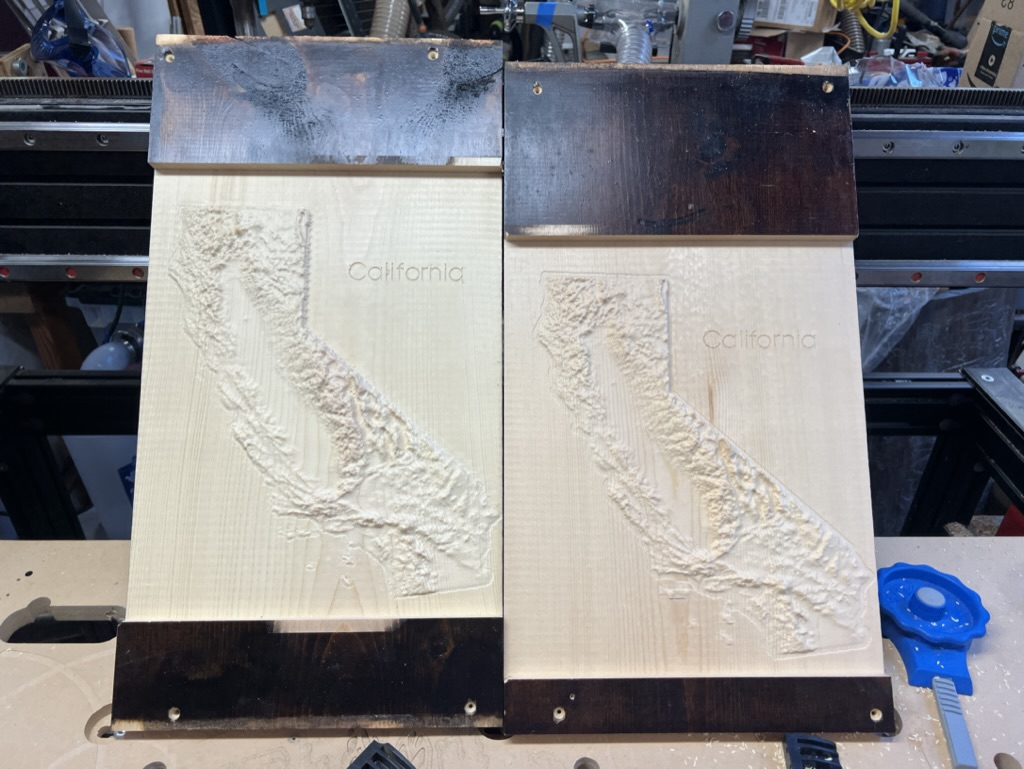

I use 5 percent, 10 percent and 15 percent offset depending on the terrain and have been happy with the larger offset. Try experimenting, it might save you some time plus try using a 1/4 ball nose.
Here is California using, I believe a 1/4 inch ball nose bit and 15 percent sideslip to give you an idea of results. Carved in 1 by 12 pine so will not be as smooth as in a hardwood. Used a 1/4 inch end mill for the clearing pass. Entire job was maybe 2 or 3 hours. DEM was GOTOPO30.
I usually run the ball nose at 200 or 250 inches per minute. Hope this information helps when you tackle the entire state of Montana. I will probably be doing Montana in the next few months, just need to decide how big a piece of wood to use, might do it in pine first, then a hardwood.
Nice! Got the topo from USGS as a DEM, modified it in QGIS and exported as STL and toolpaths in Vcarve Pro. The area covers Paradise Valley with Bozeman in the upper left, Livingston in the upper right, and Gardiner (Entrance to Yellowstone NP) at lower middle. The Z is exaggerated a bit (maybe 2x). I will probably stick with 5% step over. I do not want to have to sand the mountains.
