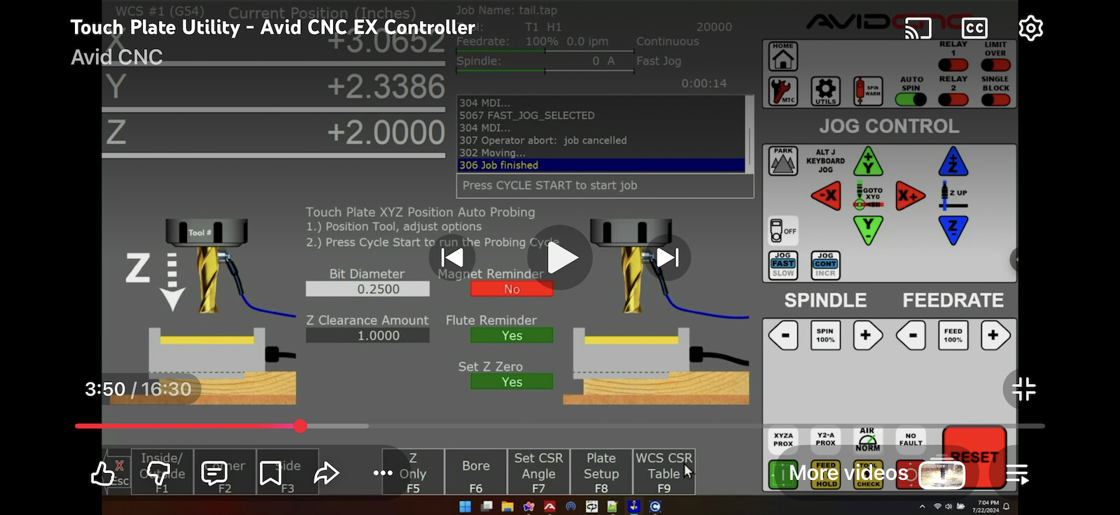

This is my first CNC and I have been struggling for 2 days to run a very simple job. I have been in touch with Avid Support team but have not heard back. I’m at a standstill until I can figure this out.
I have watched hours and hours of Eric’s videos (which are awesome), but I can’t find a “step by step” video where the pre-req steps to run a job are outlined. I’ve also been unable to find step by step instructions on the AVID website.
Would anyone be kind enough to list the steps you take before running a job? I’m running into Z and X axis limit errors, even after setting the machine limits (I’m sure I’m missing something).

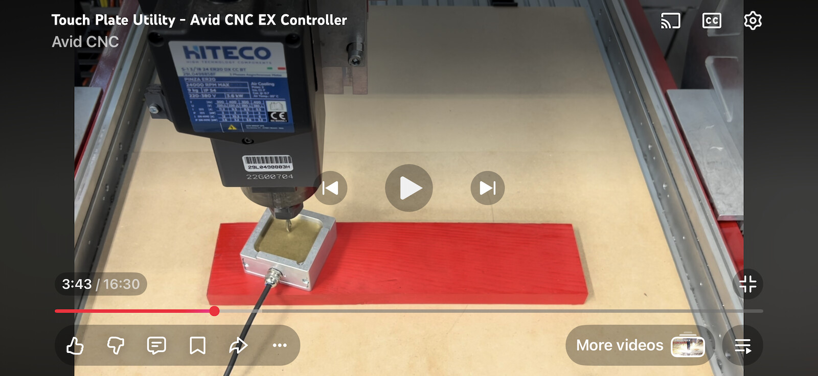

Also, could you please clarify… In this video, Erik says to follow the image in the software, but then when setting the z-zero, he doesn’t. The image shows the touch plate on the corner of the material, and the magnet on the tool bit, but he puts the touch plate directly on the material, and doesn’t use the magnet.
Could you please clarify which is correct and when do I need to use the magnet? I can’t find the documentation on this.
Sorry for the newbee questions. Hopeful there are easy answers! I think I’m on the cusp of “getting it”, I just need a little assistance. Thanks!
Tom
I can’t help with the rest because I’'m running linuxcnc instead of windows, but I can help here. ALWAYS use the magnet. Since your machine is metal, there’s a good chance it will conduct through the spindle, mount, gantry, frame, and metal box, and so seem like it’s working, but… it isn’t, and it will fail you at the worst possible time.

You don’t always need to use the magnet. You can test this on your spindle to see if it reads without the magnet in the touch plate utility. It never hurts to use the magnet, but in many machines you don’t have to. TEST FIRST.
As far as the steps, basically watch the touch plate utility video to learn out to zero your material (looks like you already have)
If you’re running into Z limit errors this video shows a deep dive into z zeroing: https://youtu.be/6G4Ljdou3qo?list=PLQ5pqs2eIFYSBcGqUyHqiKSsWoO7gr-iM
And if you haven’t already, watch this one: https://youtu.be/g3MMSJ8NxzQ
If you’re seeing XY limit errors that might mean your job is to big to fit on the table, or you have your XY zero not where you think it is.
