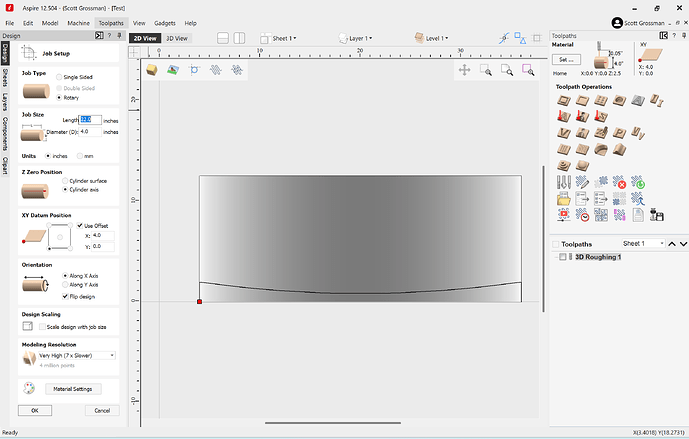

You can set up the job as a rotary job with the XY datum position using a 5 inch offset. It won’t start rounding until it’s past 5 inches of the pommel.
The rounding toolpath is really just a convenience to convert a square to a cylinder. Certainly a good way to start, but you could also use rotary roughing toolpaths to start the curved surfaces. In either case, you’d want to start the curved toolpaths 5 inches beyond the beginning of the pommel.
Thank you, I’ll give it a go. If anyone has a visual aid example that would be helpful.
This is a 32 inch curved section which starts four inches past the WCS X0. Notice that the curved section could be cut with a roughing toolpath which would be followed by a finishing toolpath.
