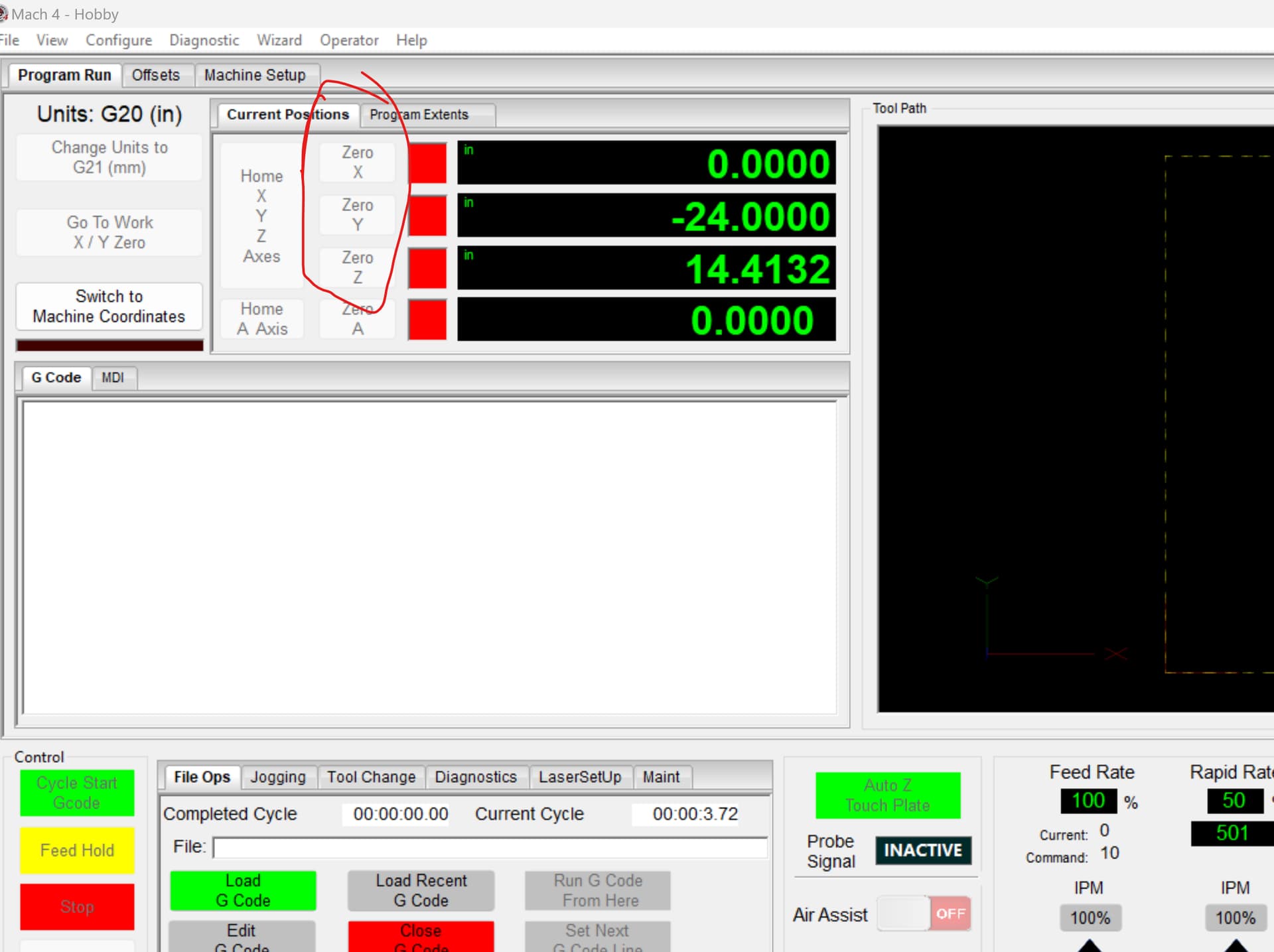

Hi, I have a project where the zero is in the center. How do I center the CNC on the center of my board. I know using the Auto-Zero tool works great on a corner but how do I set the zero in the center?
You can manually set zero on each of the axis by hitting the “zero x/y/z” buttons on mach4. Just jog the spindle to where you want zero to be and hit the zero x and zero y buttons.
Thanks. I though the solution would be simple.
