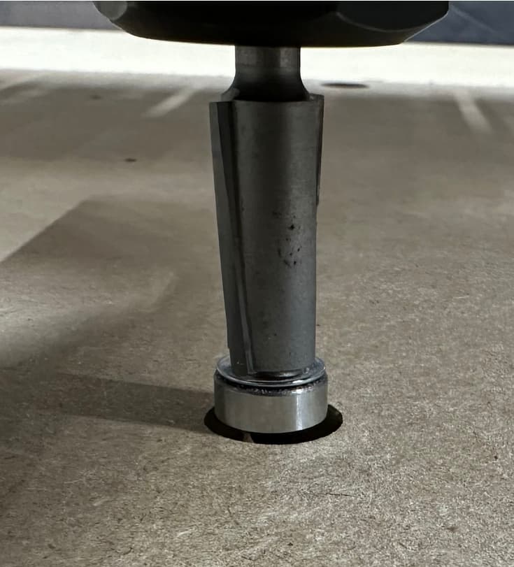

I work with veneered material the most and I went looking for a better way to remove those stubborn tabs without tearing up the precious veneer. Obviously a router table with a flush trim bit is perfectly fine, I just don’t own such a uni-tasker.
If you flip a router table over it looks a lot like a caveman’s CNC router, so I decided to use my 3D robot of death as a lobotomized stand-still appliance.
I bolt down a piece of MDF with a relief hole near the center, lower the spindle down to the right height for the tab/material thickness, and run 'er through. You may also like to add a support post to help guide material but I’ve found it got in the way of some curvy sections so I freehand it. Still have all eight fingers (thumbs don’t count, right?). Afterward, you can’t tell a tab was ever there, and it saves so much time compared to osc tool and endless sanding.
I chose a Whiteside Router Bits 2602 Down Shear Flush Trim Bit with 1/2-Inch Cutting Diameter and 1-Inch Cutting Length [Amazon]. If I were to choose again, I might opt for the 1/2" shank model 2605. I haven’t run into an issue with the 2602 1/4" shank, but I wouldn’t mind having twice the diameter chucked up in the spindle. The down shear action is important for eliminating tear-out. You want the cutter pulling down toward the bearing. Some brands advertise as down shear but the direction is reversed…or Internet product pictures are wonky…either way, this is the right combo. I run this at 9000rpm, which is quiet enough that I don’t need hearing protection, but for longer runs I typically do anyway.

You’ve created a pin router mode. I did something similar with a top-bearing up-cut bit. I like your idea of lowering the bit into a relief hole.
If someone didn’t have a bearing bit, they could bore a hole for a pin and then position a down-cut bit over the pin. Pop in the pin, command to the position, and you’re in tab trimming mode. Might work with a compression bit, too.

Not gonna lie, if I happen across an inexpensive table with reliable router lift I may spring for it. Fat chance. So this works really well for now.
