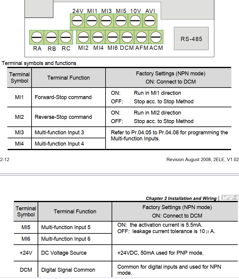

  1. The spindle I bought needed 24V in the M23 connector for the cooling fan. I ended up adding a 24V power supply to the din rail in the spindle control box. At least on my delta VFD I was able to get access to the signal for my spindle being on, and connect that to a relay to control the cooling fan. I also sent output of the relay along with 24V power to a separate control box where I had my pneumatics.
  2. In the pneumatic control box I added a relay to make sure the drawbar never released while the spindle was still on. I think this was recommended in the instructions, but it wasn’t super clear where to get the signal from.

How did you add the extra relay in to ensure the drawbar isn’t released? I noted in my directions that it would be good to do, but I didn’t write how to do it because I haven’t done it.
I was figuring the best way is to have the VFD control an interlock relay that is closed when the VFD is not spinning the spindle. However, my Automation Direct VFD only has one programmable output, and it is being used by the EX controller for “VFD is ready” state.

It sounds like we might have the same VFD. Mine also has just one output which seems to be used by the ex as well. It would have been great to use the zero motion signal.
What I did was use the 24V and DCM pins to power a 24 volt relay. Then I connected the M1 pin as the signal. The relay inside the VFD box both supplies 24V to my spindle’s fan when it is running, and connects to a different relay in the box with my pneumatics. That one break the connection to the drawbar solenoid when the spindle is running so hopefully I’ll avoid doing something stupid. I’m a little worried there is a window after the spindle is commanded to stop before it actually stops rotating, but as you mentioned there doesn’t appear to be a way to get a signal it is completely stopped.
